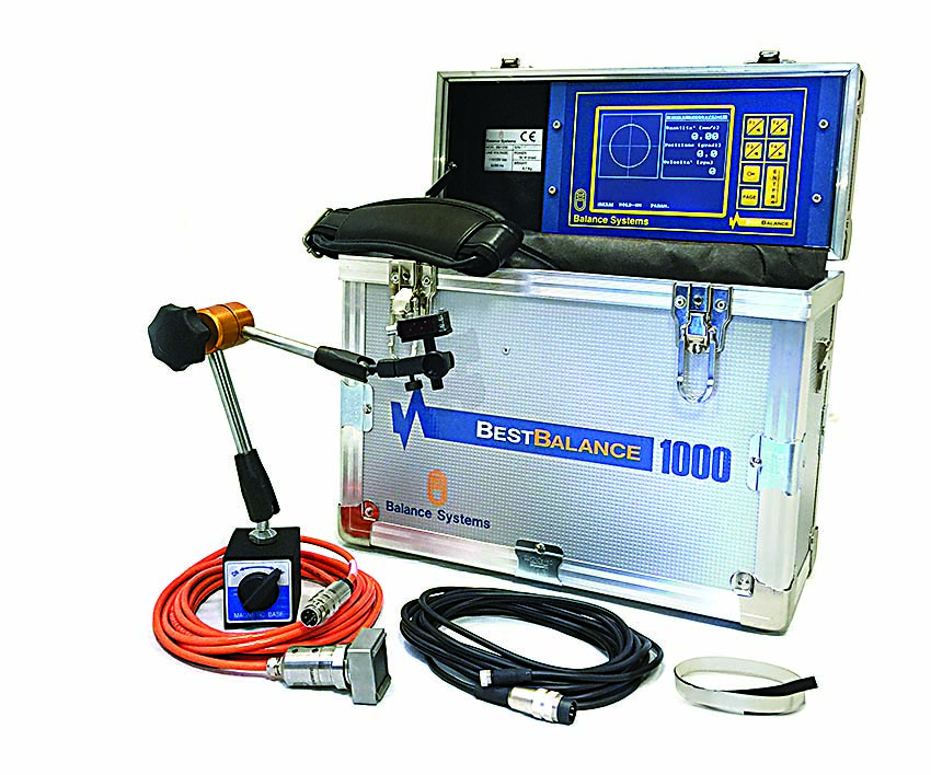

Tool balancing basics
The Best Balance 1000 is a portable device for measuring and correcting vibrations of rotating components due to imbalance. Image courtesy of Balance Systems

For field maintenance, D’Aless-andro recommends portable balancing equipment, such as the Best Balance 1000. The main benefit of this model is that a user does not need to remove a tool from a spindle and put the tool on the balancer. The balancing process can be performed directly on a machine tool. The same equipment also may be used to balance other types of spindles, including those on grinding machines.
