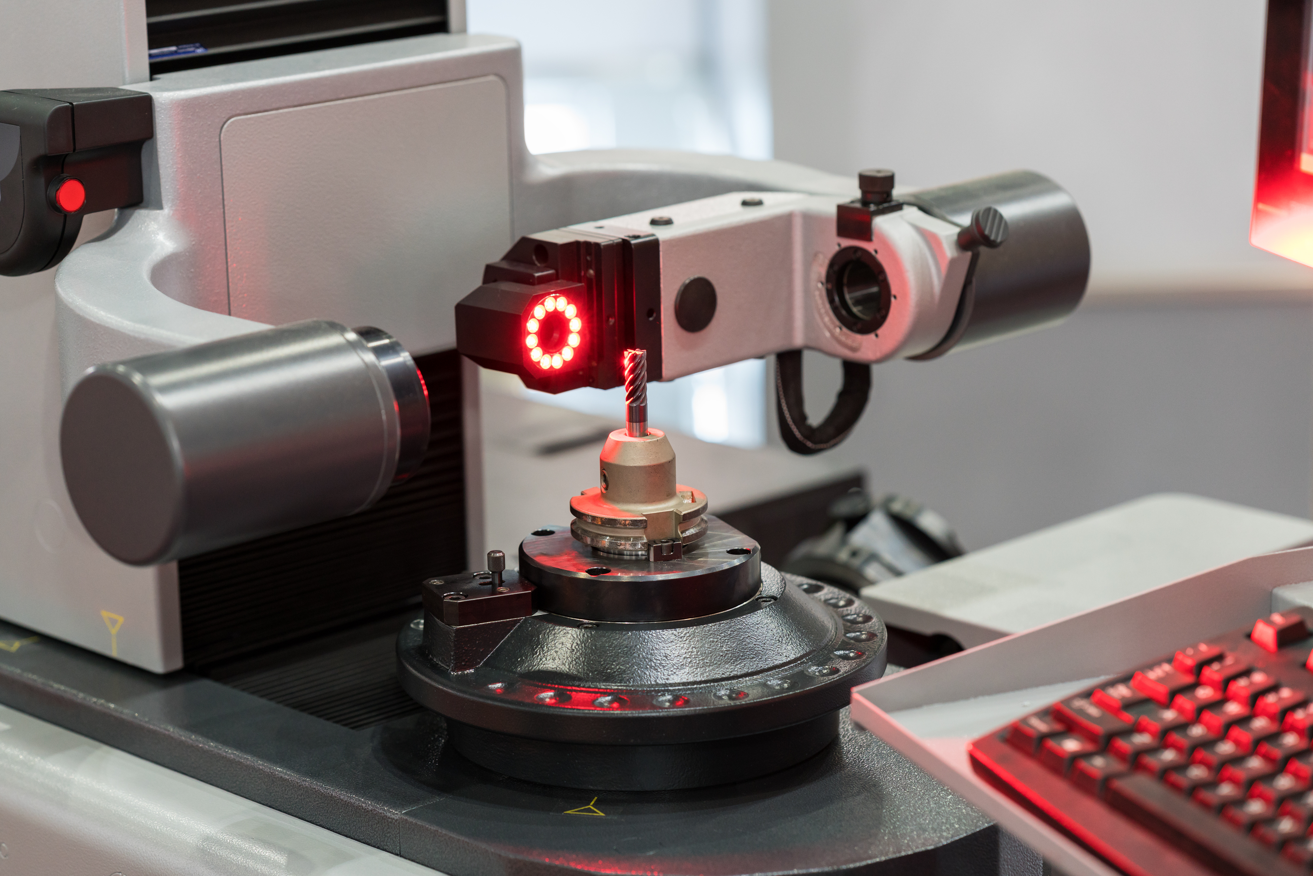

Adding tool setters to machines and utilizing automated functions are relatively inexpensive and much faster than manually setting tools.

Before discussing ideas, knowing the cost is necessary so solutions can be sized to fit a project. A small shop that has a few machines may find that costs associated with tool setting are small. There are a lot of simple, inexpensive solutions that a small shop with limited resources can employ. Adding tool setters to machines and utilizing automated functions are relatively inexpensive and much faster than manually setting tools. Keeping commonly used tools mounted in holders and storing data in a machine are very affordable. A shop can add one or two toolholders as cash resources permit until all the common tools are mounted and need only to be set when they are changed. A more expensive but more efficient alternative is to buy a good tool setter along with enough toolholders to allow machinists to set tools for the next job while a machine runs.
