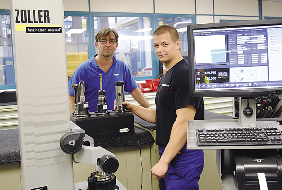

“We wanted a solution from a single source,” said Damian Sakwerda, a CAM programmer. “Because we had already been working with a Zoller presetter, we decided to purchase a new Zoller smile 600/CNC and invest in the Zoller Tool Management Solutions system.”

Rüdiger Hof (left) and Sergej Ponoma-Renko from Bombardier Transportation’s setting department preset tools with the Zoller smile 600/CNC presetter.

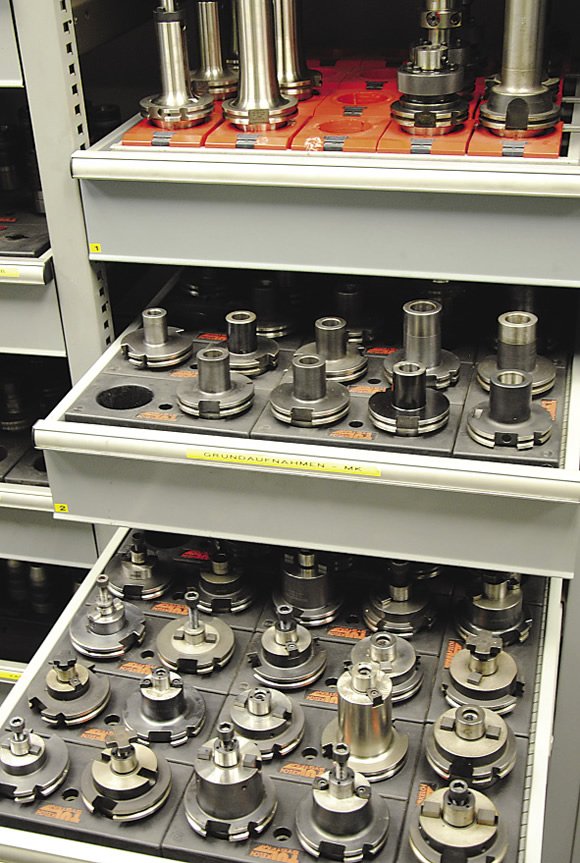

A selection of tools at Bombardier Transportation.
Bombardier Transportation has cut the time to tool and retool a machine because TMS knows which tools are already available on each machine. This allows the company to reduce the time to implement machining of a defined workpiece on a different machine tool from 4 to 5 hours to 2 to 3 hours.

Rüdiger Hof from the toolsetting department added, “We can work in a much more relaxed way because, thanks to the Zoller TMS, errors have pretty much stopped occurring.” CTE
