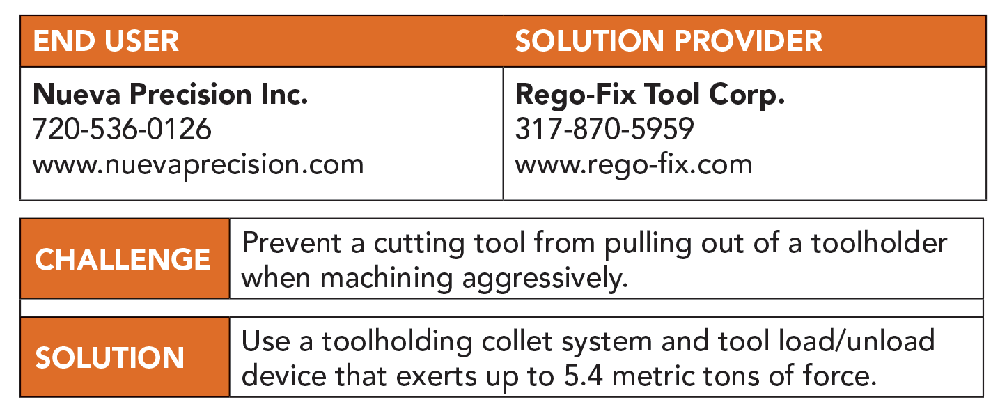

He decided to search for a better toolholding system at a major trade show, initially thinking that shrink-fit toolholders might be the best option. While investigating, he stumbled upon the powRgrip, also known as PG, toolholding collet system from Rego-Fix Tool Corp. in Whitestown, Indiana, and spent a considerable amount of time evaluating it. The PG system includes a holder, collet and tool load/unload device that generates 5.4 metric tons (6 tons) of force, relying on the interference between the holder and collet to generate the clamping force.
“Honestly, I did waver back and forth on which type of toolholding system to use,” Eddie said. “But in the end, I realized shrink-fit wasn’t a good fit for the shop.”

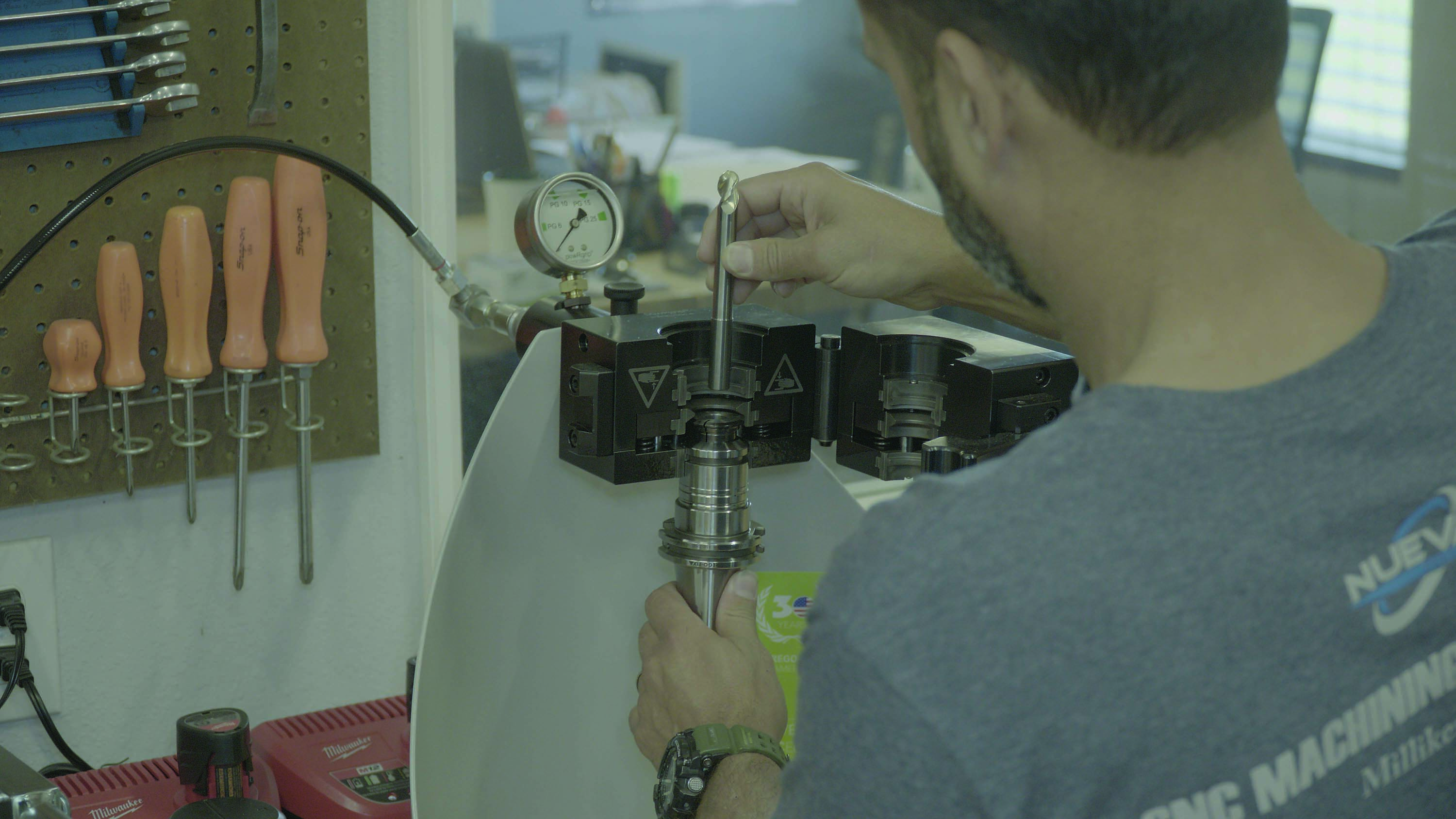

“What really drew me to the Rego-Fix system was just the simplicity of it,” Eddie said. “You just press the collet in and out.”
Rego-Fix Tool reports that it takes about 10 seconds to press in a tool or remove it from a holder.

Eddie Casanueva prepares to place a tool into a holder with the powRgrip toolholding collet system. Image courtesy of Rego-Fix Tool
