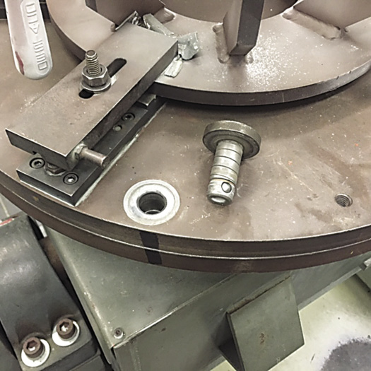

Dedicated workholding is sometimes required when a vise or chuck cannot be configured to efficiently hold a workpiece. Quick-change tools are available to shorten loading and setup times for dedicated fixtures, such as the Ball Lock mounting system from Jergens Inc., Cleveland. This system works by having a machine-mounted baseplate that can accept subplates with fixtures for holding parts. The baseplate has receivers that accept pins, which locate the subplate and provide substantial pull-down force to hold the subplate on the baseplate. Changeover for small fixtures is fast and accurate enough to eliminate the need for fixture alignment.

A Ball Lock system on a rotary table in a robotic cell has a pin that slips into the receiver and a setscrew that forces the balls outward to create downward force.

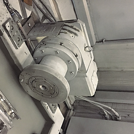

Another option is the Unilock from Schunk Inc., Morrisville, N.C. Unilock relies on a special receiver-and-pin system, where the receiver is mounted on the machine tool and the pin is mounted on the fixture or part. A Unilock pin has a special shape that allows it to be pulled into the receiver similar to how a toolholder is held in a machine spindle. Pins also have a taper, which interfaces with the receiver and provides repeatable fixture positioning.

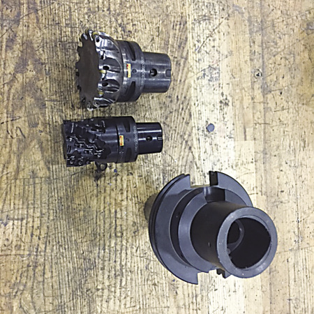

Capto-style tooling is probably the most common quick-change interface (see photo on page 42). Notice the tri-lobed tapered surface that interfaces with the tapered toolholder for the machining center spindle. Capto toolholders have a positional repeatability of 0.0004 “. This level of accuracy allows cutting tools to be replaced without setting them.
IMG_0220.tif
The Capto interface features a tri-lobed shape.
In addition, quick-change toolholders like Capto can improve efficiency on older machines that do not have automatic toolchangers. Older machines often have a spindle or turret that uses threaded hardware to hold cutting tools, which can make tool changes cumbersome and slow. A Capto holder enables a much faster tool change.
For example, turning a gas turbine rotor takes weeks. A single cutting pass can take days, requiring the tool to be changed in the middle of a cut. When our shop purchased large rotor lathes, we installed Capto interfaces on the tool slide. This setup allows the machinist to premeasure tools and have them ready to install while the machine is cutting, reducing the time needed to change the tool and returning to work as fast as possible. Without the Capto interface, we would be forced to reset the tool each time an insert is changed.
