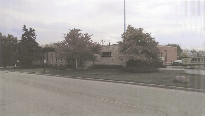

Nearly 3 decades later, in 1970, EDM specialist ABET Industries Corp. opened its doors in LaGrange Park, Ill., located west of Chicago.
ABET Engineering Corp. was established in 1970 (above) and occupies the same facility in LaGrange Park, Ill., today (below). Image above courtesy ABET Engineering. Image below courtesy E. Jones Thorne.
Historic images: ABET Engineering; All other images: E. Jones Thorne  ABET Engineering Corp. was established in 1970 and occupies the same facility in LaGrange Park, Ill., today.

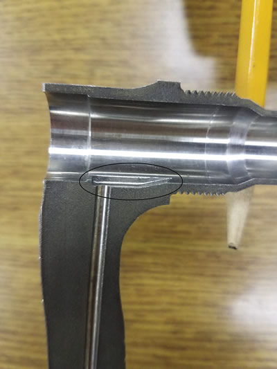

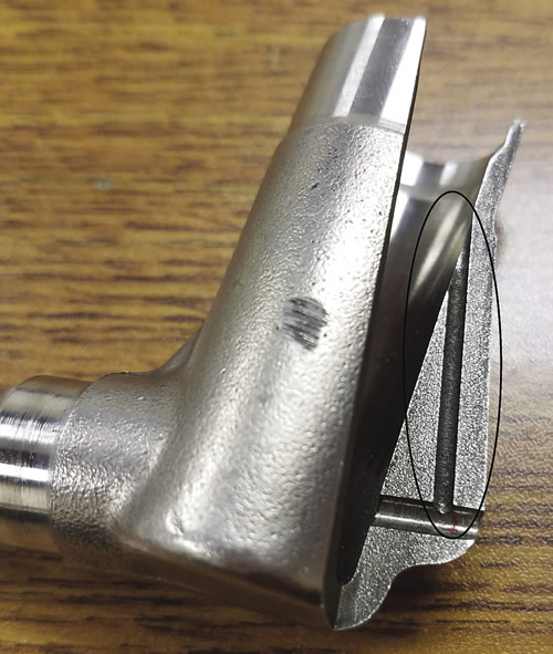

One advantage to sinker EDMing is its ability to create tiny, precise features. Both of these parts were received in a machined state; only the highlighted features were EDMed, but any imperfection in the profile would have led to scrapping the finished part.
One advantage to sinker EDMing is its ability to create tiny, precise features. Both of these parts were received in a machined state; only the highlighted features were EDMed, but any imperfection in the profile would have led to scrapping the finished part. Images courtesy E. Jones Thorne.

EDM is just as uniquely suited to small parts. It’s capable of holding tolerances of 0.0001" (2.54µm) and imparting surface finishes fine enough to eliminate lapping or grinding. According to Tomac, it’s not uncommon for a customer to provide a machined part that only needs a small, specific profile, but unless that profile is perfect, the customer will have to scrap an expensive part.

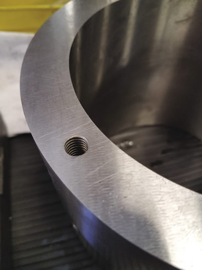

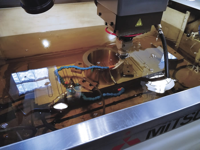

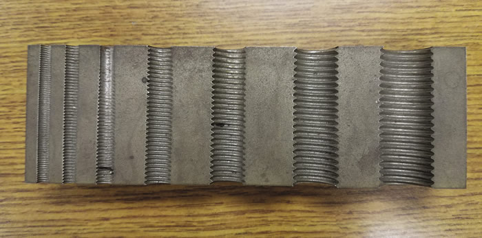

Sinker EDMing can also be used to thread holes.
Sinker EDMing can also be used to thread holes. Images courtesy E. Jones Thorne.
