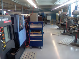

A fully equipped machine shop expedites learning at Symbol Job Training.

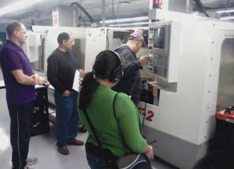

All this is great, but what about people who need basic machining education in addition to learning how to operate a CNC? Tom Peters, director of business operations for Symbol Job Training Inc., Skokie, Ill., has the answer.
“We have a 4-month program, half CNC mill and half CNC lathe, and offer intensive, rigorous training with lots of hands-on work,” he said. “Simulators are great, but they can never replace making real chips. We’re geared toward first-time job seekers and workers new to the industry, but a lot of shops send their employees our way and we also retrain unemployed workers looking to move into manufacturing.”
