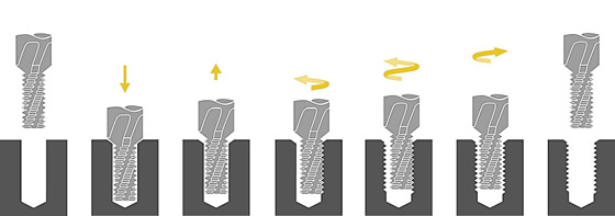

Tapping
Tapping is the most frequently performed process—estimated at 90 percent—for producing internal threads. The process involves applying a tap tool to cut the workpiece material in the helical configuration required for the threaded hole. The cutting tool must be designed specifically for each thread size and thread style and be fed at a specific feed rate to coincide with thread pitch.
The direction of the feed is only along the Z-axis, which makes programming relatively easy. But, some tool variations should be considered, including number of flutes, chamfer length, tolerance classification, rake angle, clearance angle, flute helix angle and shank standard (the German standards organization DIN or ANSI, for example). Therefore, it can be difficult to find the optimal design for a specific application.

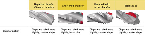

Controlling chips is the biggest challenge, particularly in blind-holes. To control them, users must select the correct tap design. This is why most tap manufacturers offer a large selection of different styles of taps and tap geometries.

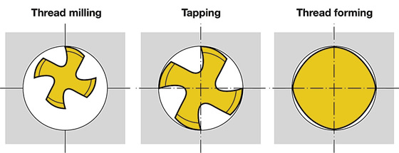

There is less variation among thread formers than cutting taps, which must control chips. Compared to taps, thread formers also have a much larger core diameter, which strengthens the tool.
In the event of a broken tool, a thread former is equally difficult to remove from a hole as a tap, but it is much less likely to break in the first place because of the larger core diameter. However, the range of applications and types of materials and sizes of threads that can be formed is much more limited compared to tapping. Some part designers, and even entire industries, include callouts on their manufacturing prints that prohibit thread forming a part.
This is because thread forming leaves a small gap at the tip of the thread form, sometimes called a “fish mouth” for the way it looks. For example, the medical and food industries do not allow thread forming because this small space can be an area where bacteria grow and is not easily cleaned or sterilized. However, the gap has no impact on thread quality.
Thread milling is the most versatile of the three processes. Only the shape and pitch of the thread is built into the tool, so a thread mill can cut any thread size—as long as the style and pitch is the same. For example, the same tool can mill a 1 “-8-dia. and a 1½ “-8-dia. UN-style thread. Small adjustments can be made to the thread size as well to ensure a certain tolerance specification is met or to compensate for tool wear to maximize tool life.
While the core diameter of a thread mill is smaller than a tap or thread former, the thread milling process does not require a tool with as much strength. With the tool diameter being approximately 70 to 80 percent of the thread diameter, the tool engages much less of the part and less torque is exerted on the tool itself. However, in the event of a broken tool, the smaller diameter also allows the tool to easily be extracted from the part, and the machining process can continue after installing a new thread mill.

Taps require the correct design for the application to effectively control chips.
