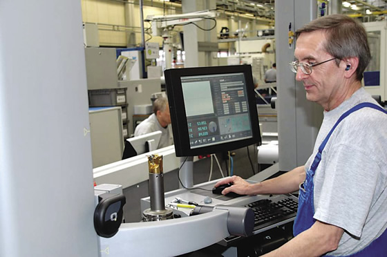

Tool presetting is standardized at Trumpf and directly linked via an interface to the TDM tool data management system.
