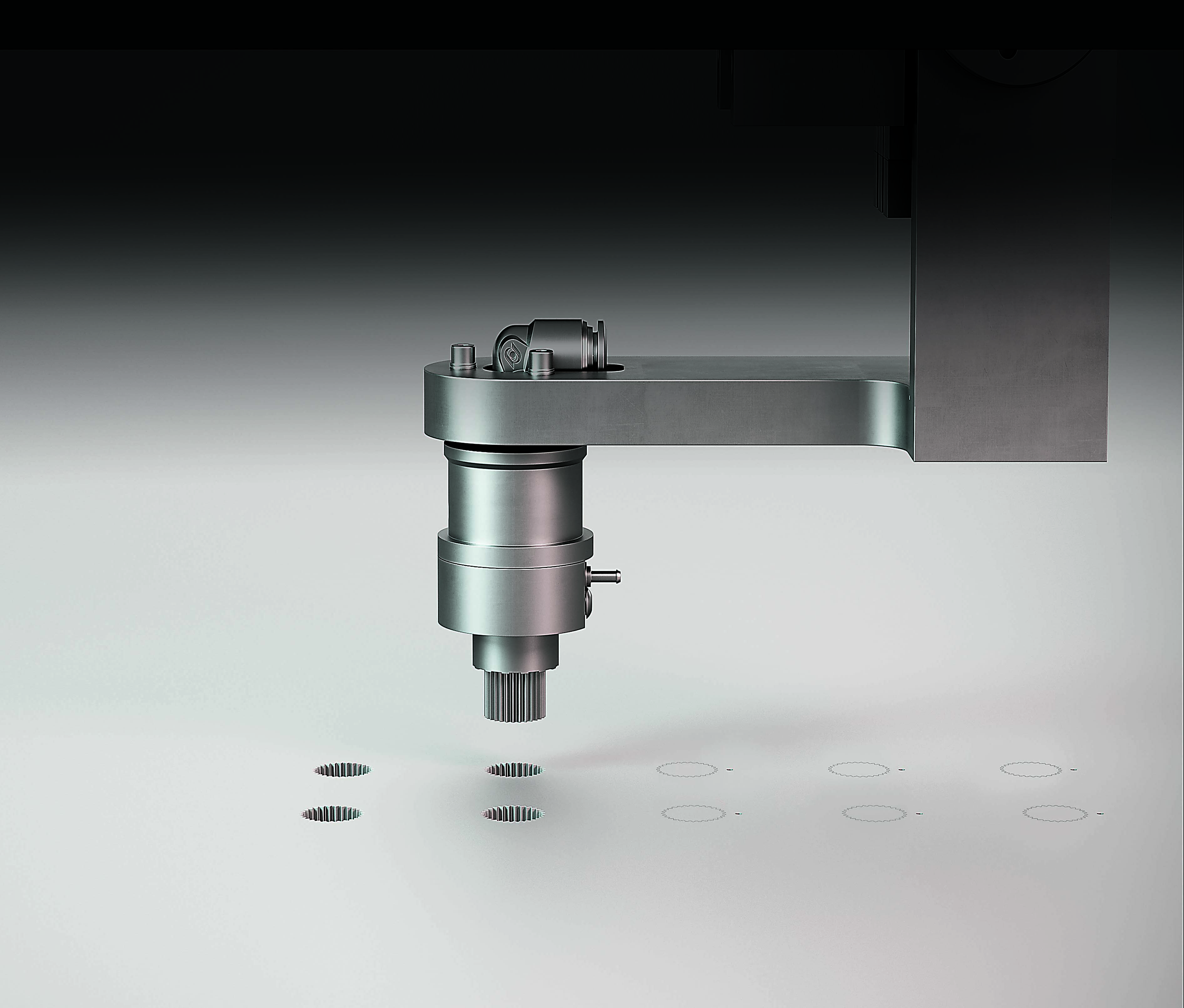

The ASM system uses compressed air to lift and remove just over a ½-lb. slug. Photo credit: GF Machining Solutions
GF Machining Solutions' ASM system uses compressed air to lift and remove just over a ½-lb. slug, which then is deposited into a basket at the side of the machine. Image courtesy of GF Machining Solutions

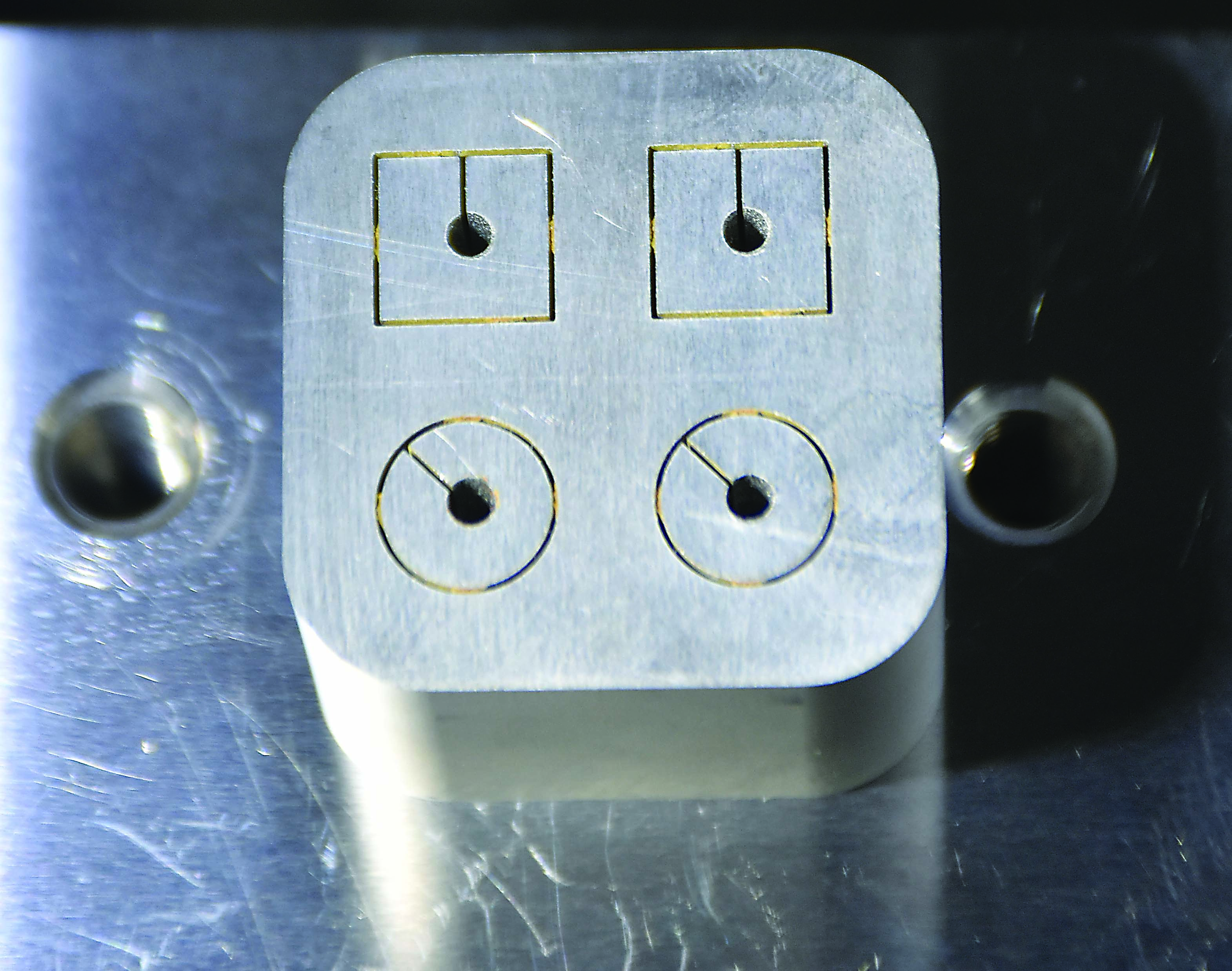

Steve Raucci, EDM product manager at Methods Machine Tools Inc., Sudbury, Massachusetts, offers a solution. He said the Core Stitch function on FANUC RoboCut α-CiB series wire EDMs retains slugs in the workpiece via a reverse discharge "brass adhesion" process, leaving small islands of soft material that hold slugs in place. After roughing, a few light taps with a plastic or brass hammer are enough to separate a slug, whereupon the operator can return the workpiece to the wire EDM for final machining if necessary.
A hammer helps achieve lights-out machining because, for starters, Core Stitch eliminates the need to stop a machine and apply electrically conductive glue or magnets to hold slugs, automating what was once a manual function. As Raucci explained, the tapping function itself also can be automated.
"We have an aerospace customer that's using a FANUC robot as part of a machining cell," he said. "The robot removes a jet engine component from the EDM and sets it on a slug removal station. It then exchanges its grippers for a brass punch, knocks out the slugs and places the part back into the machine for a final skim pass."

GF Machining Solutions LLC, Lincolnshire, Illinois, takes a different approach to wire EDM slug management. EDM Product Manager Eric Ostini said the company's AgieCharmilles Cut P series wire EDMs can be equipped with an automated slug management mechanism that uses a Venturi-style vacuum to basically suck slugs out of a workpiece.
FANUC America's Core Stitch function uses a reverse discharge process to retain slugs in the workpiece. They then can be removed with a few light taps from a hammer. Image courtesy of Methods Machine Tools.
"As the slug breaks free, it's supported by the lower head while the upper head lifts up and out of the way, allowing the attached ASM mechanism to move into position," he said. "The ASM uses compressed air to generate enough suction to lift and remove just over a ½-lb. slug, which is then deposited into a basket at the side of the machine. The upper head then returns to its previous position and either finishes the cavity or moves on to the next one, all completely lights out."

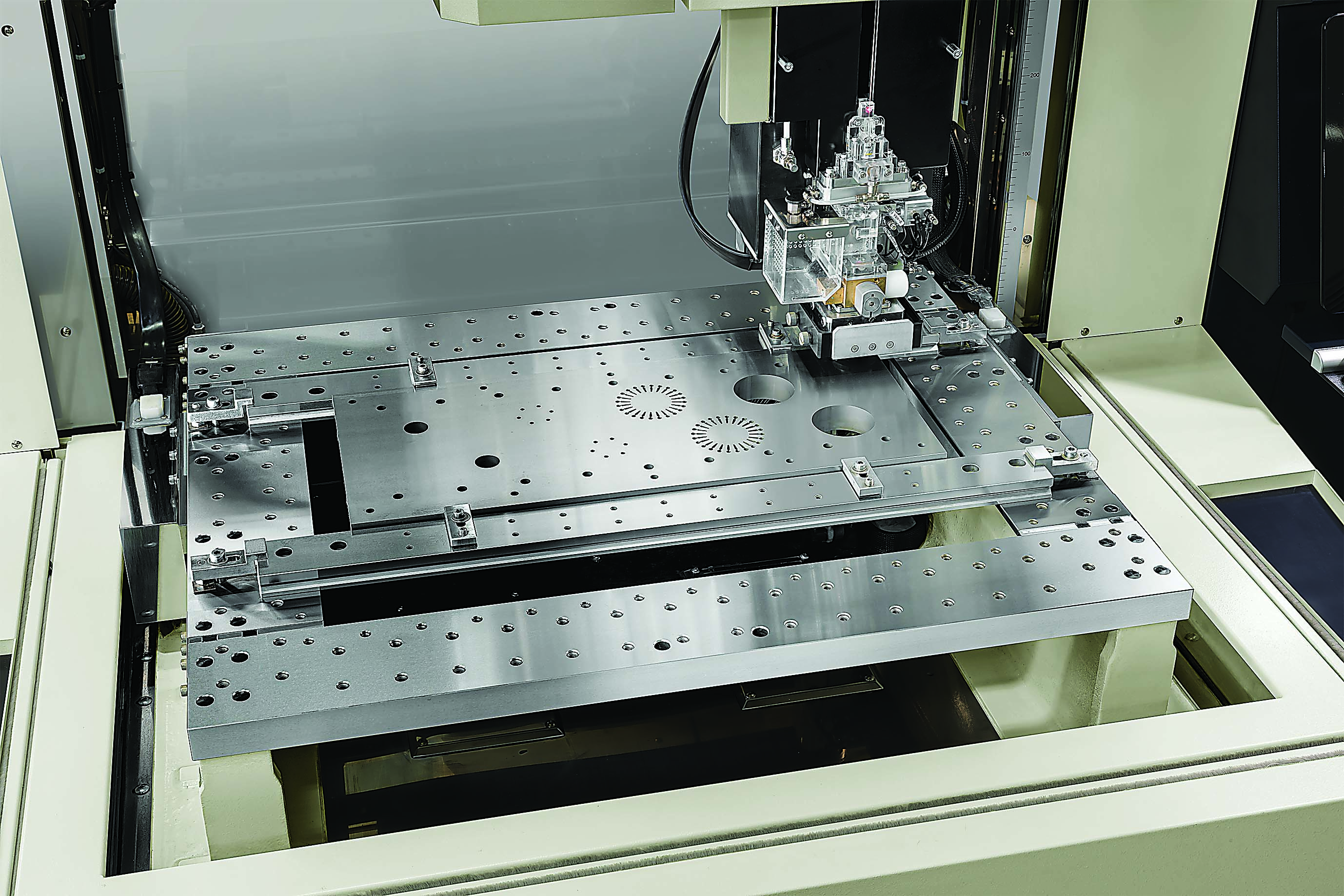

Makino's UP6 Heat wire EDM boasts 1μm precision across its entire 25.6
Makino's UP6 Heat wire EDM boasts 1μm precision across its entire 25.6"×18.5" working area. Image courtesy of Makino
Makino Inc., Mason, Ohio, is another wire EDM builder that recognizes the need for efficient, predictable lights-out machining. Brian Pfluger, EDM product line manager, noted that his equipment easily checks the dependable threading box thanks to a jetless threading system, which is reportedly able to thread through 4" of kerf with 100% reliability. He also said smaller slugs are manageable with Makino's dual-pump, independently programmable flushing system. Yet he's quick to point out that shops must have several other critical functions in place before turning out the lights.
To achieve no-fail remote monitoring and data collection, wire EDMs should have hard-wired network connections, not wireless. Pfluger said this will avoid the "electronic hell" created by EDM spark generators. Highly accurate, repeatable, automation-ready workholding also is needed. But it's the accuracy of the machine tool that he said is the main ingredient for predictable unattended EDMing.
"An increasing number of shops are asking us about automation, but my response is that a high-quality, highly accurate machine tool must be in place first," he said. "This means a machine with the requisite mass and thermal stability for round-the-clock operations. It should have positioning and feedback systems suitable for the parts being produced. And just as important are consistent, reliable processes. Automating inefficient or unpredictable ones will lead to poor results."
More Accurate, No Recast
One example of this is Makino's UP6 Heat. Though designed with progressive stamping die manufacturers in mind, the wire EDM's 1μm precision across its entire 25.6"×18.5" working area should be of interest to anyone producing extremely accurate parts in an unattended fashion.
Makino also offers the HyperDrive system, which helps improve straightness and accuracy, particularly in small part details, Pfluger said.

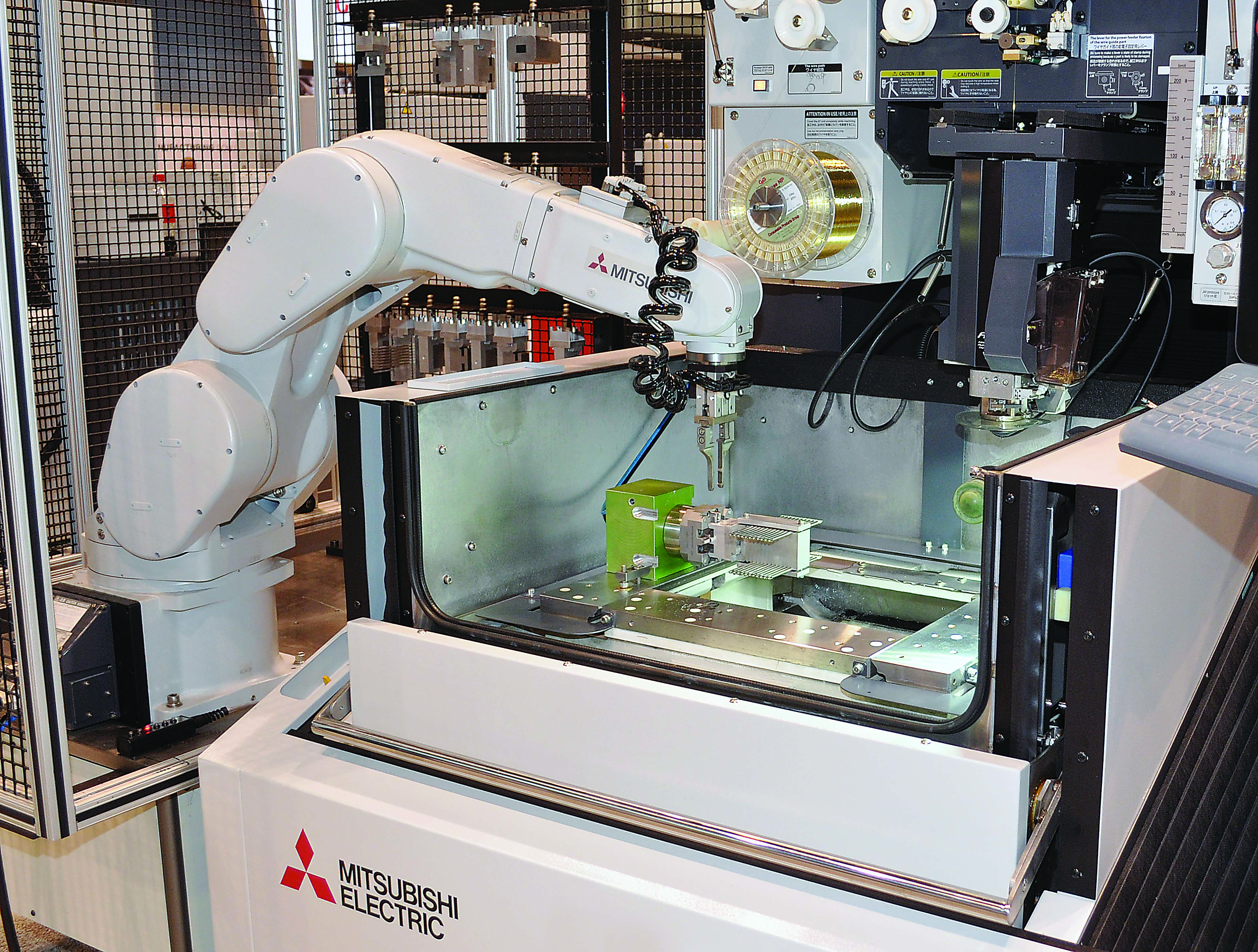

Robotic part handling is increasingly popular with job shops and others seeking to automate wire EDM processes. Image courtesy of MC Machinery Systems.

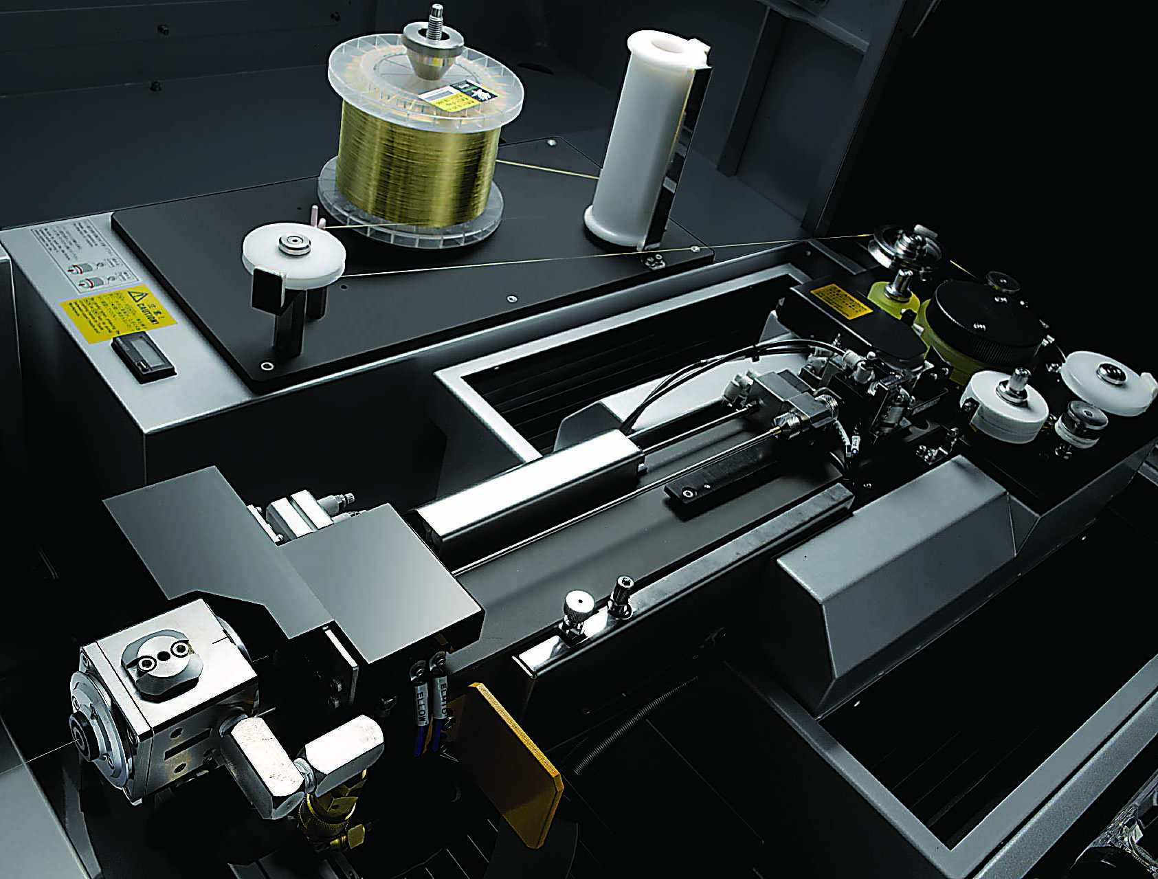

On the automation side, Sodick's Super Jet AWT high-speed threading and wire tip disposal units
reduce operator intervention.

Mike Bystrek, EDM applications and national wire EDM product manager at MC Machinery Systems Inc., Elk Grove Village, Illinois, agreed, saying the company's MV2400-ST Advance Type wire EDM is an excellent example of state-of-the-art EDM technology.
"The new M800 control platform enables us to offer a pedestal option, providing easy mobility and access to any position near the machine for flexibility in automation layouts or safety purposes," he said. "It also offers enhanced setup and maintenance functions that greatly reduce downtime, as well as remote management features for unattended machining."
No-fail wire threading is a prerequisite to any lights-out wire EDM operation. Image courtesy of Sodick.
