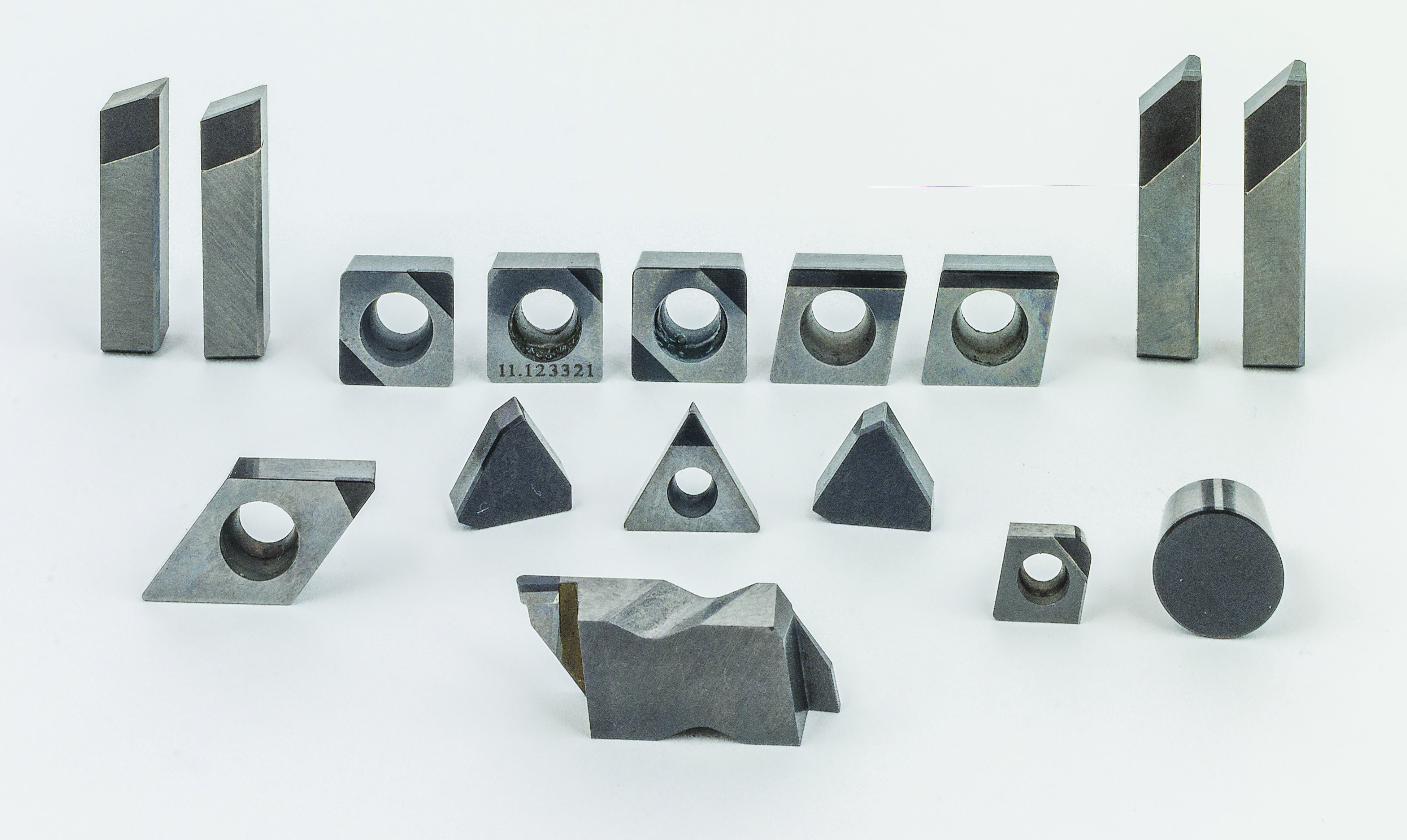

An alternative to ceramics and diamond, cubic boron nitride is the second-hardest material, and CBN tools of many grades have been developed for hard turning applications like transmission shafts, constant-velocity joints and toolholders. These inserts are used to finish-turn hard materials and produce fine finishes and tight tolerances, replacing grinding, which takes longer and costs more.
Chips entangling on workpieces or piling up at the bottom of machine tools can be prevented with the HP-style chipbreaker on the BXA10 range of coated CBN-grade inserts.  Image courtesy of Tungaloy America

Many CBN grades are available and often are designed for continuous-cut steel, heavily interrupted steel or moderately interrupted steel. Once a grade is selected, Coomer said choosing the right edge preparation and hone for the insert can minimize tool wear, lighten tool pressure, improve crater wear resistance and help a tool last longer.
“To protect the cutting edge,” he said, “we can vary the angle coming off the top of the insert anywhere from 10 degrees to about 35 degrees down from the horizontal to direct the cutting forces into the tool and away from the edge.”
GWS Tool Group’s custom high-performance ISO inserts with various tip options, including single tip, double tip, full top and special, can accommodate any hard turning application.  Image courtesy ofGWS Tool Group
It’s important to match the combination of the CBN grade and the edge preparation to the application, said Brian Wilshire, technical center manager for Kyocera Precision Tools Inc. in Hendersonville, North Carolina.
“There’s a fine balance you walk to pick a large enough edge preparation so that you get standard wear and no chipping,” he said. “But if you pick too large an edge preparation, it’s not going to last as long. You can consider it almost pre-worn because you’re grinding a portion of the cutting edge away to strengthen it.”

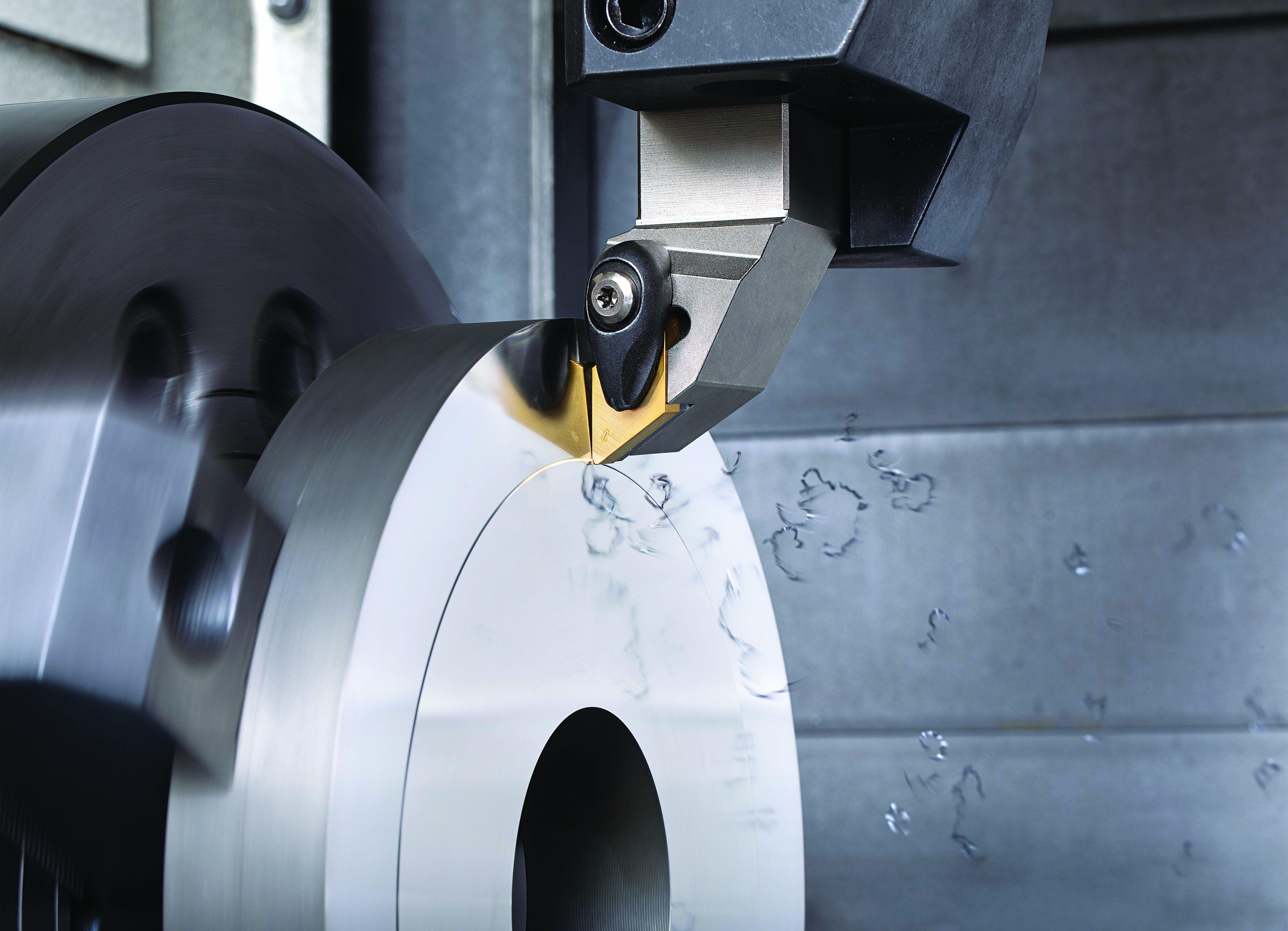

In general, chip control is less of an issue with hard turning due to high temperatures that cause ribbons of bright red, molten steel to flow off workpieces. Coomer said chips from hard materials are so brittle that they tend to crumble in one’s hand, so CBN inserts for hard turning don’t often come with chipbreakers.
However, even during hard turning, there are cases when chips may wad up and create issues with fixturing, workholding or surface finish — and harm tool life as well.
The KBN05M indexable insert works for high-speed finishing, as well as interrupted machining of hardened steel. Image courtesy Kyocera Precision Tools
“For example,” Coomer said, “when you’re hard turning internal bores, even though the chips may be free flowing, you might get into some bird nesting issues where chipbreakers might help.”

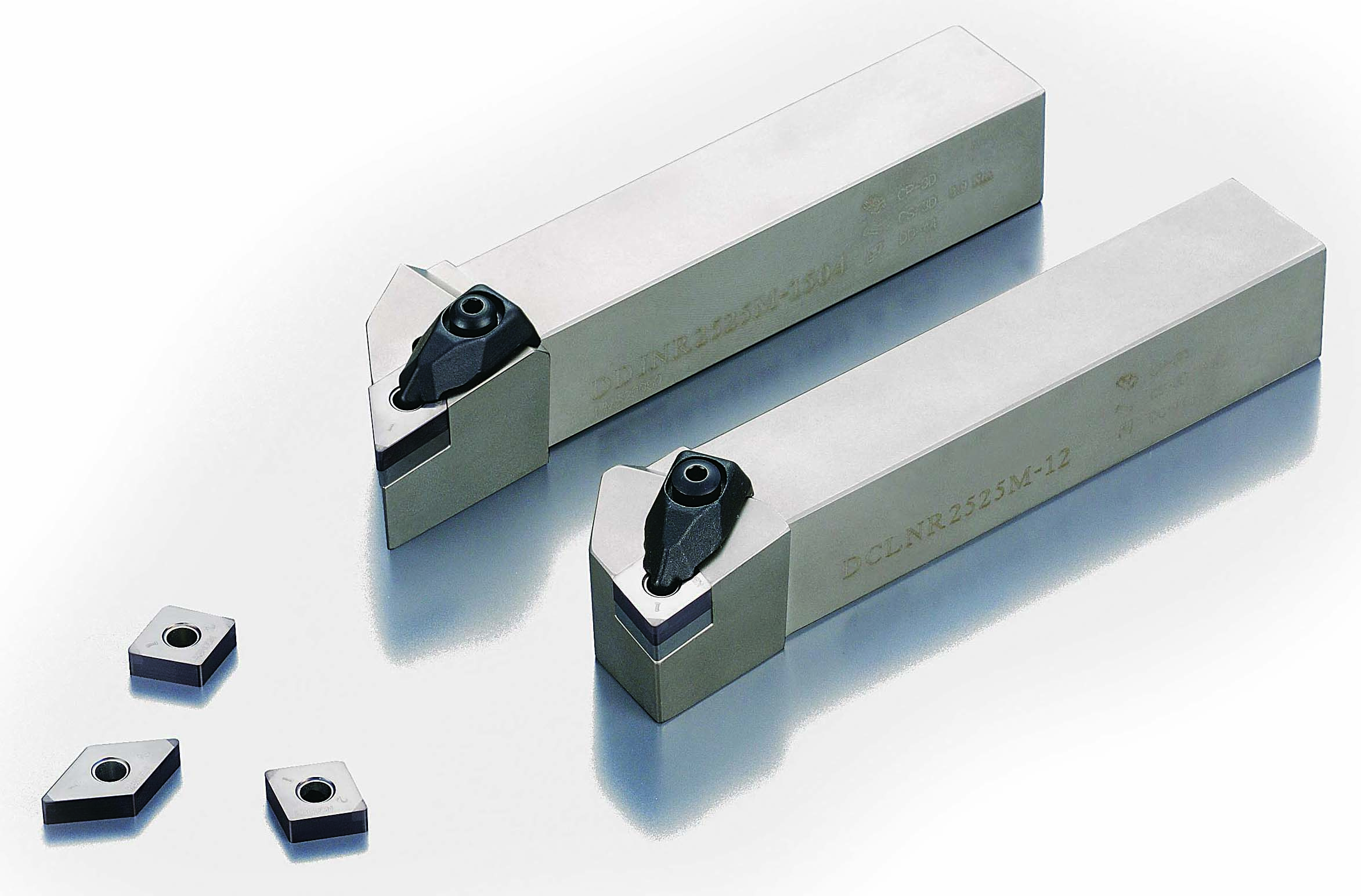

“If the size of the workpiece you’re turning is 1.25" (31.75 mm) or greater, I prefer using an 80-degree rhombic insert with a 32nd nose radius, which is the most common type of CBN insert,” he said. “As the diameter gets smaller, you want to transition into a screw-down positive insert with a front relief angle because it’s more important to be on centerline on smaller components than it is larger components. You’ll be able to hold size and finish better.”
Sawicki said good starting parameters for hard turning alloy and tool steels include:
  • 122 m/min. (400 sfm)
  • 0.1016 mm (0.004 ipr) feed rate
  • 0.1016 mm to 0.254 mm (0.01") per side depth of cut
“You’re safe 99.5% of the time running those operating parameters in any hard turning application for most materials above 50 Rockwell C hardness,” he said. “If you’re closer to 50 Rockwell C, start with 500 sfm (152 m/min.). And if you’re hard turning D2 tool steel, start at 300 sfm (91 m/min.) or 350 sfm (107 m/min.).”
