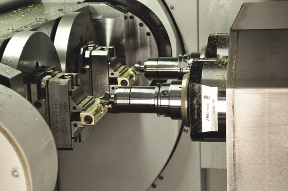

Form%20tool%20cuts%20big%20radius%20DSC_0198.tif
On an SW twin-spindle machine, two 0.450″-radius form tools round the corners of each slide in one pass. Image courtesy E. Sinkora.

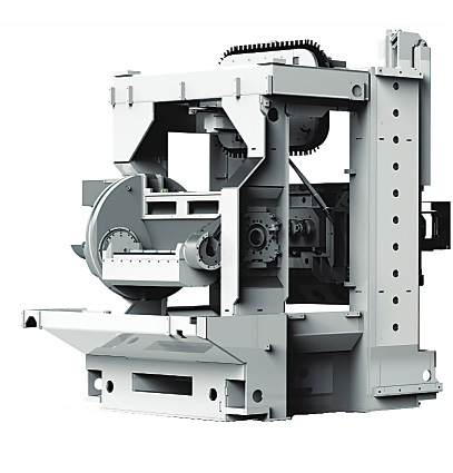

SW machines are distinguished by their unique monobloc casting, which supports the spindle and worktable from six sides, like a cube (SW’s trade name is QUBE). SW says the patented design provides 12 times the machining stability and rigidity of a typical C-frame design. The machines also gang multiple spindles in a row to simultaneously tackle up to four workpieces.
SW%20monobloc%20plus%20double%20drum%20table%20etc%20cut%20out.tif
The SW “QUBE” monobloc supports the work area from six sides, which SW says gives it 12 times the stability and rigidity of a typical C-frame design. Image courtesy SW North America.

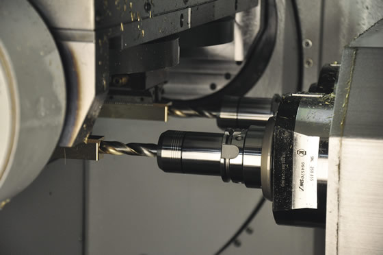

Drilling%20the%20barrel%20holes%20DSC_0144.tif
The 16mm barrel hole on two pistol slides are simultaneously drilled on an SW 5-axis, dual-spindle machine. Image courtesy E. Sinkora.

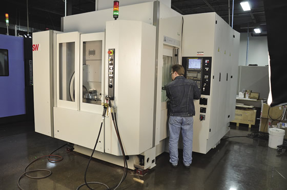

Eric%20at%20the%20SW%20BA322%20DSC_0134.tif
The SW BA322 5-axis, twin-spindle machine allows an operator a clear view of the entire machining operation. Image courtesy E. Sinkora.
