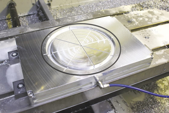

Courtesy of Pierson Workholding
A custom fixture for gripping a round workpiece.

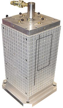

Courtesy of VAC-U-LOK
Vacuum workholding for an HMC.

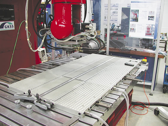

Courtesy of IBAG North America
A large vacuum chuck on a 5-axis machining center can accommodate a variety of parts.
