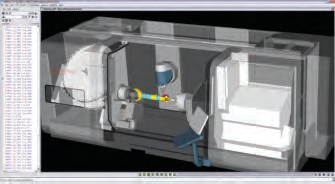

DMG-CTX2000.tif
Courtesy of CGTech
Some machine tool builders provide 3-D models appropriately modified for simulation use, such as this one from DMG/Mori Seiki.
However, 3-D models for machine tools frequently have an overwhelming amount of detail, including railings, stairs, gears and even bolts and washers. These models require modifications to reduce their data size for more efficient, daily NC program simulation. Fortunately, some machine tool builders, such as DMG/Mori Seiki, recognize the need for efficient simulation models and provide appropriately modified 3-D models.
