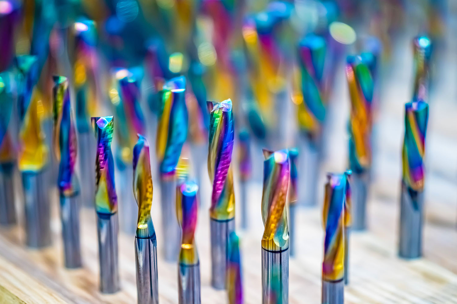

The application of coatings greatly enhances the qualities of the cutting tool
The application of coatings greatly enhances the qualities of the cutting tool by improving lubricity, increasing hardness and insulating the tool from elevated temperatures.
