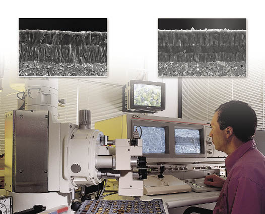

The science of formulating insert substrates and coatings.

In recent years, PVD-coated tools have expanded their market share at the expense of CVD-coated tools. CVD coating thicknesses are typically 5µm to 15µm, while PVD coating thicknesses range from 2µm to 6µm. CVD coatings create undesirable tensile stress when applied to a substrate, while PVD coatings facilitate desired compression stress on the substrate. The thicker CVD coating will usually cause a significant loss of strength at the cutting edge. For that reason, CVD cannot be used on tools that require a very sharp cutting edge.
Assigning new alloying elements to the coating process can improve layer bonding and coating properties. For example, Iscar’s 3P Sumo Tec treatment improves toughness, smoothness and chipping resistance of both PVD and CVD coatings. The Sumo Tec technology also reduces friction and thus energy consumption while increasing resistance to BUE.
The Sumo Tec process acts to reduce microcracks on insert surfaces due to differential contraction as the insert cools after CVD coating. Similarly, the process removes undesirable droplets on the coating surface produced during the PVD coating process. The result is a smoother surface, producing inserts that run cooler, last longer, facilitate better chip flow and can run faster.

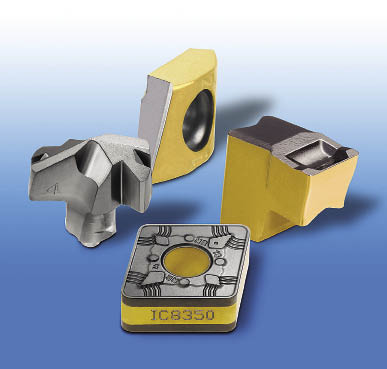

Edge Preparation
Edge preparation, or honing, of inserts in many cases is the difference between success and failure in machining. Honing parameters are application specific. High-speed finishing of steel, for example, requires inserts with a different edge preparation than inserts used for roughing. This can be accomplished on almost any type of carbon or alloy steel. Stainless steel and exotic materials are limited. The hones can be as small as 0.0003 ” to as large as 0.002 “. This may also include a slight T-land with the hone to reinforce the cutting edge for very harsh applications.
Generally, a substantial hone is required for continuous turning, as well as for milling most steels and cast irons. The amount of the hone would depend on the grade of carbide and type of coating (CVD or PVD). For severe interrupted cuts, a heavy hone or a T-land edge is a prerequisite. Depending on the type of coating, the hone could be close to 0.002 “.
In contrast, small hones (down to 0.0004 “) and sharp edges are required on inserts for machining stainless steels and high-temperature alloys due to their BUE tendency. Specials can be ordered with even smaller hones. The same sharp edges are required for machining aluminum.
For example, Iscar produces a range of inserts with helical cutting edges—the edge profile progresses uniformly around a cylindrical surface in an axial direction. The helical direction resembles a spiral. One of the benefits of the helical design is a smoother cutting action. Rather than cutting with a straight-line edge, the helical cutting edge simulates the action of a spiral flute endmill. Having the cutting edge enter the cut in a “spiraling” action rather than all at once reduces chatter and imparts a smoother finish.
Wear and peace
Various coated inserts manufactured using recently developed technology.
