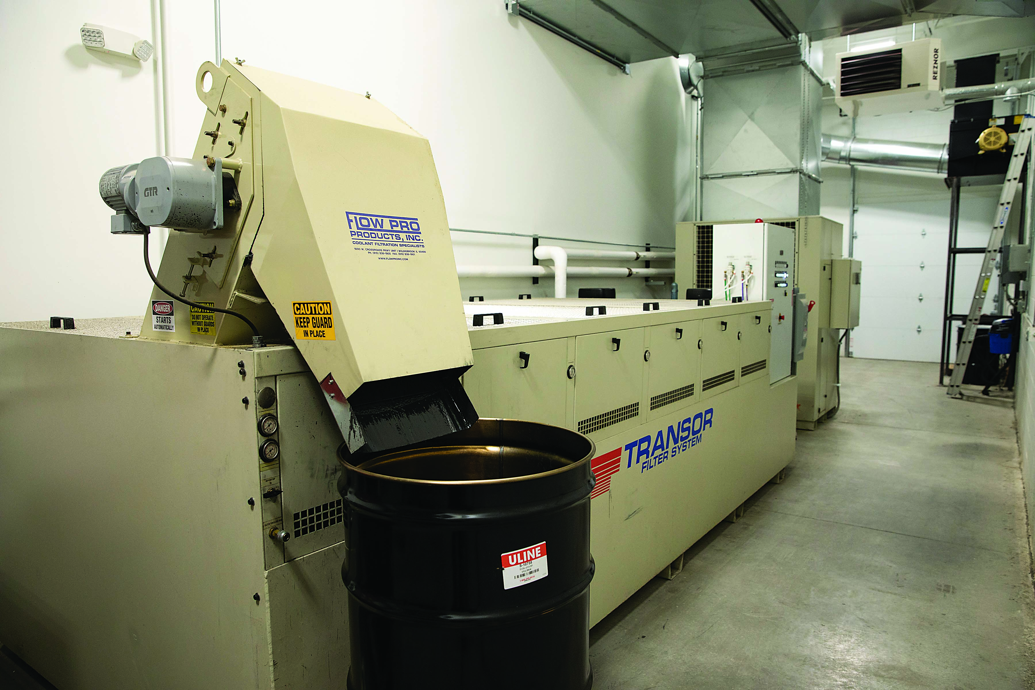

To improve coolant cleanliness, he said the toolmaker switched to vessel filtration machines from Transor Filter USA in Elk Grove Village, Illinois. Each one serviced two to three grinders.
“When we transitioned to Transor,” Cranker said, “it kept the coolant mostly clear with a slight honey-colored hue.”
To coincide with the plant remodeling, he said Gorilla Mill sought a new filtration system and considered canister-type filtration. However, that system would have complicated the recovery of carbide sludge, which sells for about $8,000 per 208.2-L (55-gal.) drum. The company generates a drum of sludge roughly every two weeks.
Having had experience with Transor Filter, which is about two hours from Waukesha, Gorilla Mill purchased a V-series filtration system to service 18 grinders and placed it in a separate room adjacent to the machining area. According to Transor Filter, the system delivers clean oil that’s temperature-controlled to ±1 degree C to each machine upon demand, and automatic backflushing self-cleans the filter elements to minimize maintenance. The automated sludge handling system additionally features a drag-out that brings sludge out of Transor Filter’s unit and dumps the sludge into a drum.
Cranker said the oil temperature is kept at 22 to 24 degrees C (71.6 to 75.2 degrees F).

Kevin said Transor Filter’s One Micron Filtration extends the life of diamond wheels.
Gorilla Mill houses the V-series filtration system in a separate room at its plant. Image courtesy of Transor Filter
“Not having buildup on the wheel enhances their performance,” he said, “and the chilled oil enables us to maintain the thermal stability required for consistent toolmaking.”
Nathan said the lubricity of oil allows diamond wheels to impart a glasslike finish, and the oil also keeps the carbide workpiece cool, protecting it from microfracturing.
“Obviously, the best fluid for cooling is water,” he said. “However, oil keeps our machines from turning into concrete, which can happen when water and carbide sludge mix.”
In addition, Nathan said having clean coolant helps keep the oil’s flashpoint high to prevent oil from exploding.
“We’ve had one before,” he said, “and it was scary. That was when we were on the media paper filter unit.”
