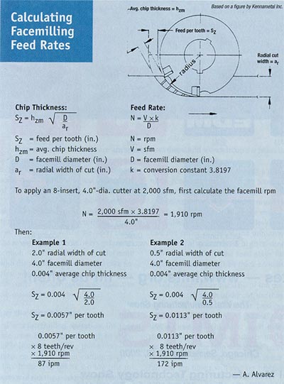

For a facemilling operation, the feed rate must be sufficiently high to allow each insert to engage the workpiece deep enough to begin cutting a good chip. If the feed rate is too low, the inserts will rub the workpiece, generating heat that could workharden the material and shorten tool life.
A rule of thumb is to specify a minimum feed rate of 0.004″ per tooth. If you are using a facemill designed with a lead angle, the feed rate must be higher, depending on the angle used. If the radial width of the cut is less than half the cutter diameter, the minimum feed rate also must be higher than 0.004″ per tooth. If the feed stays the same, the chips won’t be thick enough, causing heat to build up.
The farther away the axis of the cutter is from the width of the cut, the thinner the chip is relative to the feed per tooth. Also, remember the general rule that a cutter should never have more than two-thirds of its diameter in the cut. If it does, the chip will be too small at the point the insert enters the material, and the insert will end up rubbing instead of cutting.
