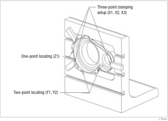

s4.tif
A nonround part fixtured for horizontal machining of the front and back in one setup. Image courtesy J. Mason.
For the nonround parts discussed in this column, I am assuming workholding for either horizontal or vertical milling.
Clamps should be placed directly above part locators because that minimizes the effect of cutting forces on a part. It is not good practice to clamp over voids and open bores that require finishing because that can limit tool access and, more importantly, damage the part by bending or otherwise distorting it. Metal has a tendency to move when you least expect it.
When roughing, use no more than three clamps on the fixture unless it is a very large part. A three-point locator and clamp setup is the first choice. Larger parts may require work supports in other unsupported areas to dampen machining forces. Also, roughing and finishing toolpaths must not interfere with clamp locations.
