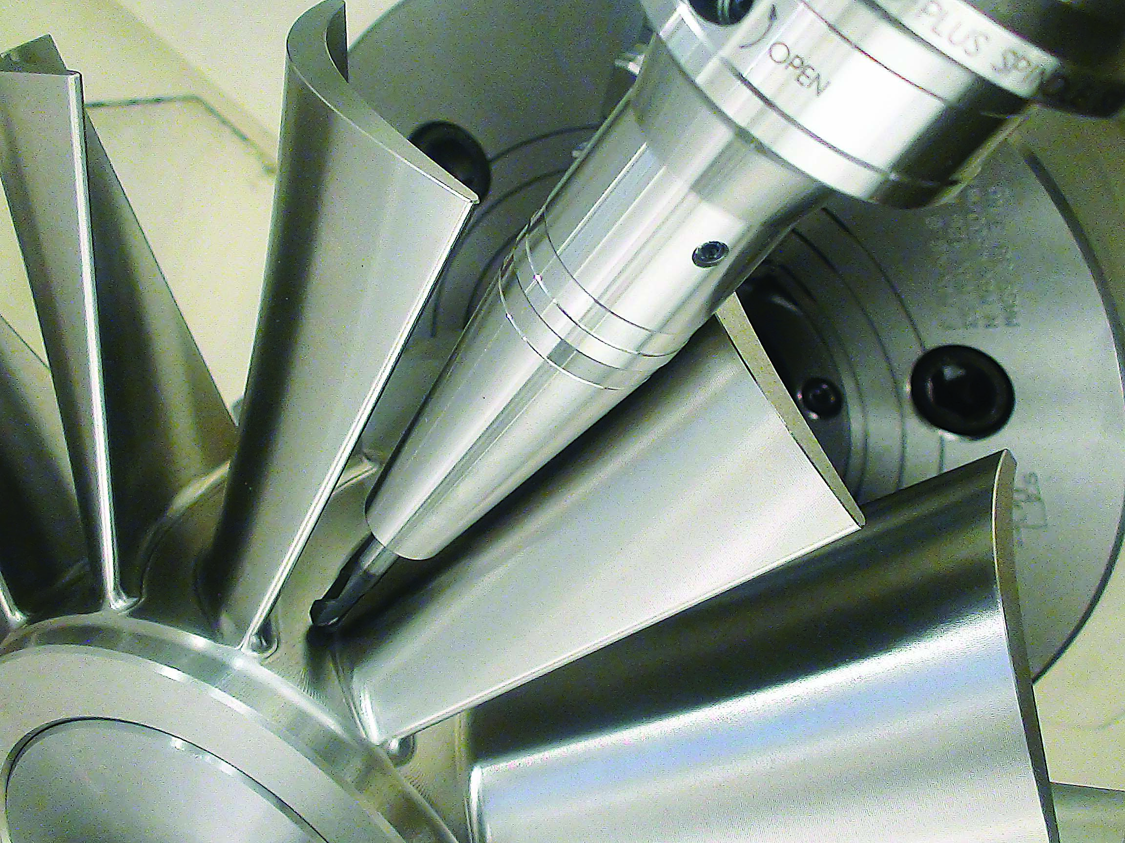

Machining of a detail feature with a Super Slim hydraulic holder from BIG KAISER enhances part access. Image courtesy of BIG KAISER Precision Tooling.
On a trunnion-style 5-axis machine, however, the workpiece tilts and rotates along with the riser. “All of that mass moving and rotating can cause additional momentum that then increases the inaccuracy of the machining center,” he said.
To minimize the mass, a parts manufacturer might select an aluminum riser, Zaya added. “But they are generally very large risers that take up a lot of space on the machine table and don’t provide anything beyond just that capability of high elevation.”
To achieve that elevation without consuming so much table space, Zaya recommends a modular system. This enables users to stack and dismantle extensions and reductions as needed. “You are not adding a solid, monolithic riser that adds a lot of additional mass, momentum and inaccuracy.”
