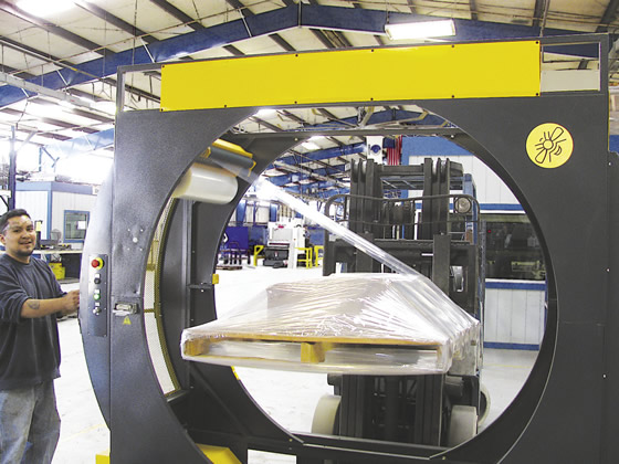

A 3 ‘×3 ‘ pallet being shrink-wrapped at Crow Corp. With one person, a shrink-wrapping job takes about 1 to 2 minutes per pallet.
“It might range from a small box with maybe 100 parts in it that doesn’t weigh much to large, heavy fabrications that are welded together,” said Keith Jennings, president of Crow and a CTE columnist. “Month to month, we send out thousands of parts. We usually have two to three pickups by UPS and FedEx per day, and more in some cases. And we usually have an 18-wheel truck pick up something once a day.” Items going on larger trucks include fabricated tanks, cabinets and consoles.
With all those parts to manage, Crow has a two-person shipping department. “During the quoting process or when we receive an order, we make a decision on what container or packaging is required to determine if there’s anything unusual or special,” said Jonathan Taylor, Crow’s shipping manager. “Customers sometimes give us specific packaging and shipping instructions, but mostly they let us determine the best, safest manner. The shape, size, weight and material of the part are all factors in deciding what to use.”
If the item is too large for a box, Taylor puts the part on a pallet and shrink-wraps it. To minimize the expense and labor of shrink-wrapping so many packages, Crow bought a Yellowjacket shrink-wrap machine about a year ago (see photo above). Now, one person can shrink-wrap large pallets or containers, instead of two or three. The machine also wraps much tighter and more efficiently than people, which means Crow uses less shrink-wrap material over the course of a year, “saving a couple of thousand dollars or more,” Jennings said.

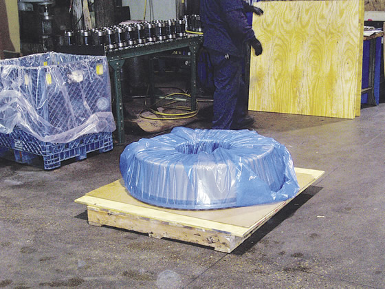

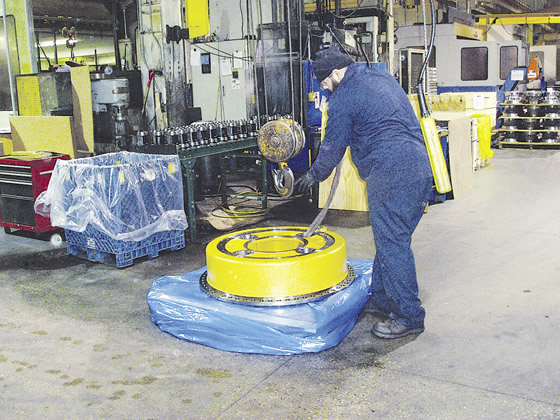

A worker at Milwaukee Machine Works (top) places a planetary carrier, approximately 38 ” in diameter by 8 ” high and used in a heavy equipment application, in a VCI bag. The packaging operation takes about 15 minutes.

When metal parts are packed in VCI material, VCI molecules settle on the metal surface to form an invisible, thin, protective layer on all surfaces, including cracks, cavities and crevices. This protective layer works as a barrier between the metal surface and corrosion-causing materials, such as moisture, oxygen, dirt and salt.
“It is very important when you have drastic temperature changes—such as going from inside to outside in a Midwest winter—that you prevent condensation on the parts,” Manna said. “As soon as you get condensation, you get rust.”
On its larger parts, roughly 38 ” in diameter, that go on 48 “×48 ” skids, MMW makes sure nothing extends over the end of the skid. If the part did shift, it might get damaged and make it unacceptable.

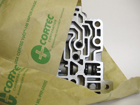

A valve body of a transmission is placed in VpCI packaging.
When it comes to VCI packaging, knowing the type of metal being protected is critical, according to Tiffany McEwen, sales representative for AGM Container Controls Inc., Tucson, Ariz., which distributes vapor-phase, corrosion-inhibitor (VpCI) products for Cortec Corp., St. Paul, Minn. VpCI is a type of VCI packaging. “There are VCI’s designed to protect only one type of metal, such as steel or aluminum. And when you have an item that has ferrous and nonferrous metals, such as an engine block, there are particular VCI products that are made for that application.”
With VpCI technology, the corrosion-inhibitor substance protects the metal surface through a vapor phase instead of requiring actual contact with the surface.
“Also, we like to know if it going to be crated in a wood box, and if the wood is heat-treated or not,” Mc-Ewen said. “Nonheat-treated wood and cardboard have a naturally occurring amount of moisture so it is important to know that ahead of time so we can provide the proper amount of protection.”
Even when a large crate is palletized and wrapped, she added that a temperature change can cause “container rain,” where moisture builds up and rains on the parts. “That is where a lot of rust comes from.”
