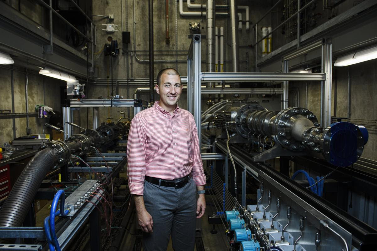

And it’s quite a tale: “There’s a line you cross at around Mach 5,” said Purdue Associate Professor Carson Slabaugh, whose 20-person team at Zucrow Laboratories has been studying high-speed combustion systems since he started his lab at Purdue in 2015. “When a vehicle flies that fast, extreme compression and heating of the air flowing around and within the fuselage occurs. At Mach 5, it’s about a six-fold increase in the temperature and a pressure increase of a few hundred times. That kind of thermal and mechanical loading causes the regime of aerodynamics and thermodynamics and structural mechanics to completely change compared to lower-speed systems.”

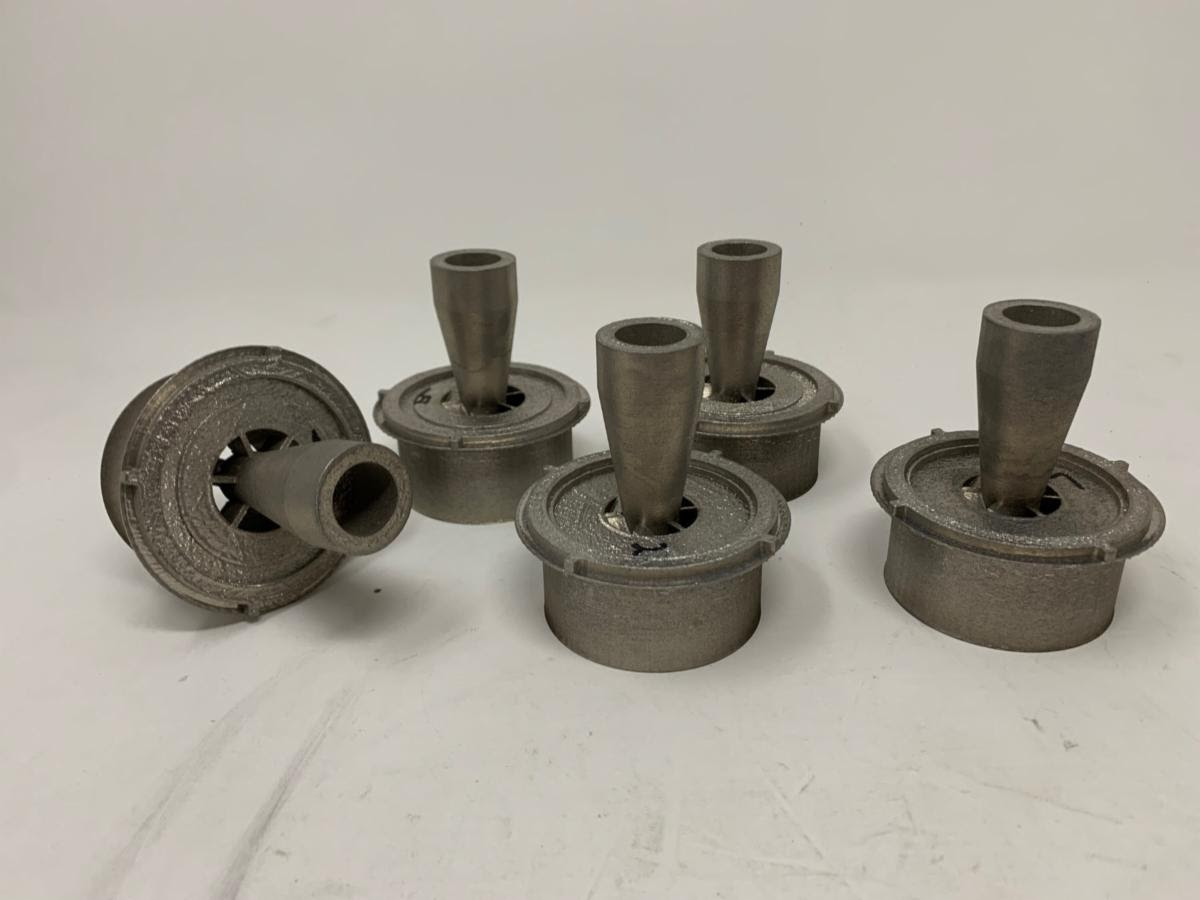

To meet this challenge, Slabaugh and his team partnered with VELO3D, a company that develops and sells metal 3D printers, to ‘print’ fuel injectors with complex geometries that achieve very high fuel-air mixing performance. The parts could not have been made with conventional fabrication methods, especially not with the high-temperature, high-strength metal superalloys needed to survive the extreme testing conditions. The teams worked together to rapidly prototype the Purdue team’s designs for testing, evaluation, and design iteration. Slabaugh and team then used the data from the prototypes to scale up their designs into a full-scale system, which VELO3D also manufactured.

“We engineer components that will experience hypersonic environments while going zero miles per hour and staying bolted to the ground,” he said.

“What we’re working on with VELO3D is basically a very large 3D-printed burner, which will be used to create the hypersonic flow environment on the ground in a test cell,” said Slabaugh. “Effectively, if you want to test a hypersonic vehicle on the ground you build a rocket engine with a big converging-diverging nozzle and a supersonic plume of extremely hot gas; the ‘fireball’ that the vehicle is flying through. The whole system is bolted down into lots and lots of concrete. You then stick whatever component you’re designing inside that plume and watch what happens.”
“With VELO3D, we’re designing the injectors for that combustor to produce very specific turbulent flow fields that mix fuel at a certain rate and allow us to stabilize a very powerful flame in a very compact volume. This creates the conditions for all the things we’re going to test downstream.”
This is where AM is proving its worth for the “build and burn.” The ability to quickly 3D print a variety of injector geometries for the test combustor—in this case made out of Hastelloy X, one of the few high-strength, high-temperature superalloys that can withstand the hypersonics environment—enabled the Purdue team to rapidly identify which design worked best.
For Nick Strahan, a test engineer working on Slabaugh’s team, the experience of using AM was an eye-opener. “We had essentially approached this problem with traditional subtractive manufacturing techniques in mind before,” he said. “But there were some features in our design that would have limited the performance of the combustor—and doing it additively with VELO3D instead enabled us to integrate our unique geometry much more easily.”
Swerving past the roadblocks of traditional manufacturing
Using traditional subtractive manufacturing would have meant casting individual parts, which requires long, drawn-out cycles of tooling, mold-making, and design iteration. “AM techniques significantly shortened manufacturing lead times as we optimized our designs,” said Strahan.
The engineers subtly varied the flow passages of the injector with five different designs (just a matter of tweaking the STEP data file that the Velo3D Sapphire system’s print-preparation software accommodated automatically), printed them out and ran them through a gauntlet of hypersonic-relevant test conditions.
“The VELO3D end-to-end manufacturing system produced dense parts requiring minimal post-processing,” said Strahan. “With just a little bit of cleanup machining, we could install them into our research-scale combustor for testing. We could then measure the combustion efficiency produced by each geometry with the goal of generating a flow that is chemically and thermodynamically similar to the atmosphere at very high flight speeds.”
In just two weeks the team was able to isolate the highest performer that had all the stationary and dynamic features they were looking for.
That high-performance injector met the critical parameters that the engineers valued most for performance of the combustor: flame power (as a proxy for the simulated flight conditions) and flame stability (a metric for the health and efficiency of the combustor). “Both power and stability were necessary for us to create the realistic ground-test environment with our device, but these are often very difficult parameters to balance in a large-scale device,” said Slabaugh. “We were able to tune the injector geometry and flow conditions independently in our testing to achieve optimum outcomes with these two, inseparable parameters. We see AM as a powerful tool with which we can bring other creative engineering solutions to complex design problems into reality more quickly.”
