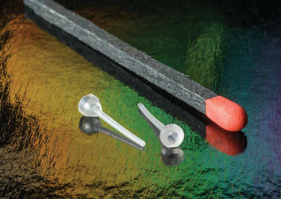

Examples of “impossibly small and intricate parts” that Accumold has developed for medical device OEMs over its nearly 40-year history will be on display at the upcoming MD&M South event on booth 1911, June 4-6, in Charlotte, North Carolina.
In addition, attendees will also be able to see examples of Accumold’s thin-walled cannulas which the company can now micro injection mold at volume.

Runyan continues, “We are especially pleased to be able to discuss our ground-breaking innovation in the field of thin wall cannula manufacture at MD&M South. Micro molding cannulas at volume with an outside diameter of 0.035″ (0.889 mm), an inside diameter is 0.027″ (0.6858 mm), and a wall thickness of 0.004″ (0.1016 mm) are routine at Accumold today. We have achieved this through attention to material choice, several critical DfM considerations, assembly considerations, maintaining a balanced aspect ratio to avoid challenges associated with flow dynamics, cooling, and structural integrity, and critically importantly through the use of our proprietary micro molding presses. Micro molding thin-walled cannulas is a game changer for medical device manufacturers overcoming the labor-intensive, time-consuming, and expensive traditional thin wall cannula manufacturing processes such as extrusion, tipping, and gluing to a metal hub.”
