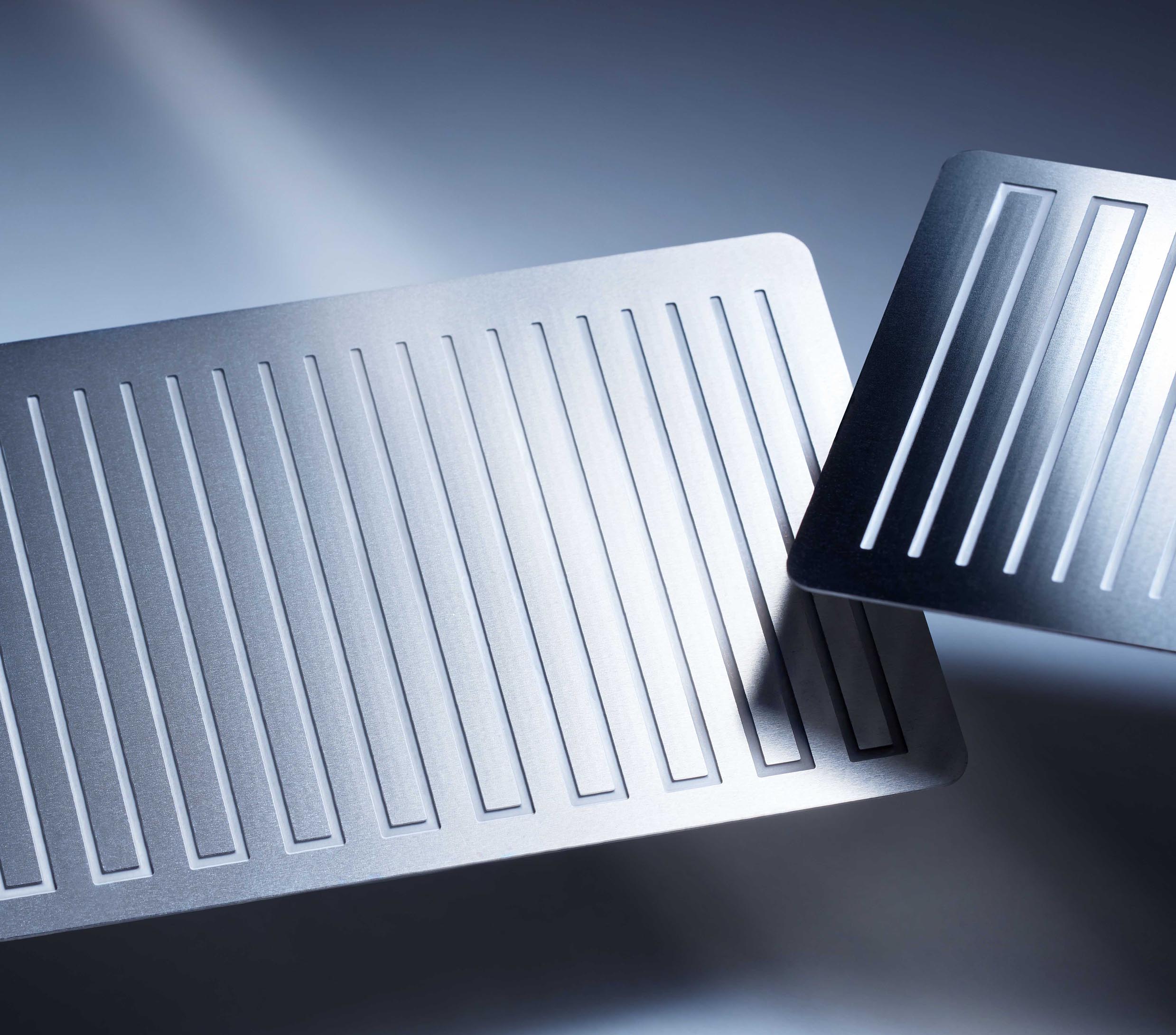

Bipolar plateStainless steel is essentially low-carbon steel that contains chromium at 10% or more by weight. Adding chromium gives the steel its unique stainless, corrosion-resisting properties. The chromium content of the steel allows the formation of a tough, adherent, invisible, corrosion-resisting chromium oxide film on the steel surface. If damaged mechanically or chemically, this film is self-healing, provided that oxygen — even in very small amounts — is present.

The micrometal "Etching Group" (comprising HP Etch and Etchform) etches a variety of metals with a precision that is unparalleled anywhere in the world. The thickness of the processed sheets and foils ranges from 0.003 to 2000 µm. Stainless steel, however, remains the number one choice for many of the company's customers due to its versatility, the numerous grades available, a large number of related alloys, its favorable material properties (as mentioned above), and the vast array of finishes. It is the metal of choice for many applications in a wide range of industries, micrometal specializing in the processing of 1.4310: (AISI 301), 1.4404: (AISI 316L), 1.4301: (AISI 304), and well-known austenitic metals, a variety of ferritic, martensitic (1.4028 Mo/7C27Mo2) or duplex steels, Invar, and Alloy 42.
When compared with traditional sheet metalworking technologies, photo-chemical etching (which produces precision components by selectively removing metal through a photo-resist mask) has several inherent advantages. Most importantly, photo-chemical etching produces parts while at the same time eliminating material degradation, as no heat or force is used during processing. In addition, the process can produce parts of almost limitless complexity as component features are removed simultaneously using etchant chemistries.
The tooling for etching is either digital or glass, so there is no need to start cutting expensive and difficult to adapt steel moulds. This means that large quantities of products can be reproduced with absolutely zero tool wear, ensuring that the first and millionth part produced are the same.
Digital and glass tooling can also be adapted and changed extremely quickly and economically (often within an hour), making it ideally suited to both prototype and high volume production runs. This allows for "risk-free" design optimization without financial penalty. Turnaround time is estimated to be 90% quicker than for stamped parts, stamping also requires substantial upfront investment in mould fabrication.
