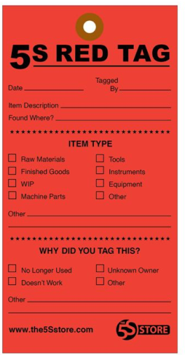

The first step in this process was to sortthe assemblers’ workspace by creating an index of all equipment necessary to assemble its resistance welding products and laser system machines on a daily basis, and removing all other equipment, tools, etc., to store elsewhere. This was done via a red-tag system in which, during a special 2-hour period at the end of each month, assemblers were instructed to attach red 5 S tags (pictured below) to any tool not used on a daily or weekly basis and place it on a large rolling table purchased specifically for the purpose of collecting unused tools. A free lunch was offered to the department that could tag the most items that were unnecessary in their work areas and fill up their rolling table. These tagged items were reviewed a separate team, who decided how and where these tools should be stored and arranged.
A red tag used to sort

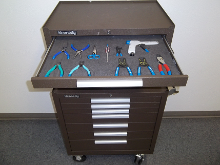

The next step was to set in order and straighten the workspace. AMYA purchased all new, matching tools and toolboxes to place in each work cell throughout the systems manufacturing area. The company also installed foam inserts with cut-out spaces for each tool into every drawer of every toolbox. With this complete, every tool had a specific spot in every toolbox where it could always be found if not already in use.
