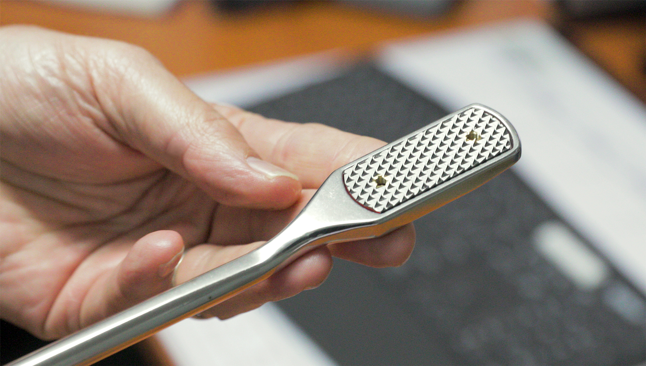

Rasp in float close up.

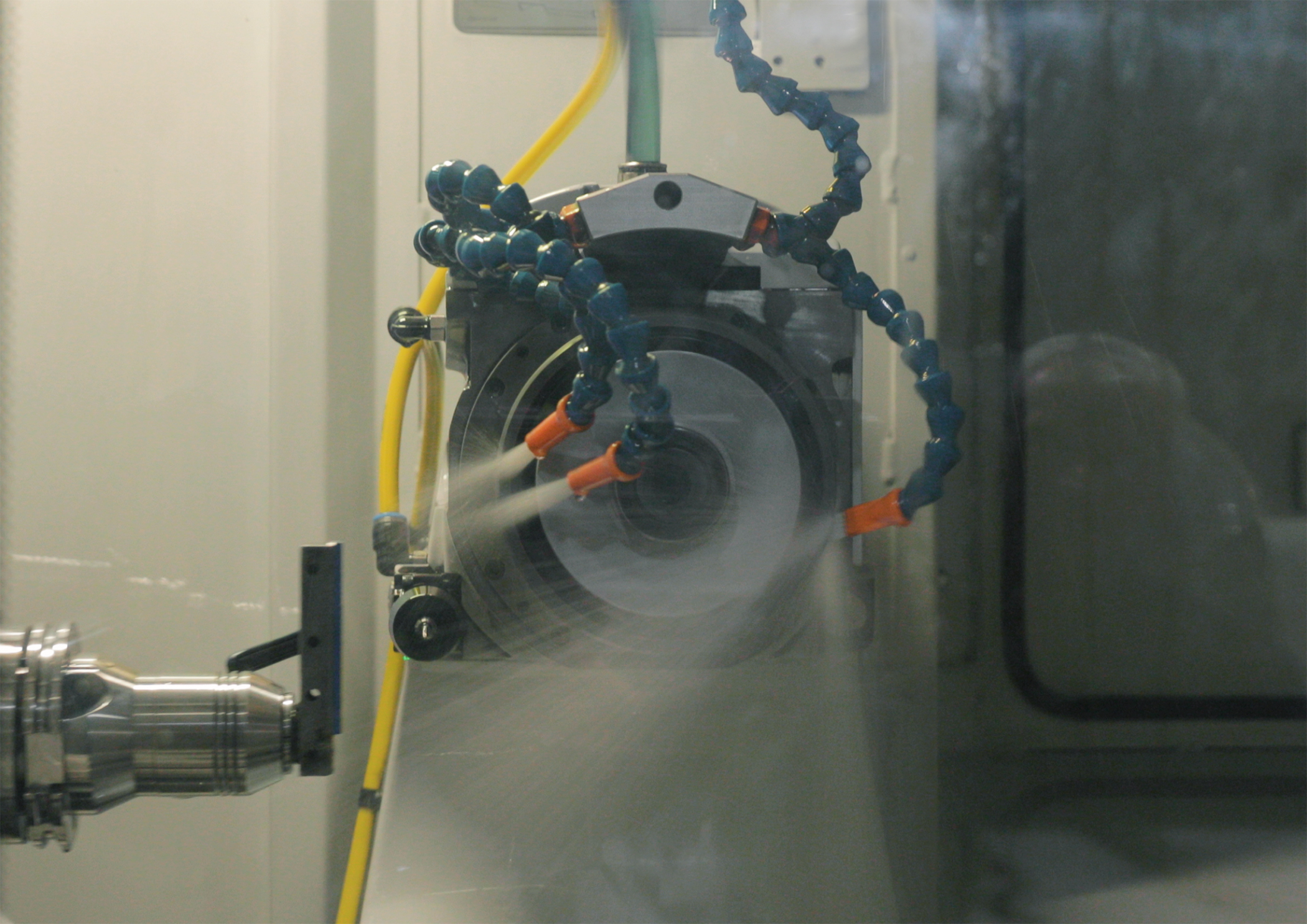

Operator observing grinding process on the FX5E.
