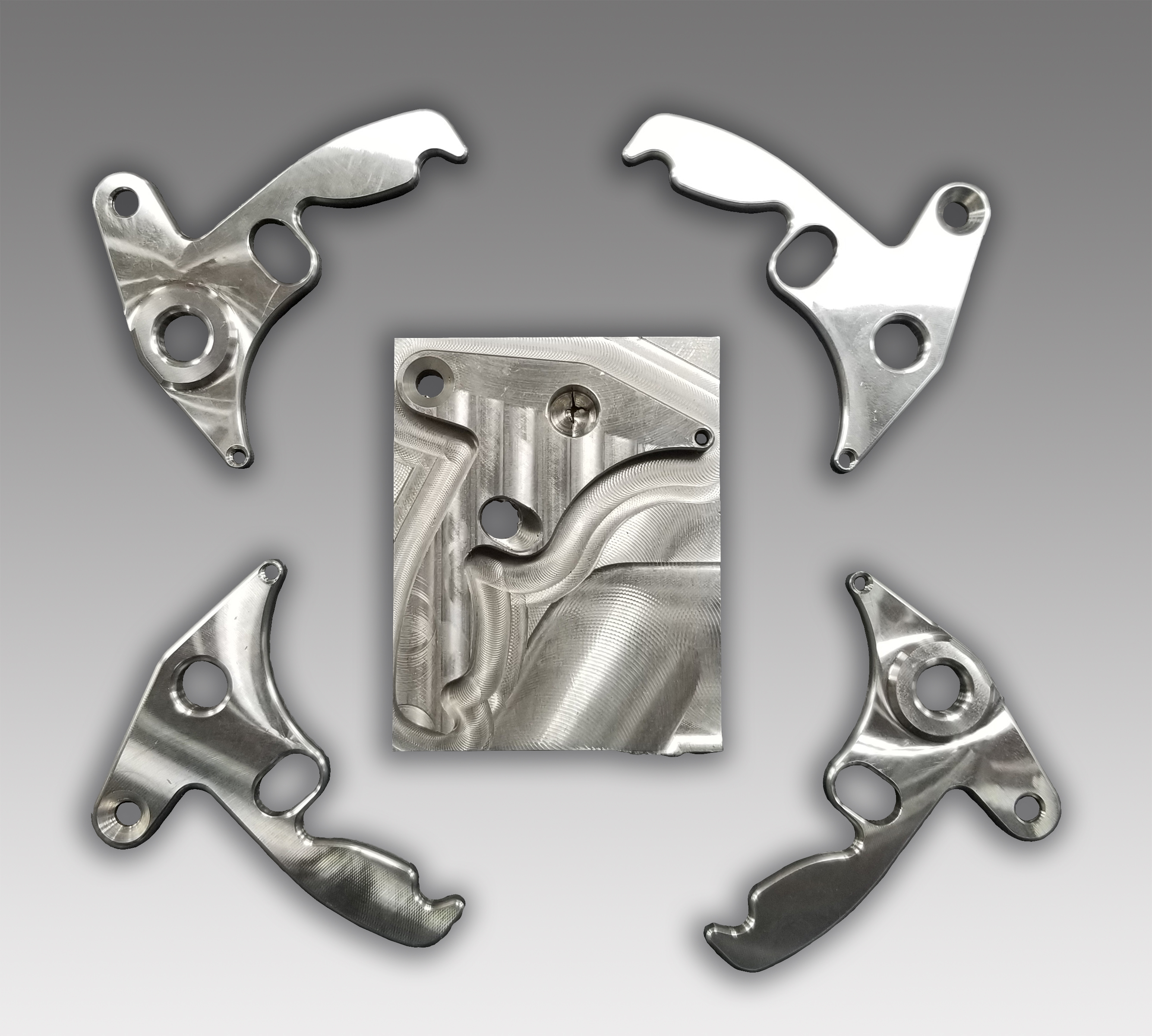

Auto parts maker saves 60% with mill and chuck solution imageAuto parts manufacturer SB Dezigns in North East, Maryland, has implemented a new end mill and chuck solution that helped them save 62% in costs on a high-performance shifter part machining application for the racing industry.

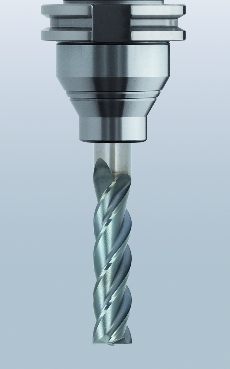

For the shifter parts, Emuge recommended and tested its Top-Cut VAR end mill and FPC milling chuck solution, as well as more aggressive feeds and speeds on the vertical CNC machining center.
The standard length Top-Cut VAR End Mill with corner radius is made from premium solid micro-grain carbide with ALCR Coating. The mill dampens vibration, increases feed rates and can be used in nearly all materials and milling strategies due to its special geometric properties.
The Emuge FPC milling chuck provides a critical part of the solution, offering unprecedented rigidity, vibration dampening, concentricity and optimal pull-out protection via a pin lock collet system to enaSales Representative Bill Anderson from EMUGE's local distributor W.C. Chapman (L), and SB Dezigns Owner and CEO Billy Crabtree (R) at the SB Dezigns precision production machine shop.ble faster machining speed and longer tool life.
Crabtree said the new tools reduced cycle times, and lated longer, which provided them with more than 60% cost savings on shifter parts manufacture.
“With the EMUGE end mills and holder combination, we are able to save over 30 hours of machining time and more than $5,000 for every 500 shifter parts we manufacture,” he said. “And I don’t have to wait for my tools – they are locally stocked at our distributor.”
