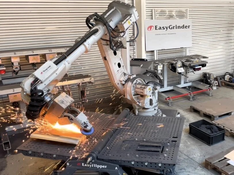

The EasyGrinder combines 3D vision technology with an AI-enhanced controller. Before each machining operation, the actual geometry and position of the workpiece are automatically detected, which the company says ensures consistent processing quality, even when individual parts vary. Complex contours are automatically recognized and followed without the need for additional programming

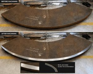

Automated weld seam preparation with AI grinding robot image
Weld beveling, deburring, and edge rounding in a single automated process.
The EasyGrinder fully automates post-processing. In a single step, it deburs, grinds, rounds, and chamfers component edges. This is a cost-effective alternative to milling for sheets up to 1.2 inches thick, or thicker sheets with small bevels. By combining multiple operations into a single automated step, handling, work-in-progress inventory, and manual grinding activities are reduced wile ensuring consistent and repeatable quality.
According to Teqram, the new capability is particularly relevant for manufacturers looking to increase production capacity without becoming more dependent on scarce technical personnel. The EasyGrinder not only takes over physically demanding grinding operations but also automates the handling of heavy plate components.
The robot can automatically pick up parts, position them for processing, and stack them again after completion. The EasyGrinder handles workpieces weighing up to 1,300 pounds, with dimensions up to 13.1 x 3.3 feet or 5.2 x 5.2 feet. Because handling is fully automated, crane movements and manual intermediate steps are eliminated, reducing throughput time and improving operator productivity.
