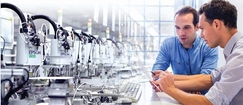

Automation 101: A step-by-step guide to getting started image
Photo courtesy of Epson America

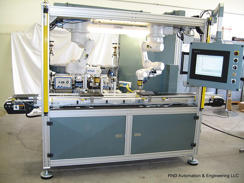

Photo courtesy of RND Automation & Engineering

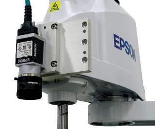

Epson G3 SCARA robot with a mounted mobile camera as part of the Epson Vision Guide option. Photo courtesy of Epson America

Vision—If the parts cannot be fed within proper tolerances, vision may be required and integrated with the robot for precise pickup or placement. Vision may also be required for inspection of components or finished assemblies.
