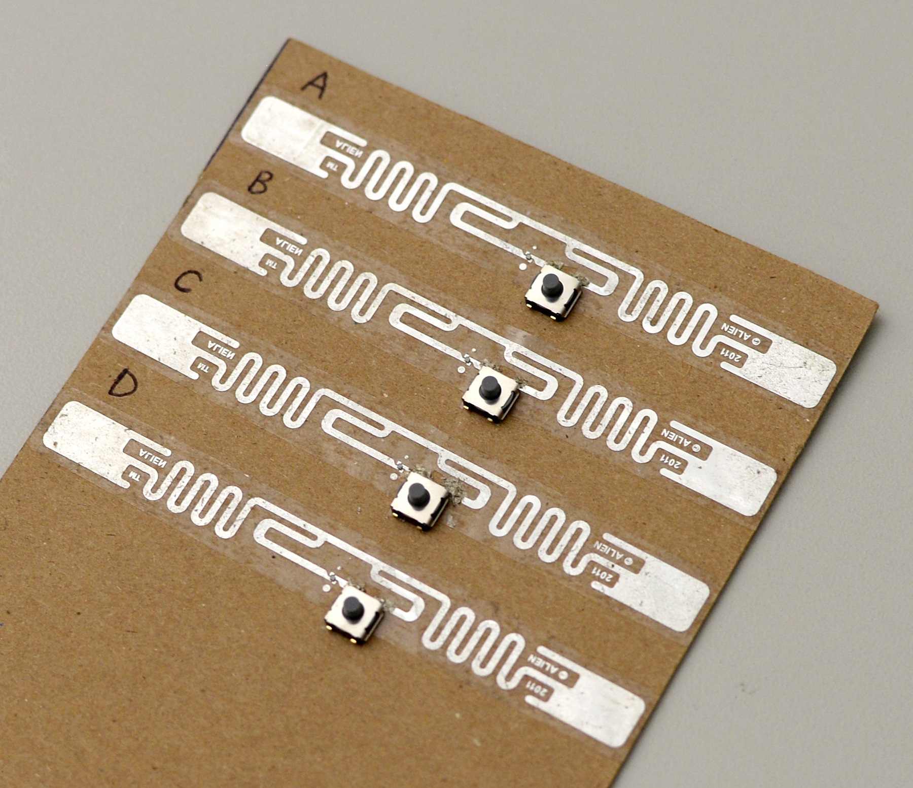

Batteryless smart devices closer to reality image
An RFID tag is modified by cutting out a small part its antenna (silver ribbon) and placing a small push-button switch on it. If several modified tags are mounted on a surface, they can act as a wireless keypad.

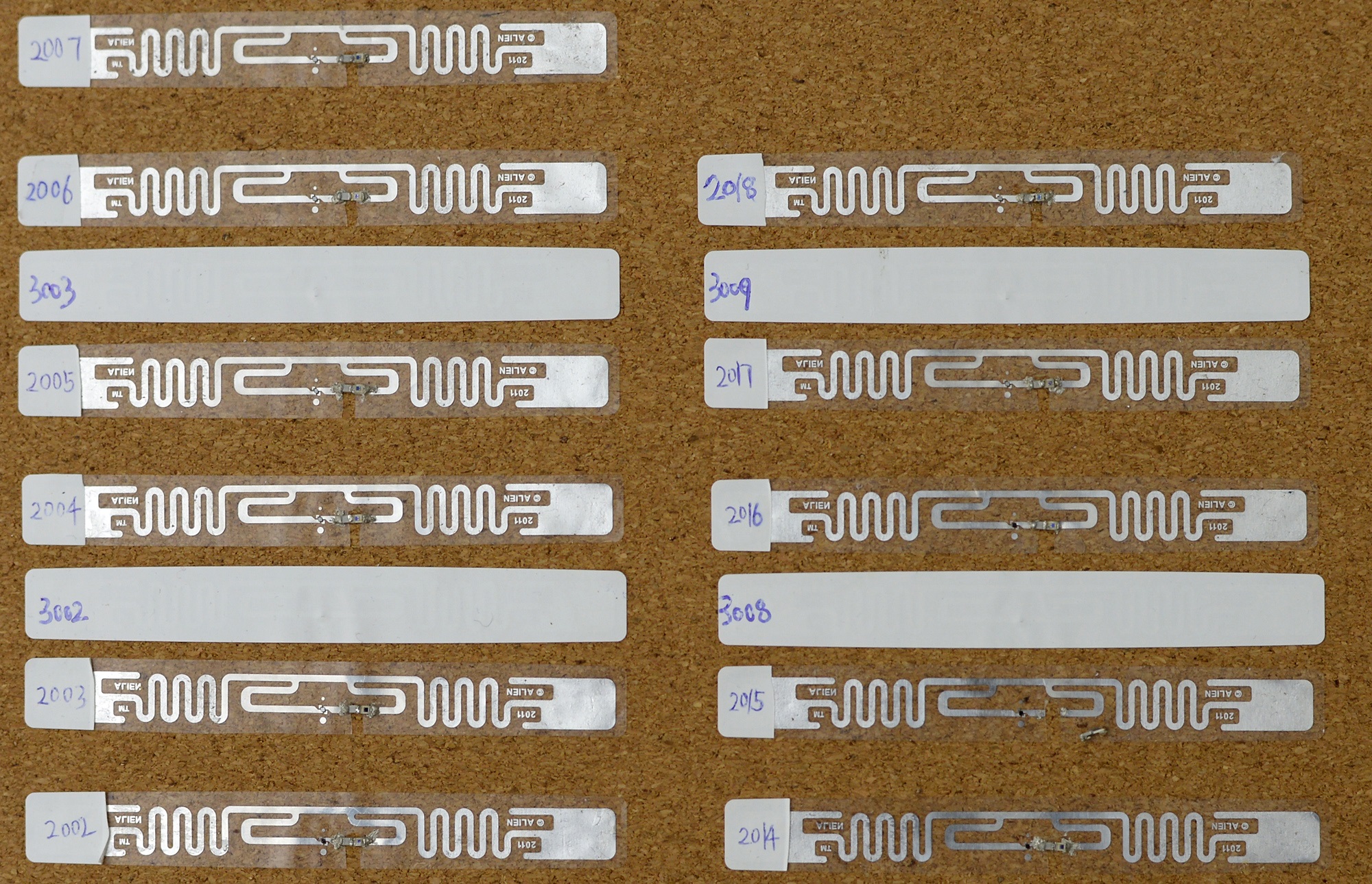

To give a tag eyes, the researchers hacked an RFID tag with a phototransistor, a tiny sensor that responds to different levels of light.
By exposing the phototransistor to light, it changed the characteristics of the RFID’s antenna, which in turn caused a change in the signal going to the reader. They then developed an algorithm on the reader side that monitors change in the tag’s signal, which is how it senses light levels.
An RFID tag is modified by cutting out a small part its antenna (silver ribbon) and placing a small light-sensing phototransistor or temperature-responsive resistor (thermistor) on it.
