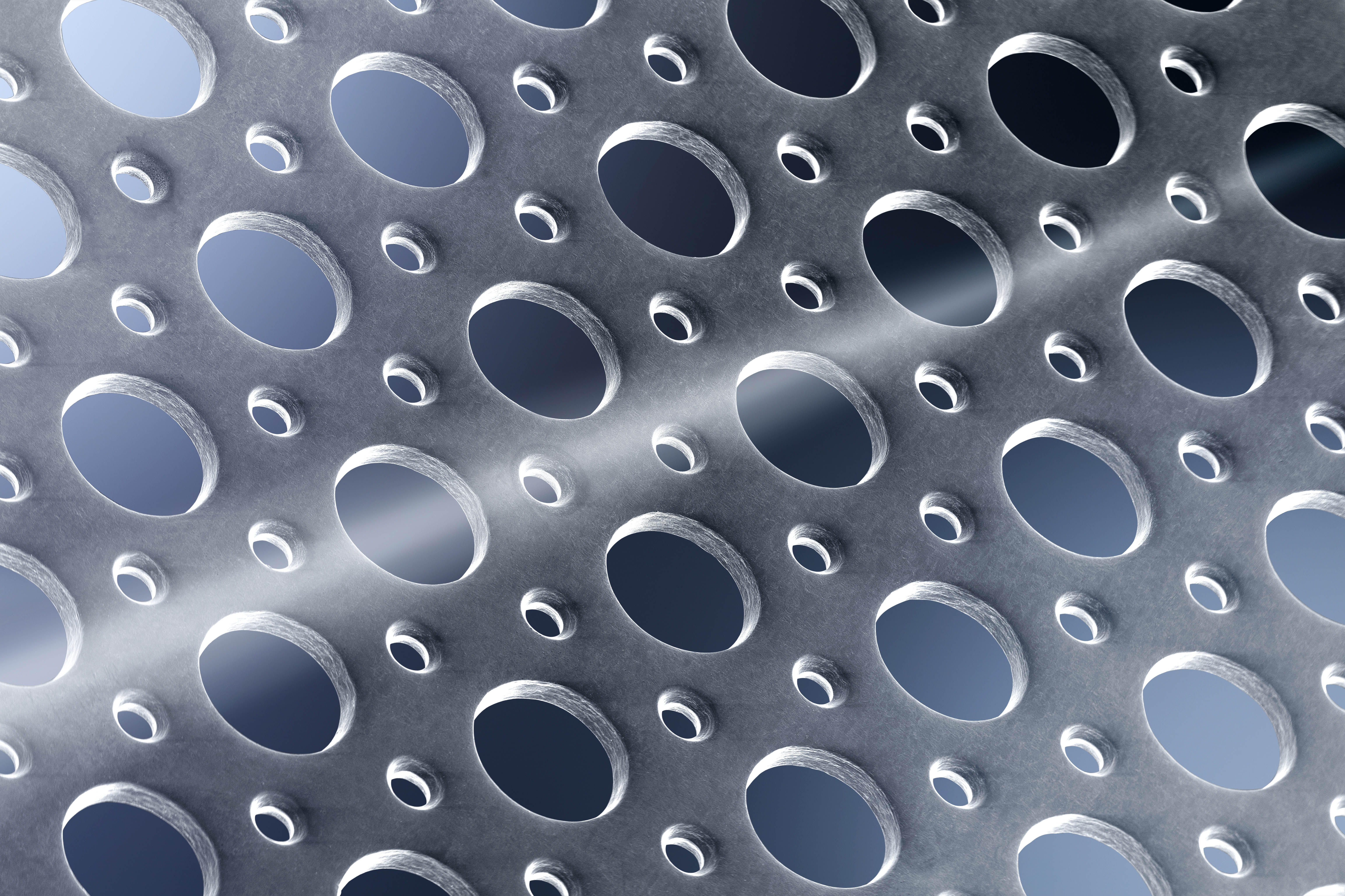

![Photo-chemical etching](/sites/default/files/styles/headline_teaser/public/2022-04/micrometal%201.jpg?itok=ktOFOQKa)

PCE is a metal processing technology that produces stress-free, flat components by selective etching through a photo-resist mask. It is well suited to the manufacture of precision parts such as grids and meshes, precision filters, sharp piercing or cutting edges, lead frames for integrated circuit boards, fuel cell and heat exchangers plates, precision springs, and washers and gaskets.
When compared with the above detailed conventional production processes, it has several inherent advantages. Key among these is the ability to produce parts without degrading material properties; the fact is that there is almost no limit on part complexity, and the ability to process a huge range of metals and alloys. Metals suitable for etching can be both ferrous and non-ferrous and include austenitic and martensitic steels, coppers, brass, and nickels. Hard-to-machine metals such titanium, its alloys, and aluminum can be processed, and also high-temperature alloys such as Inconel, and precious metals including silver can also be machined.

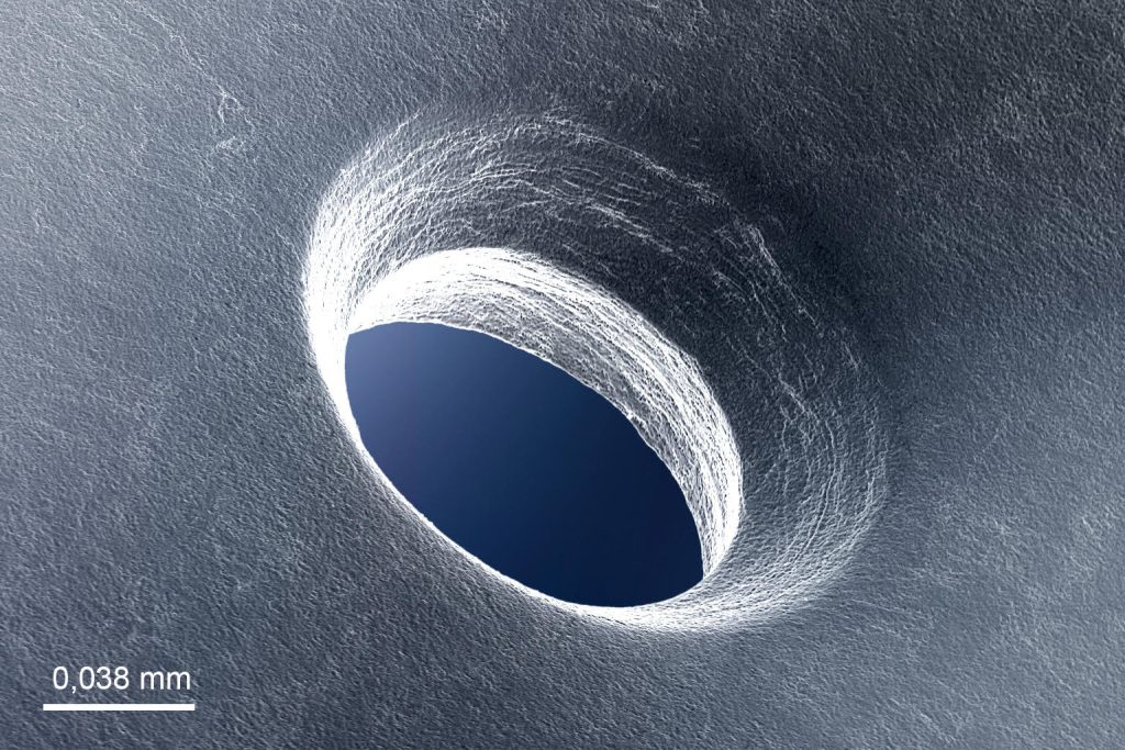

PCE can produce finer detail than is possible with stamping, and there is no degradation and deformation of the metal being processed, and no burrs or defects produced. Failure rates are minimal, and every part produced is absolutely flat, which in some applications is vital.
