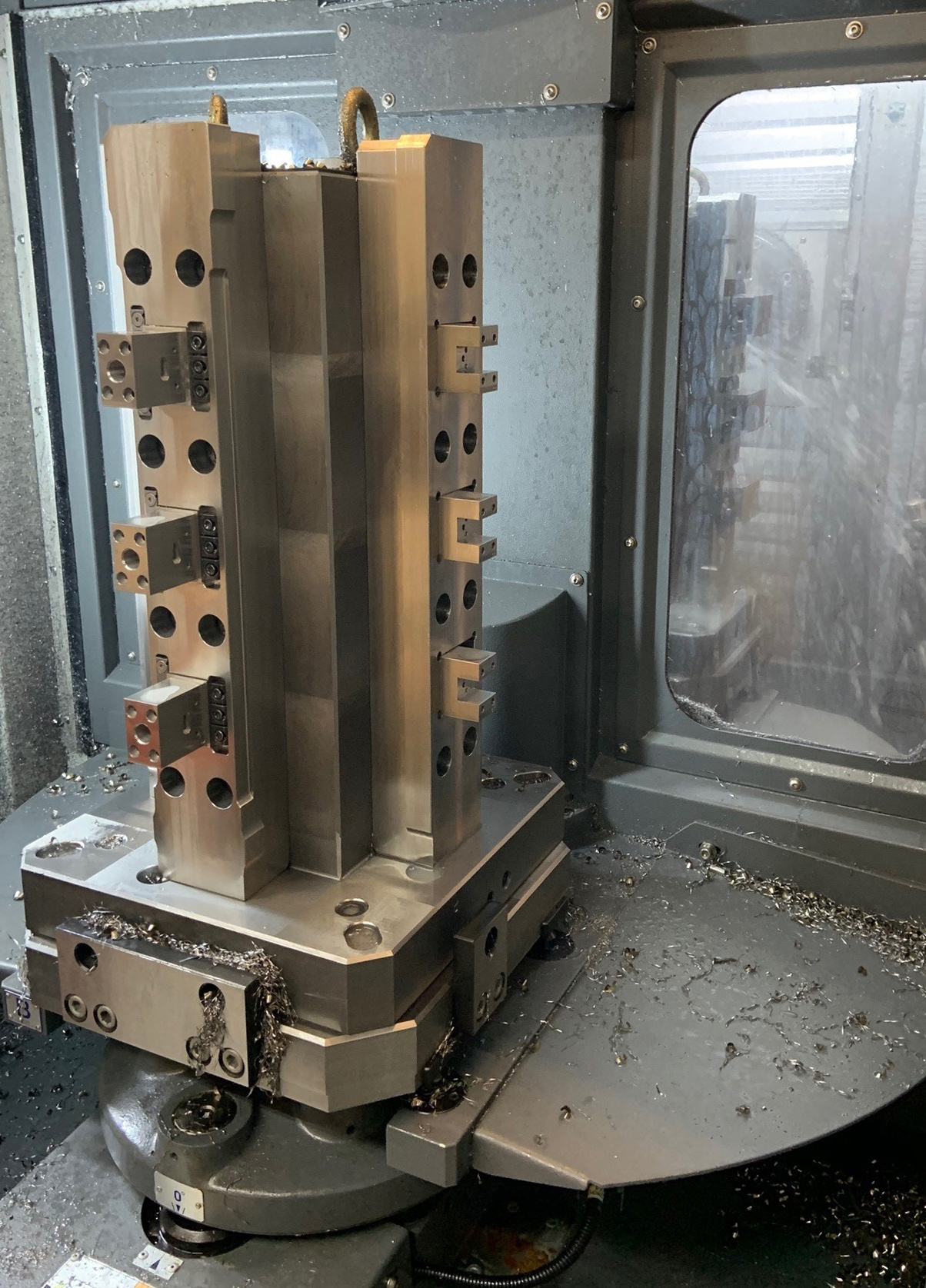

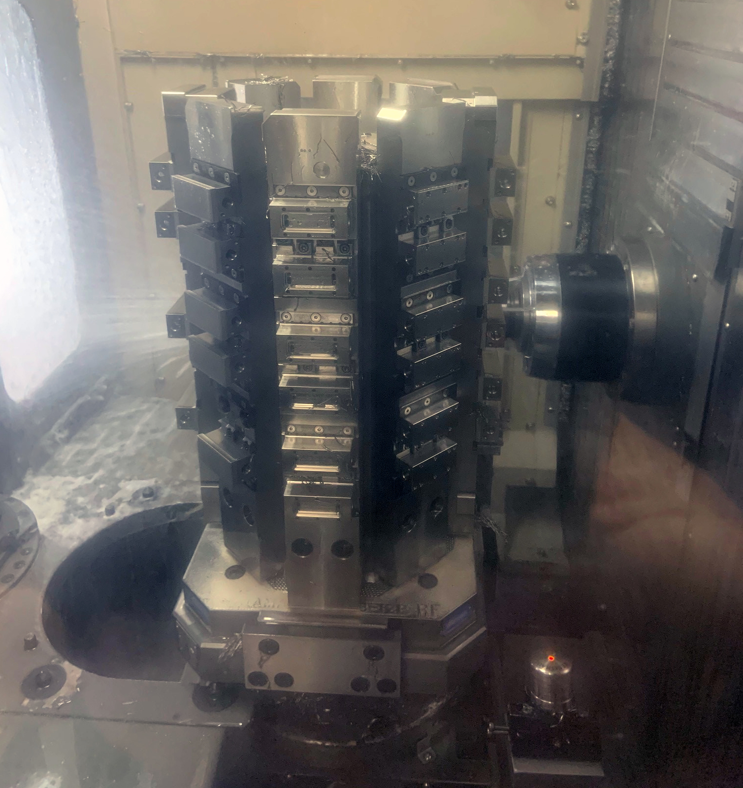

Of course, the most apparent feature of a horizontal CNC machine is the B-axis, which allows users to machine multiple parts simultaneously using a tombstone.
A tombstone compared to a vertical machine offers more productivity, said David Moore, an applications engineer at Method Machine. While a cycle runs and machines numerous parts, the operator can prepare the next tombstone to maximize production.
“You can hit multiple parts in one setup instead of having to do each part individually,” he said.

There was some trial and error with the first machine. Between figuring out the best way to implement tombstone tooling and workpiece holding, Camron ended up working 80 hours per week for a few weeks. Other aspects, however, were more straightforward. Since Camron used many "if/then" statements and loops in his CNC programming, the programs transitioned seamlessly to horizontal machining.
Learning the ins and outs of horizontal machining paid off. When other managers and directors realized the output one KIWA KMH 300 gave them, they asked Camron how soon they could get another up and running.
Less than two months later, the shop had another KIWA KMH 300. By the time Alicat received the second machine, Camron already had his fixtures and tombstones dialed in. The second KIWA was mass-producing quality parts within three days.
Soon, Alicat purchased two more KIWA KMH 300 machines, this time with PC6 pallet changers. The speed and versatility of the horizontal machining centers combined with standard automation solutions allowed Camron to shave approximately 50% off his cycle times compared to the vertical machines. Additionally, the automation allowed the shop to run lights-out during off-hours.
“The tombstone added a whole new dimension to our capabilities,” he said.
