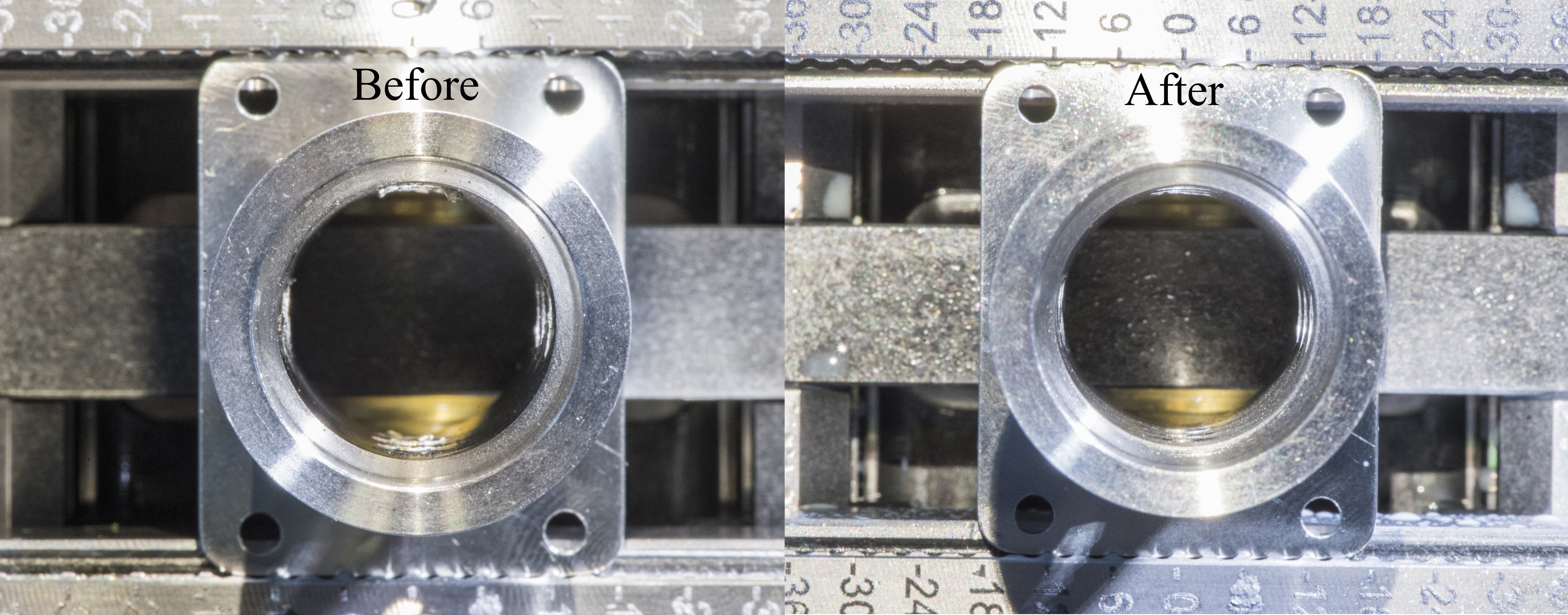

Given the critical nature of the applications in which these components are utilized, most machined superalloy parts must therefore undergo a surface finishing operation to remove workhardened layers and any heavy burrs. Doing so has additional benefits, including reducing the risk of oxidation and stress corrosion cracking (SCC).
Although this has traditionally been achieved through an expensive, messy and time-consuming grinding process, new flexible hones are simplifying the task by incorporating one of the toughest, hardest materials on the planet: CBN.
CBN combines the highest hardness with excellent toughness to provide the optimum surface finish. Flexible hones made of this type of material can be mounted on CNC equipment for automated operations or used in the field with handheld power tools to wear away work-hardened surfaces without inducing additional thermal distortion.

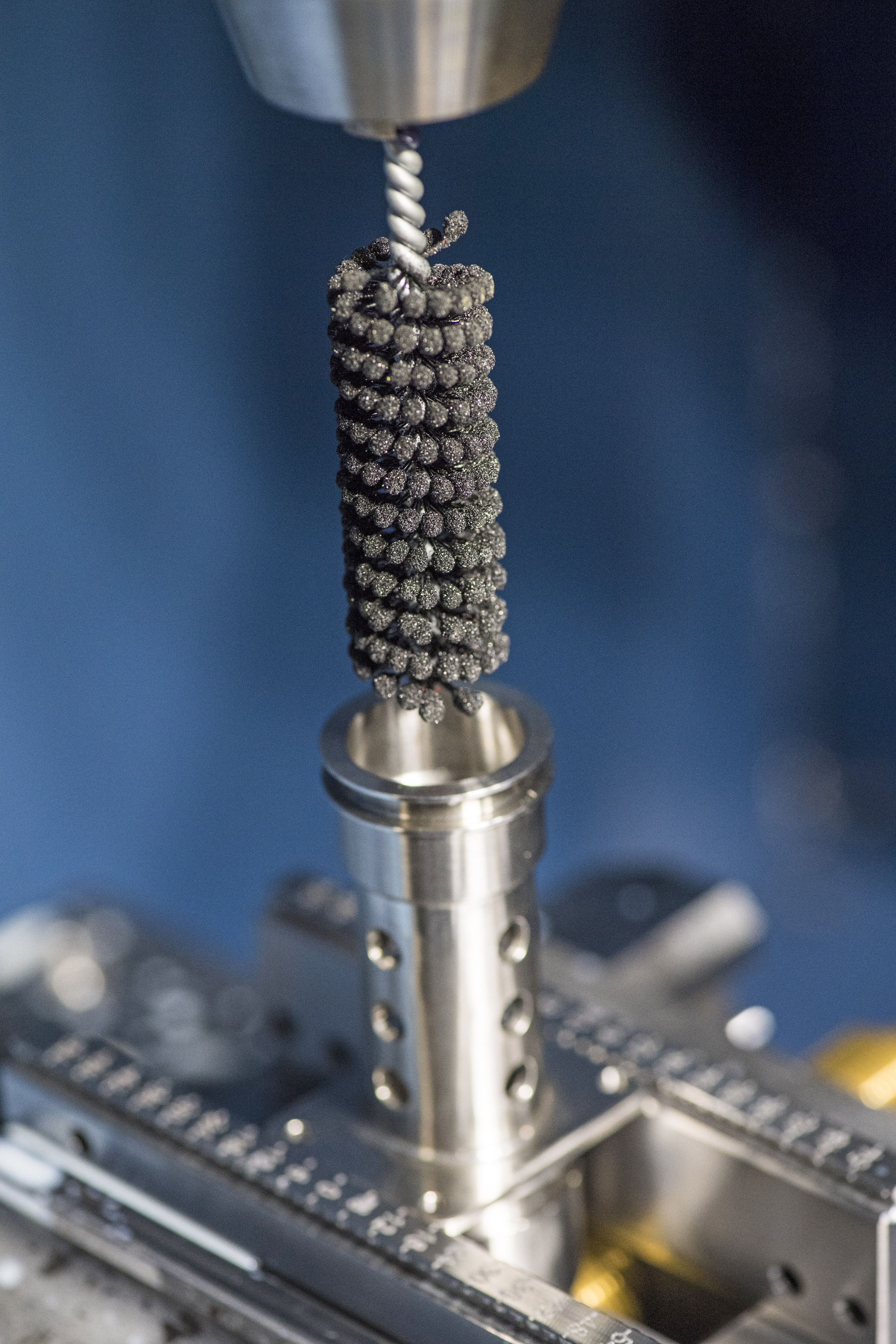

For many machine shops, a flexible hone is a much more efficient tool for overall surface finishing. The low-cost tool is often used for sophisticated surfacing, deburring, edge-blending and cleaning.
Until recently, however, flexible hones with CBN abrasive were only available by special order. Now, the company that invented the Flex-Hone tool, Brush Research Manufacturing, Los Angeles, offers CBN surface finishing solutions part of its standard product line.
Somewhat resembling a spinning bottlebrush, the Flex-Hone tool is characterized by abrasive globules that are permanently mounted to flexible filaments that are attached to a center shaft. With its low-pressure, low-temperature abrading process, BRM’s CBN Flex-Hone tools can remove workhardened layers and deburr parts without disturbing the underlying metallurgical structure.
Standard CBN Flex-Hone tools come in sizes ranging from 4mm to 20mm in three different mesh sizes: 170/200, 800, and 2500. Larger sized products from 22mm to 38mm and additional mesh sizes are available by special order.
Garaczi says he can see the advantage of being able to install a flexible hone into CNC equipment to automate the process and speed up the time when finishing superalloys and stainless steels.
