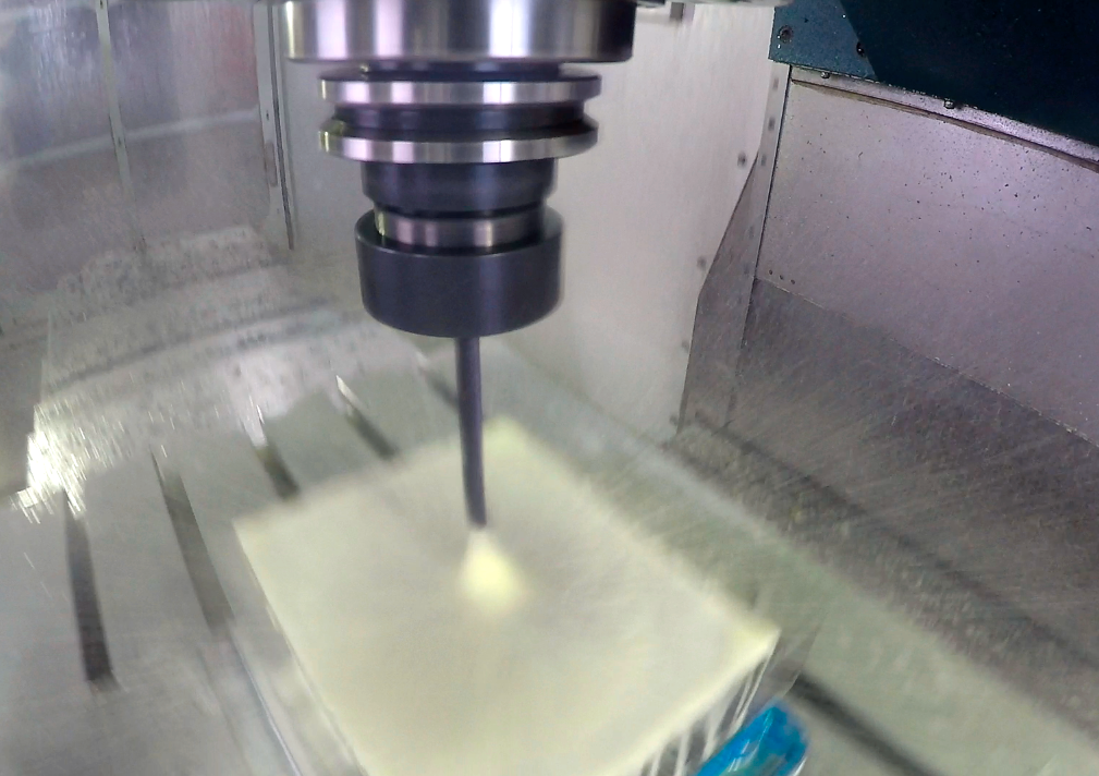

The ROMI D1000AP channels coolant through a high-speed carbide drill bit to flush out chips.

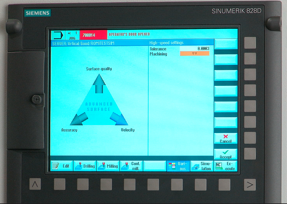

Among the advantages of the Siemens Sinumerik 828D control is the ability to produce a high quality part in the least amount of time. Surface quality, velocity and accuracy can be synergistically programmed to optimize machining motion using the
The Siemens Sinumerik 828D control can produce a high-quality part in the least amount of time. Surface quality, velocity, and accuracy can be synergistically programmed to optimize machining motion.
The ROMI D1000AP vertical machining center features integrated cooling during high-speed drilling. The coolant flows through the drill bit to flush the metal chips out and away from the flutes. Carbide drill bits last much longer and drilling cycles have been reduced from five minutes to thirty seconds.
Now the shop can drill a hole in one pass, rather than repeating up-and-down passes to clear metal chips from the hole and bit. “So the price for a tool may be quoted at twenty-five dollars for each of five holes,” Tim Rietsma explains. “Whatever the going rate, we can produce five of those holes in the time it used to take to produce one.”

An important discovery was the ability to program the machine to minimize the time it takes to cut a part. A feature called “Advance Surface” enables the shop to optimize mold-cutting velocity, accuracy, and surface quality for the most efficient machining motion. So for example, machine speed (velocity), can be reduced when the tool path requires the precise cutting of sharp corners (accuracy) and accelerated when machining through rough cuts to produce a part to the exact finish requirements (surface quality).
“It’s a feature that is over the top of any control I’ve ever seen,” Rietsma says. “With a couple of short clicks on the control, I can tell the machine that a particular block is not so fussy about tolerance. I can in effect say, ‘open the tolerance up’ and that will increase the speed of the machine through that sequence. We can get the surface finish that the mold requires and the maximum speed of the machine all at the same time.”
