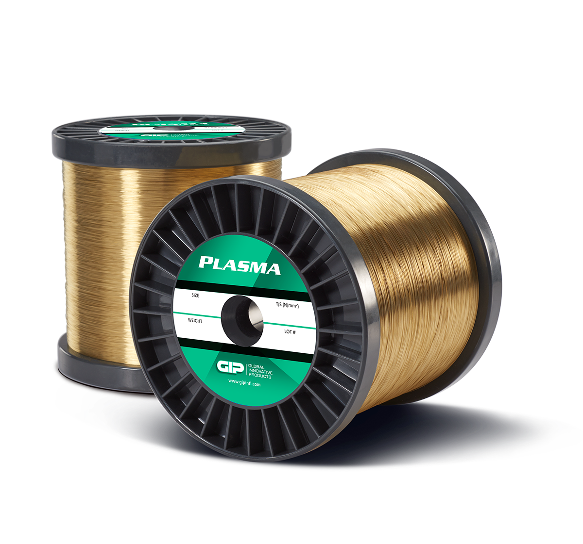

After extensive discussions with a local EDM supply distributor, a proprietary hybrid coated brass wire was presented to the Clippard director of operations, Robin Rutschilling, and his CNC/EDM programmer, Trevor McCoy, by Barry Ramsay of Global Innovative Products (GIP), a Mason, Ohio, supplier of consumables for EDM shops through the GIP distributor network, who also produces a variety of its own products for need-specific operations in EDMing. One such product is a Plasma hybrid coated brass wire, comprising of a gamma-phase intermetallic zinc alloy-coated wire with brass core. This GIP innovation had proven out in numerous lab testings but needed “real world” production validation. Ramsay and GIP application engineer Brad Hansard approached the team at Clippard.

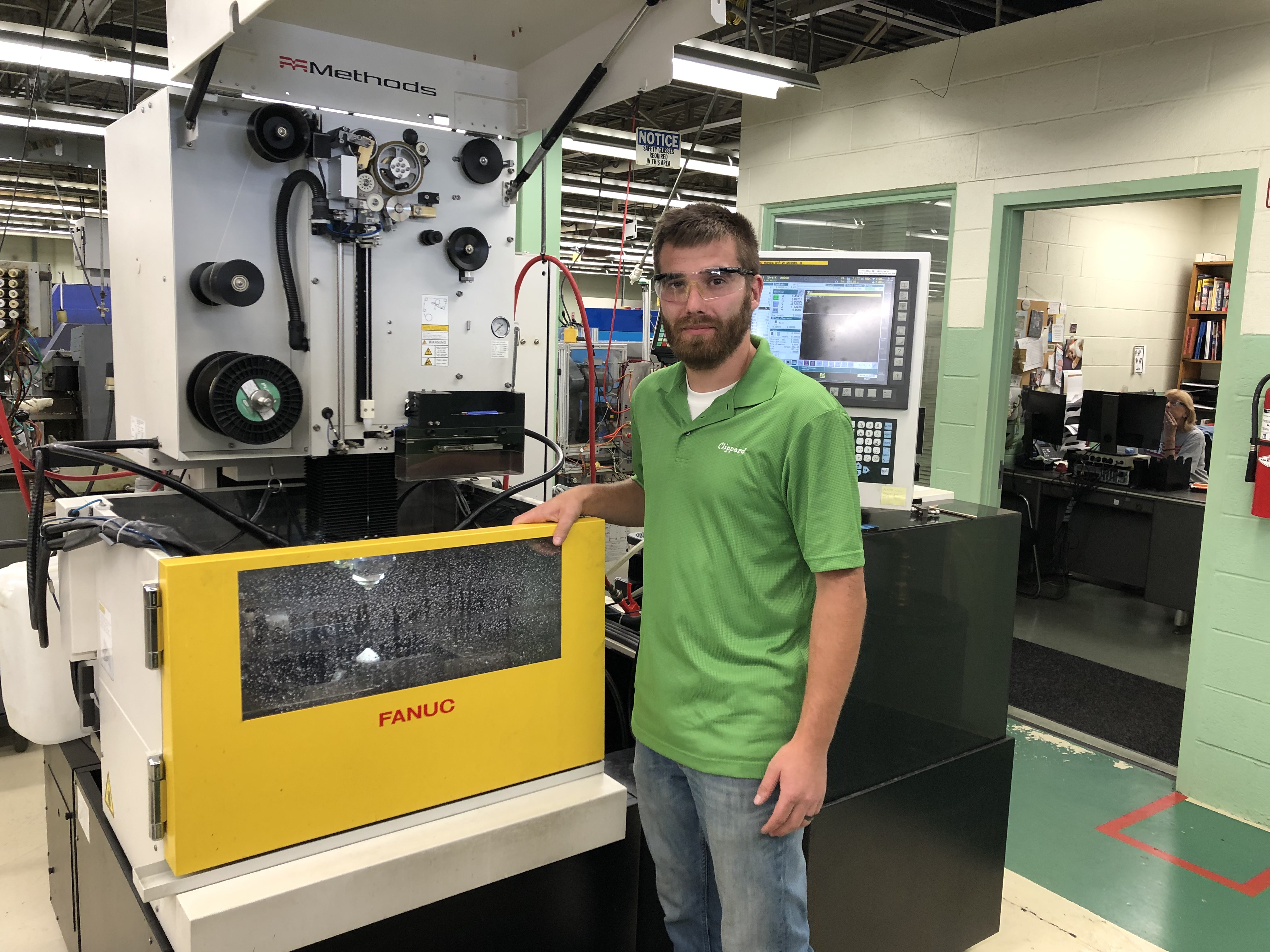

Trevor McCoy, CNC/EDM programmer at Clippard, runs a FANUC wire EDM with the GIP proprietary Plasma coated brass wire. McCoy states he achieves a finer finish with 15% to 20% improvement in run time. (Machine hood open only for photo purpose.)

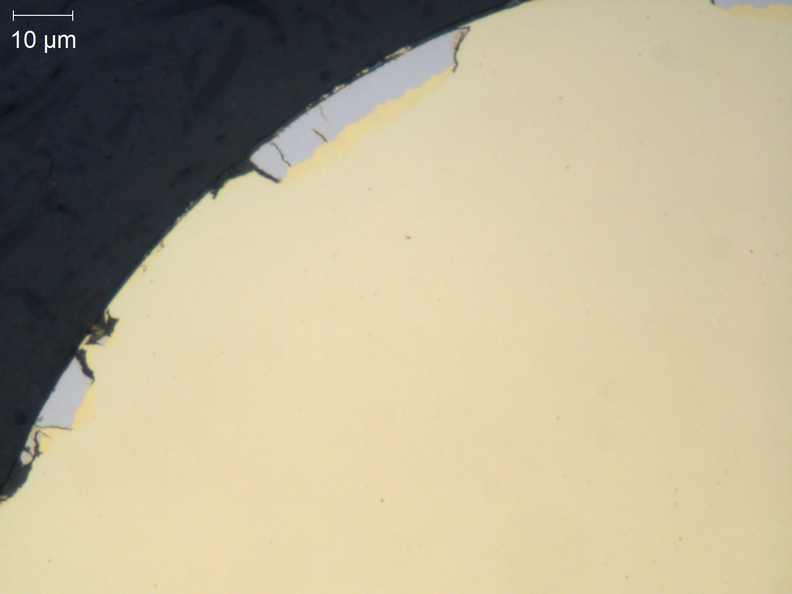

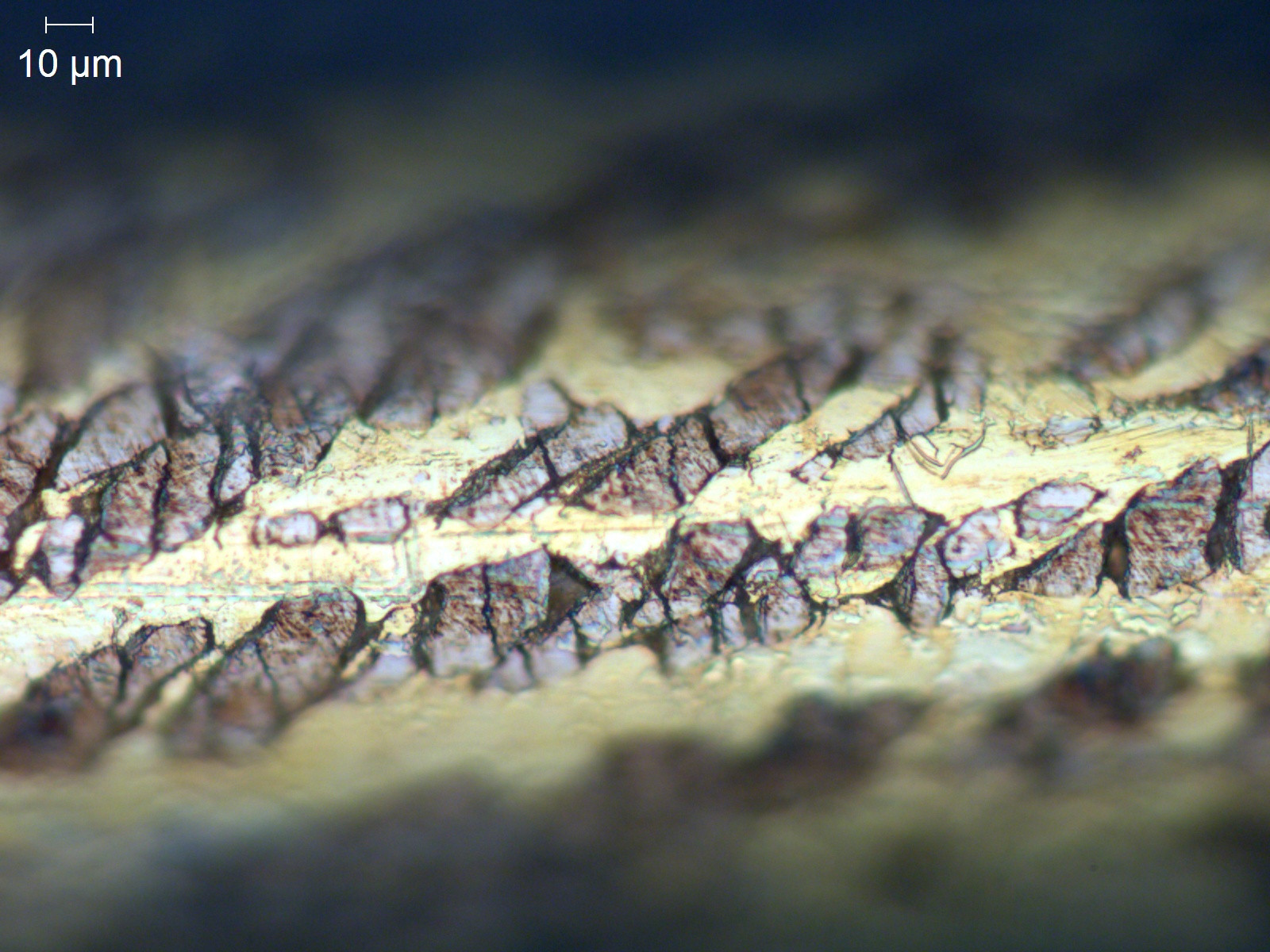

Gamma phase brass is a brittle intermetallic alloy (Cu5Zn8) with a high zinc content (approximately 65% Zn), which can also be synthesized by a diffusion anneal. However, when such coatings are wire drawn subsequent to the diffusion anneal, the coating will fracture due to its brittleness and redistribute around the wire circumference creating a discontinuous layer sometimes described as a “porous layer,” which promotes turbulent flow enhancing the flushing of debris. However, it is zinc enrichment created at the surface combined with the elevated melting point of CuZn gamma phase (approximately 800º C, or 1,472º F), which are the biggest factors contributing to the performance of gamma phase coated brass wire.

GIP offers Plasma hybrid coated brass wire.

The testing immediately yielded positive results, as McCoy noted Clippard was holding tolerances under a tenth, with a microfinish that was very important for the application. “We do a lot of custom work for our own use, over 50% of my production in EDM. Some of the hard tool steels are difficult to drill and we also run various others.The jobs require a lot of setup time and fixturing, so run time, finish and wire breaks all are critical for us.”

A cross section view of the Plasma coated brass EDM wire shows the discontinuous layering, caused by fracturing during the diffusion annealing process.

This surface formation actually enhances the flushing of the workpiece during machining.
