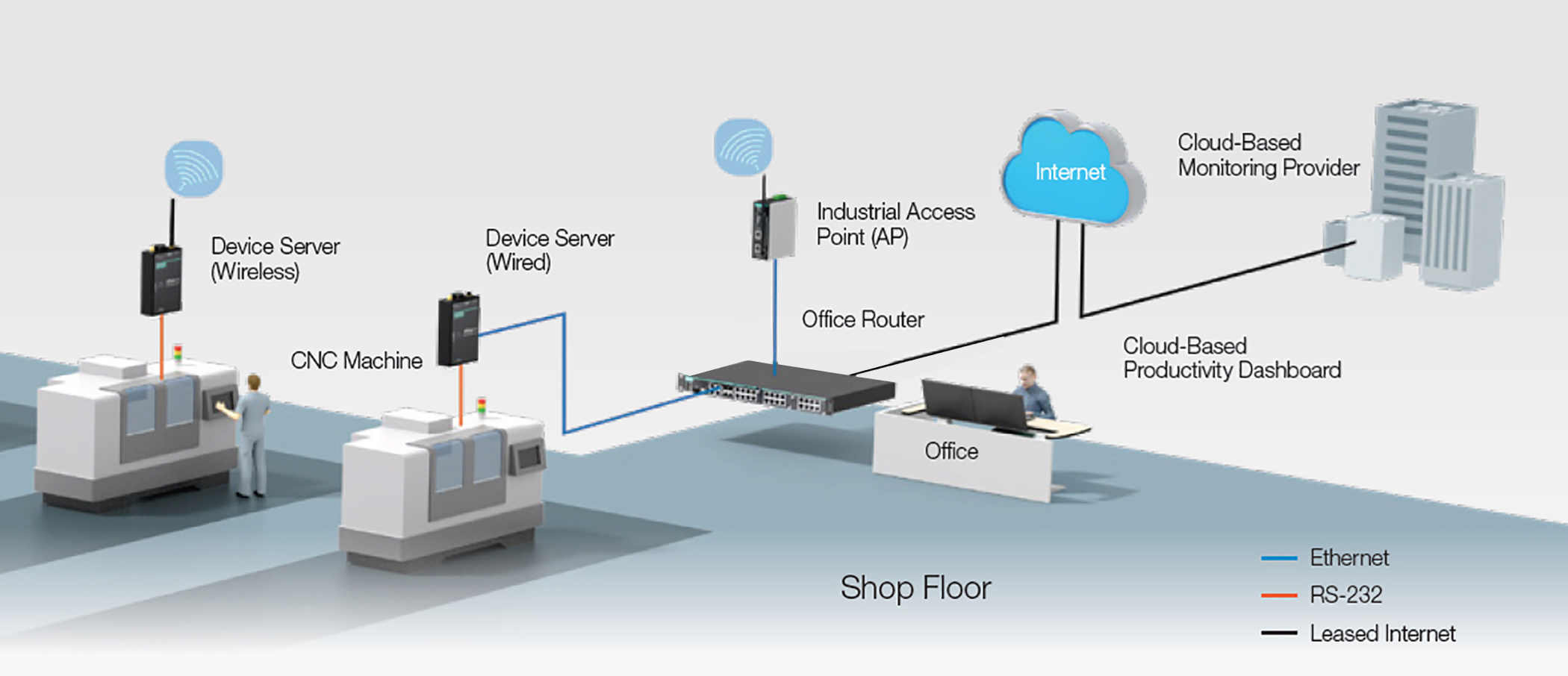

Tech Manufacturing selected Shop Floor Automations, one of the most prominent systems integrators in North America, to assist with a cloud-based CNC monitoring system. Each of Tech Manufacturing's CNC machines were connected to the existing local area network, so no additional IT infrastructure was required.
Tech Manufacturing production diagram

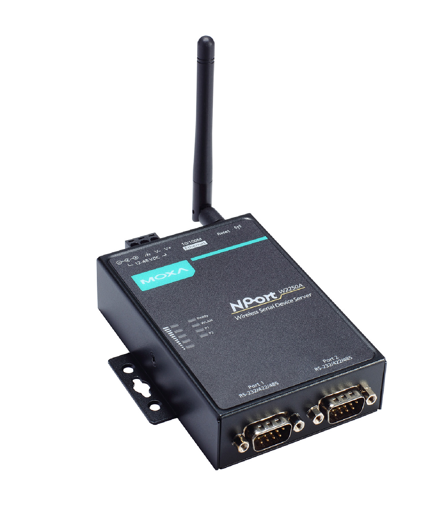

For legacy machines that did not have a readily available Ethernet port, Shop Floor Automations provided an easy-to-deploy solution that was developed based on Moxa NPort W2150A and W2250A wireless device servers that permit communications software to access serial and Ethernet devices over the wireless LAN. Being wireless the device servers required far fewer cables and lets users roam between several access points. As such, the servers offered an excellent solution for devices that are frequently moved from place to place, as is the case in many factory settings.

With the local network connected to the Internet, CNC machine performance data at Tech Manufacturing can now be viewed and analyzed by cloud-based software such as Scytec DataXchange or Predator Machine Data Collection. Key performance metrics are organized on a visual dashboard so the company's owners and machine operators are able to see exactly how productive each cell is performing, down to the machine level.

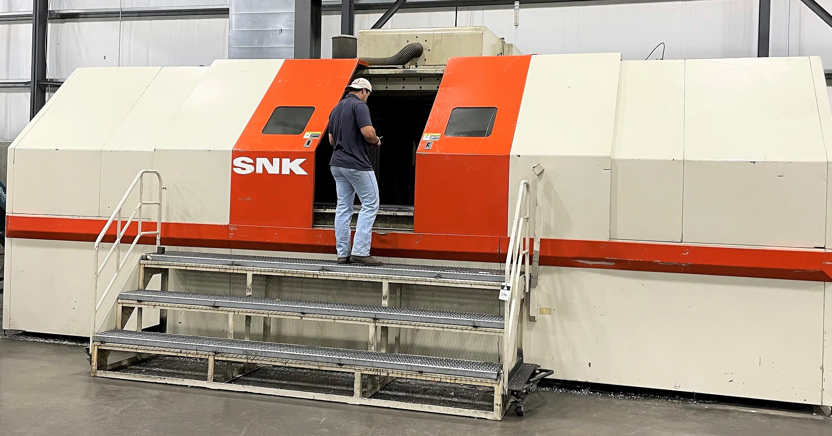

With the system now up and running, a live dashboard has made it easy for Tech Manufacturing to identify critical productivity issues. For example, one immediate finding was that set-up times on certain machines were unnecessarily long, leading to hours of lost productivity every day. By rearranging setup sequence and on/off times, Halley quickly achieved significant productivity gains with those machines.
