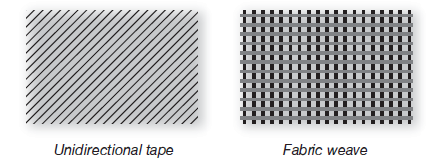

Composites can have unidirectional fiber layout, or bidirectional weave.

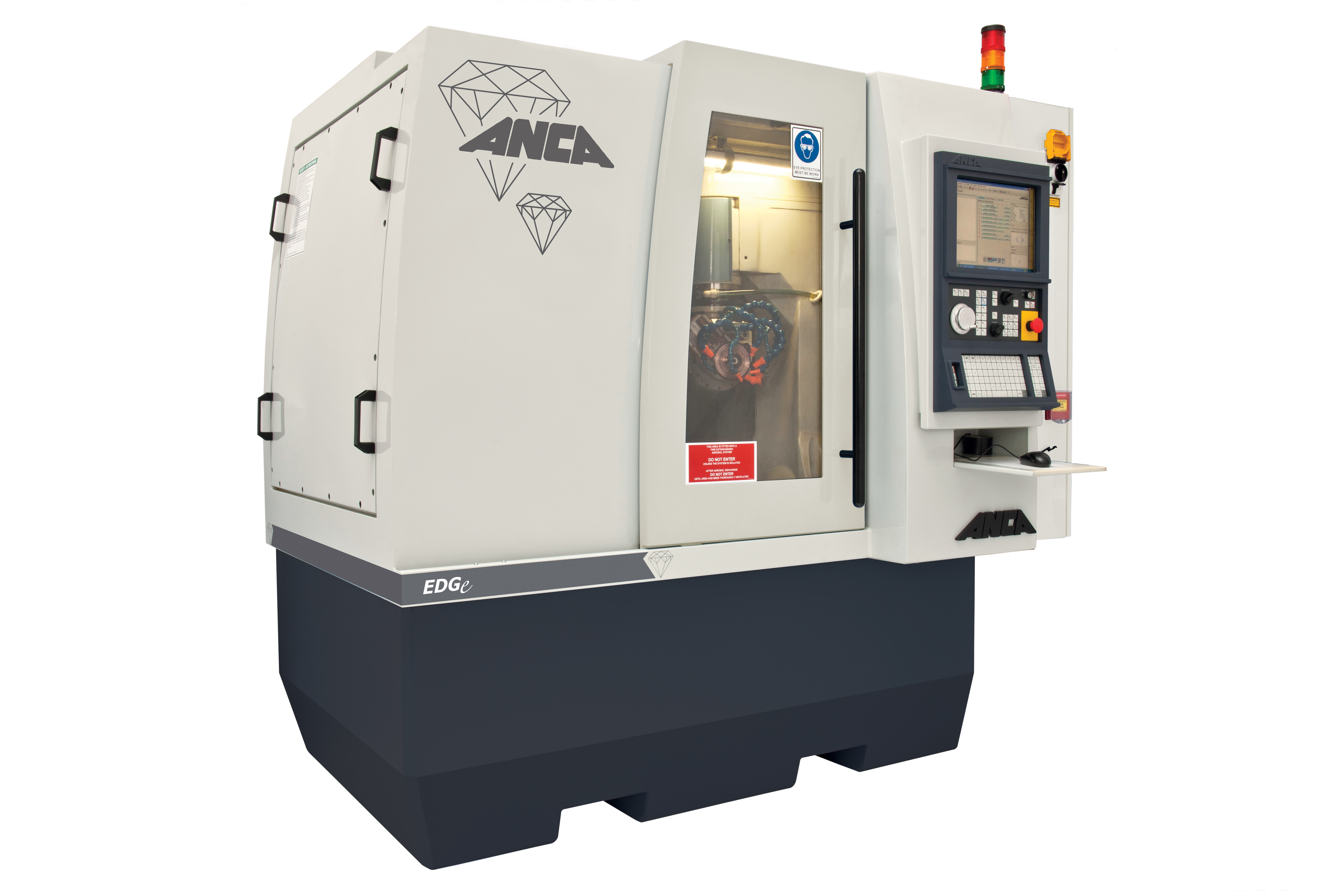

An ANCA EDGe machine used for PCD tool erosion.

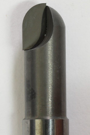

PCD insert brazed onto a carbide tool base. EDGe erosion process is used to generate an accurate corner radius profile.
This typically will give a keener cutting edge than CVD coated tools and additionally can be resharpened, which extends the usable life of the tool. Within PCD tools, there are three common forms. First, they can be a carbide base with brazed PCD inserts giving a shear cutting edge. This type of tool is commonly used to produce complex step or profile tools and is most easily produced by tool manufacturers looking to enter the PCD tool market.

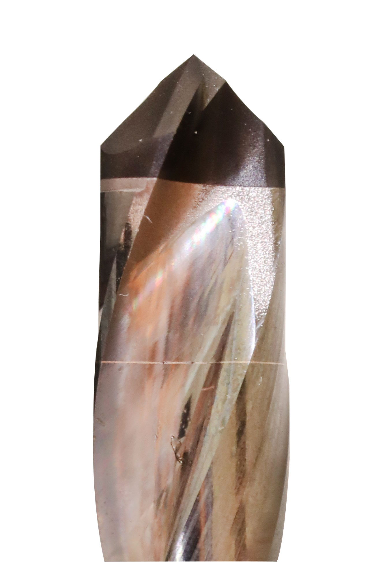

PCD vein is co-sintered with carbide, allowing generation of a helical cutting edge.
The next alternative is the veined PCD technology, initially developed in house by Sandvik Coromant Spanish Fork. This can create a helical vein of PCD, co-sintered in the carbide blank. The helical cutting edge is seen to offer an enhanced cutting geometry compared to that of a shear tool, and coolant holes can be included through the carbide portion, which improves cutting conditions. For these tools, the cutting edge geometry is largely defined by the PCD vein that was sintered.

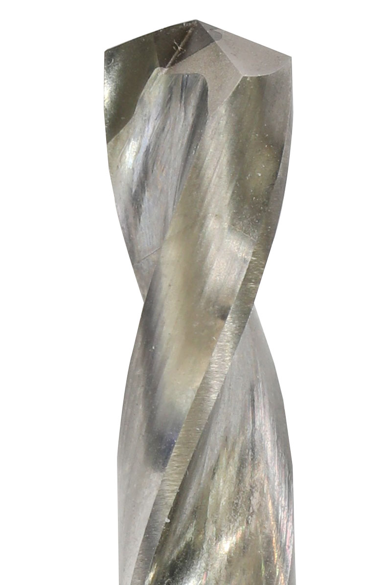

The answer to this challenge is typically a solid PCD tip with a carbide body. While these can be expensive up front, RobbJack, based in California, produces such tools using rotary electro erosion process on the ANCA EDGe. This allows complete freedom for producing any tool (drill) geometry they require.
Solid PCD-tipped drills offer maximum flexibility in drill geometry for CFRP.
Hole Drilling CFRP
Hole drilling is a commonly performed operation necessary to allow joining of CFRP structures. CFRP drills will have a point geometry distinct to that of metalcutting drills. ANCA's Toolroom software, whether applied to grinding or PCD erosion processes, allows creation of various special drill points suited to CFRP, including compound point angles and brad or W-point geometry. Specialized drill points result in minimised delamination as the drill penetrates through the CFRP layer, maintaining hole geometry (roundness) and offering superior tool life.

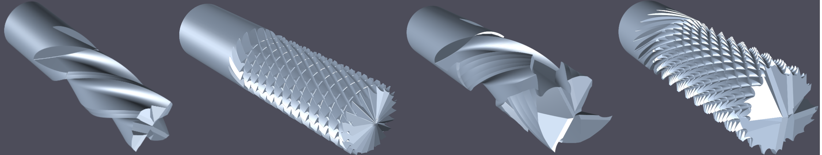

Another common cutting operation is trimming or cutting of CFRP with specialised milling cutters. Again, coated carbide or PCD cutters are the order of the day.

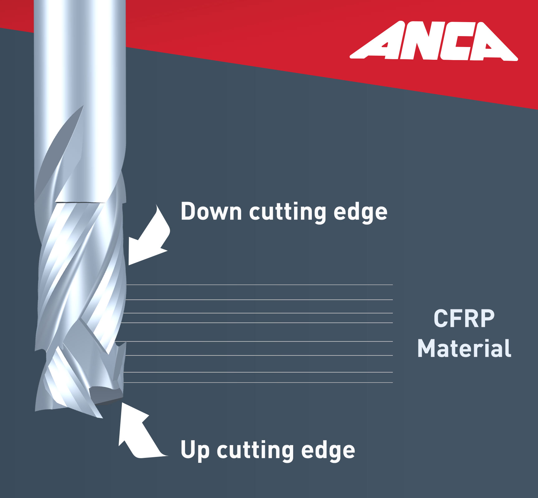

For trimming or edge cuts, up-down cutters are most commonly used. The opposing direction of the cutting edges ensures cutting forces are toward the middle of the CFRP layer, thereby reducing the likelihood of delamination. Shallow flute depth helps increase tool rigidity.
Compression cutters minimize damage to the CFRP cut edge with cutting forces toward the center of the CFRP layers.
Burr style routers feature many shallow flutes that have chipbreaker teeth included on them. This form of cutter works to produce localized cutting forces that can effectively shear the fibers.
ANCA grinders support the manufacture of these types of tools with dedicated compression router or burr cutter software packages.
For surface or pocket milling, down-cut endmills again will create downward cutting forces that minimize surface delamination. Brazed PCD routers are also common for this application with ball or corner radius cutting edge forms, which are easily produced on the ANCA EDGe.

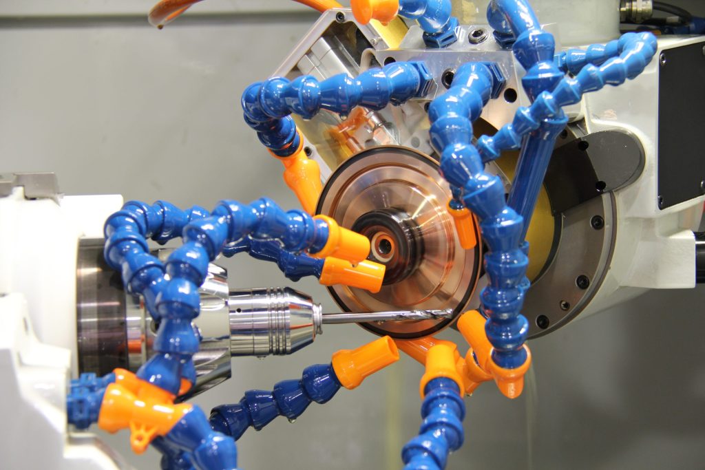

ANCA EDGe machine eroding a veined PCD drill from Sandvik Coromant.
