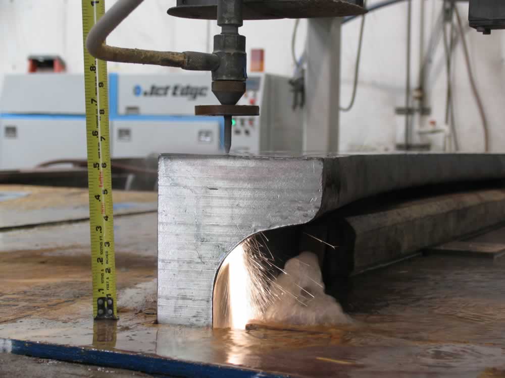

Draper added that if a waterjet machine will be cutting 4 hours per day on a consistent basis, it makes sense to bring the operation in-house. However, the cost of the equipment isn’t the only consideration. A parts manufacturer also need the space to place a waterjet machine or face the added expense of expanding the existing facility.
In addition, abrasive waterjetting is a “dirty operation” that creates a large quantity of dust, so if a company, such as a medical device manufacturer, must maintain a fairly clean or even clean-room environment, creating a separate waterjet room or new facility will extent the payback, he said.
Draper said RMW is seeing an increase in waterjetting business, even though the company has expanded into fiber laser cutting, which is an alternative to waterjetting for certain applications. A waterjet, however, can cut virtually any material, with the exception of high-tempered glass, while lasers are more restricted. Although a waterjet can cut ceramic and some other very hard materials, it takes too long to be cost-effective.
