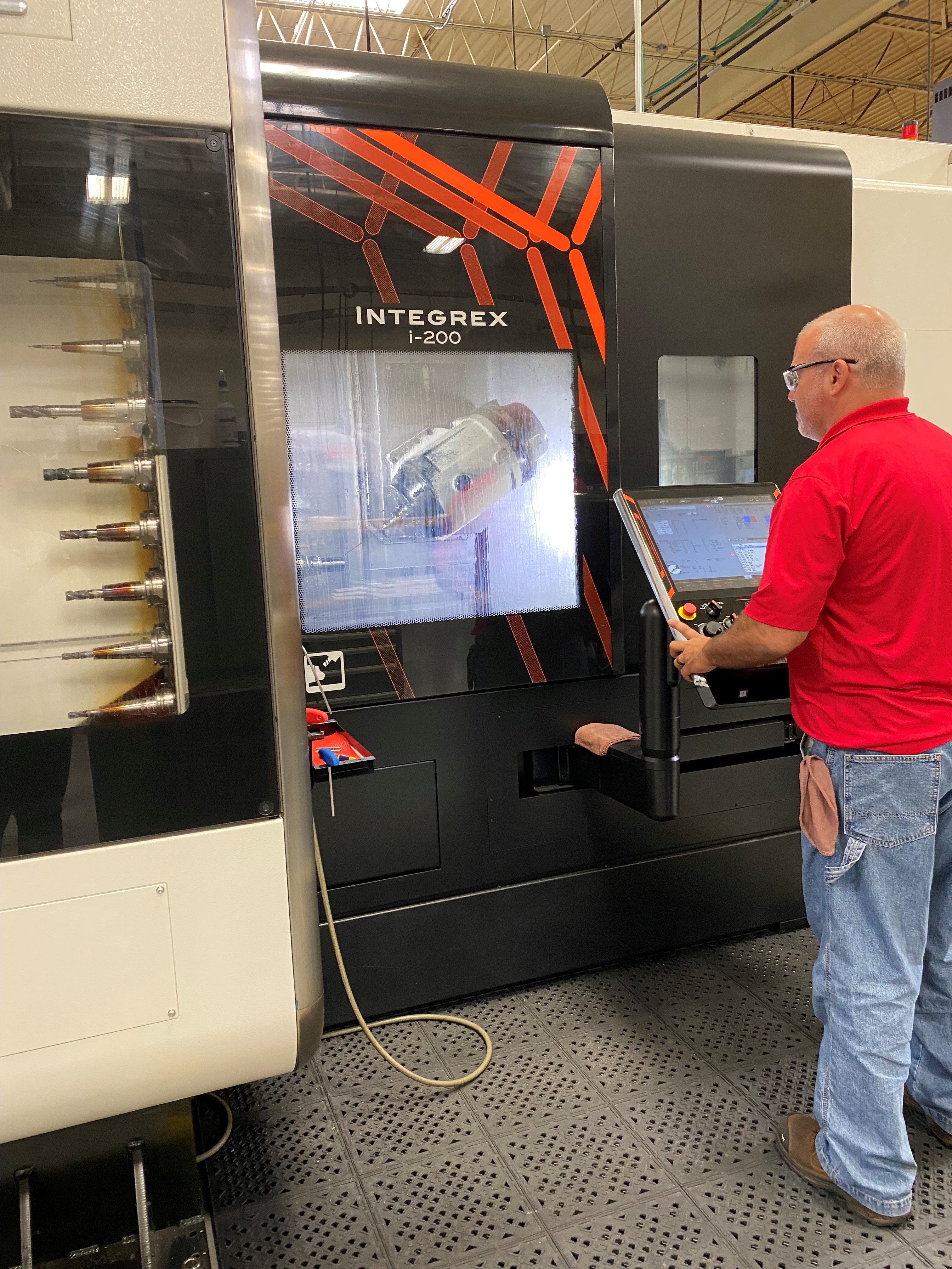

When cool, the drill was sent back to the CNC department for finish turning, milling of the insert pockets, and then heat-treated to the desired hardness. This was followed by cylindrical grinding of the shank and some additional machining operations on the drill’s front end to make the insert pockets perfectly true. As Cahn stated, it was a lengthy process, but has since been streamlined somewhat by the addition of some very advanced machining technology—an Integrex multitasking center from Mazak.
Taking the next step
“When Ceratizit USA invested in its first mill-turn machines around seven years ago, I volunteered to move over to that department, because up until that time I’d spent my entire career almost entirely in the milling area,” he said. “It turns out that was a very good decision that they purchased the Integrex and offered me that position due to my experience with live-tool lathes. That’s what I’ve been doing for the past three years.”

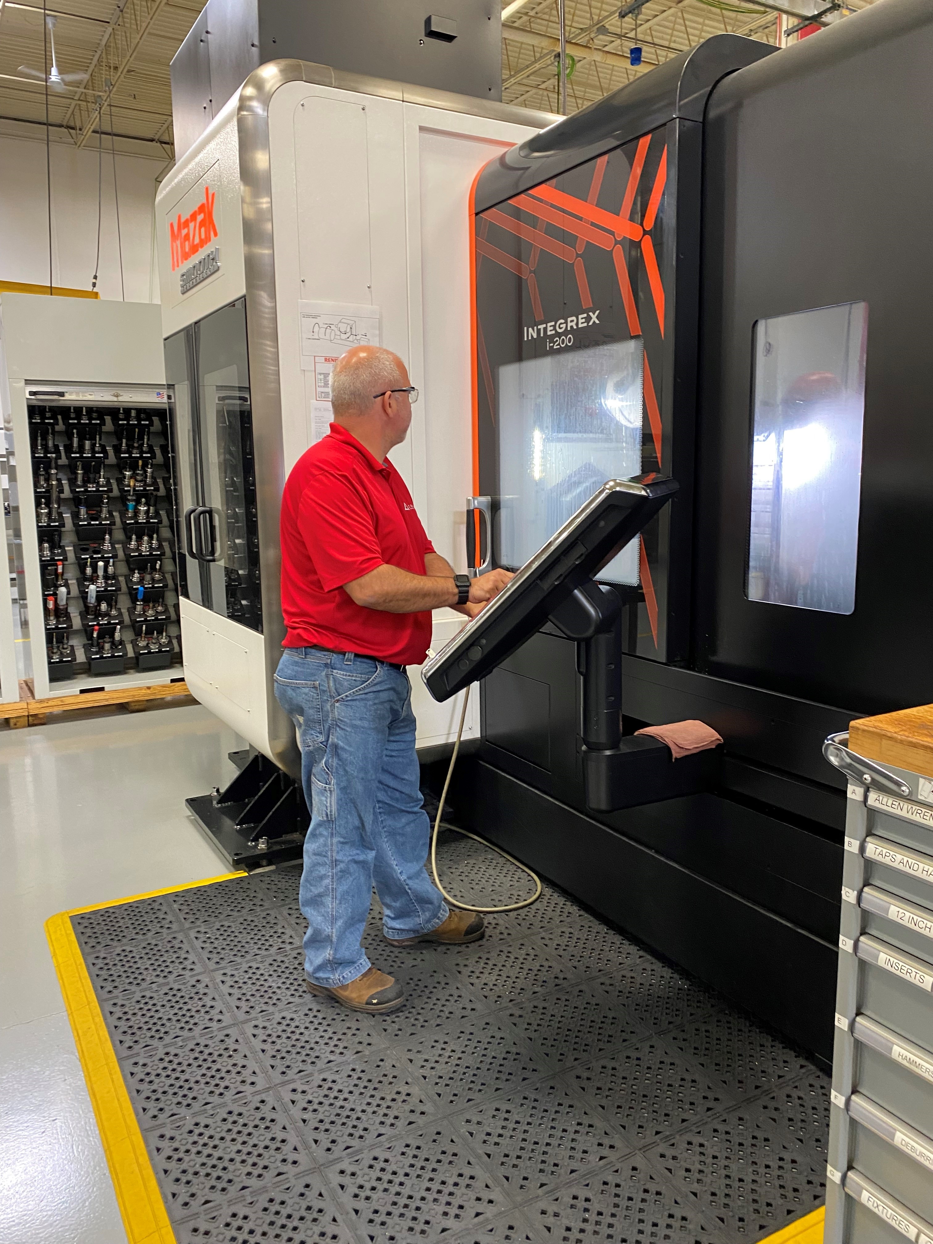

Cahn now enjoys the title of lead CNC machinist for 5-axis. He said he enjoys working with the Integrex, and using it finds the manufacturing process for KUB Trigon drills is far shorter than it once was. The blanks are machined in Germany, heat-treated and ground, then delivered to the Integrex for final machining. Here, a RoboJob six-axis robot loads and unloads parts all day from a pair of pallets, freeing Cahn for more important work than machine tending.
Continuing the indexable insert legacy image“With 110 tools resident in the magazine, all I have to do on most jobs is pop in the fixture, run a probing routine to pick up work offsets, and push cycle start,” he said. “Setup times have dropped to maybe half an hour, whereas they were taking hours previously. On top of that, I expect that the Integrex and some of the other equipment will be running lights-out fairly soon. Considering Industry 4.0 and all the other technology that’s available today, that’s where manufacturing is headed.”
