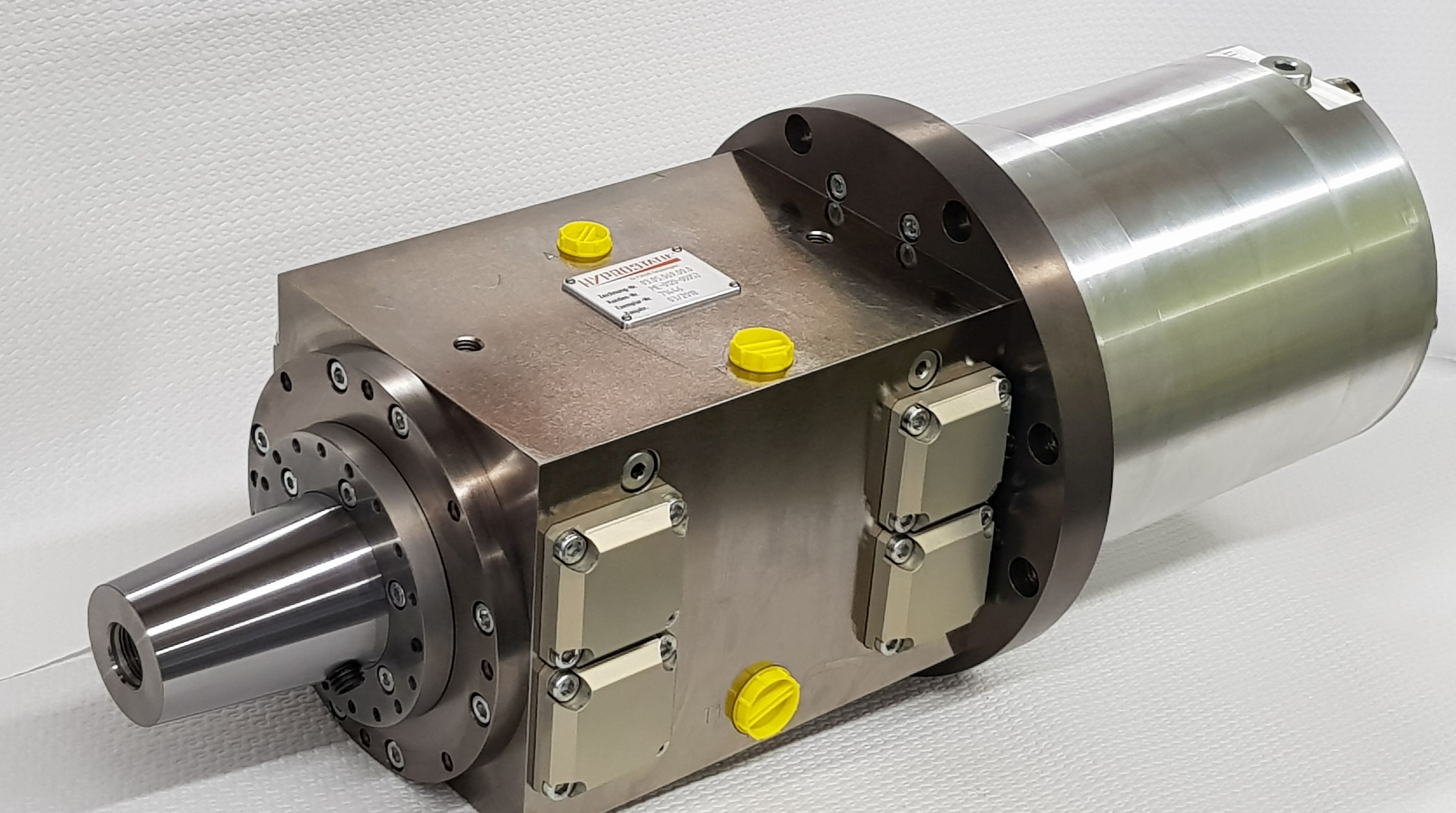

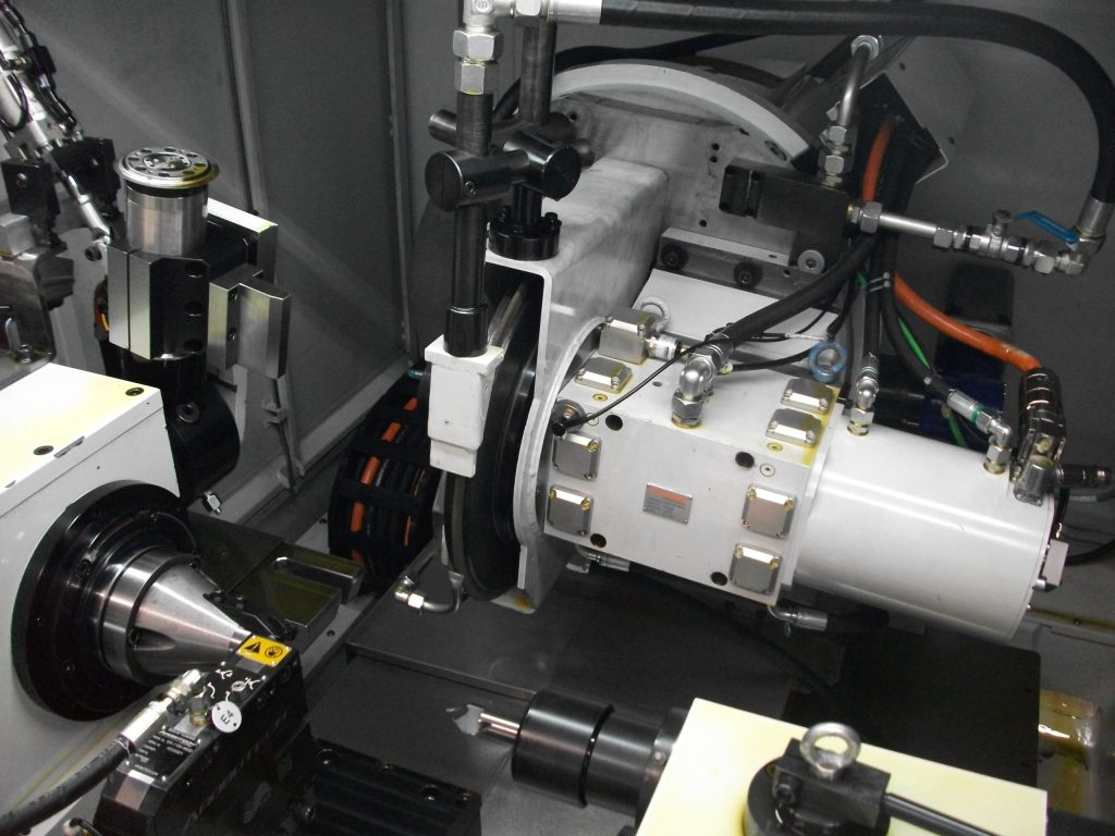

Best surfaces with high concentricity
high precision grinding spindles
Top: Hydrostatic motor grinding spindle from Hyprostatik for producing mirror finish surfaces. Above: Ultra-precise surfaces require high precision grinding spindles. Photo: Hyprostatk
When grinding, the best surface finishes are achieved if the tips of the abrasive particles rotate in an absolutely true circle both while dressing and while grinding.
To achieve this, a concentricity in the region of 0.1 µm, with high rigidity, perfect balancing, and excellent damping is required. This performance cannot be achieved with conventional roller-bearing spindles. The concentricity error of roller bearing spindles varies over a range of 2 to 5 µm; in rare cases 1 µm. Furthermore, these are damped to only a limited degree. As the period of use increases, the quality of the concentricity of conventional roller-bearing spindles deteriorates.
With hydrostatic high-precision motor grinding spindles from Hyprostatik Schönfeld GmbH (Göppingen), concentricities of < 0.1 µm over the entire range of speed are guaranteed.
For this, hydrostatic spindle bearings have damping some 100 times greater than spindles in roller bearings. To achieve optimized damping parameters, Hyprostatik Schönfeld works with proprietary software.
Finely balanced spindle bearings
The spindle bearings are very finely balanced, with a balancing quality of G 0.1. The lowest balancing quality according to DIN ISO 1940 is G 0.4.
In addition, as the spindle suspension is not damped, the radial flexibility is very low, which means the optimal damping of the hydrostatic bearings has maximum effect.

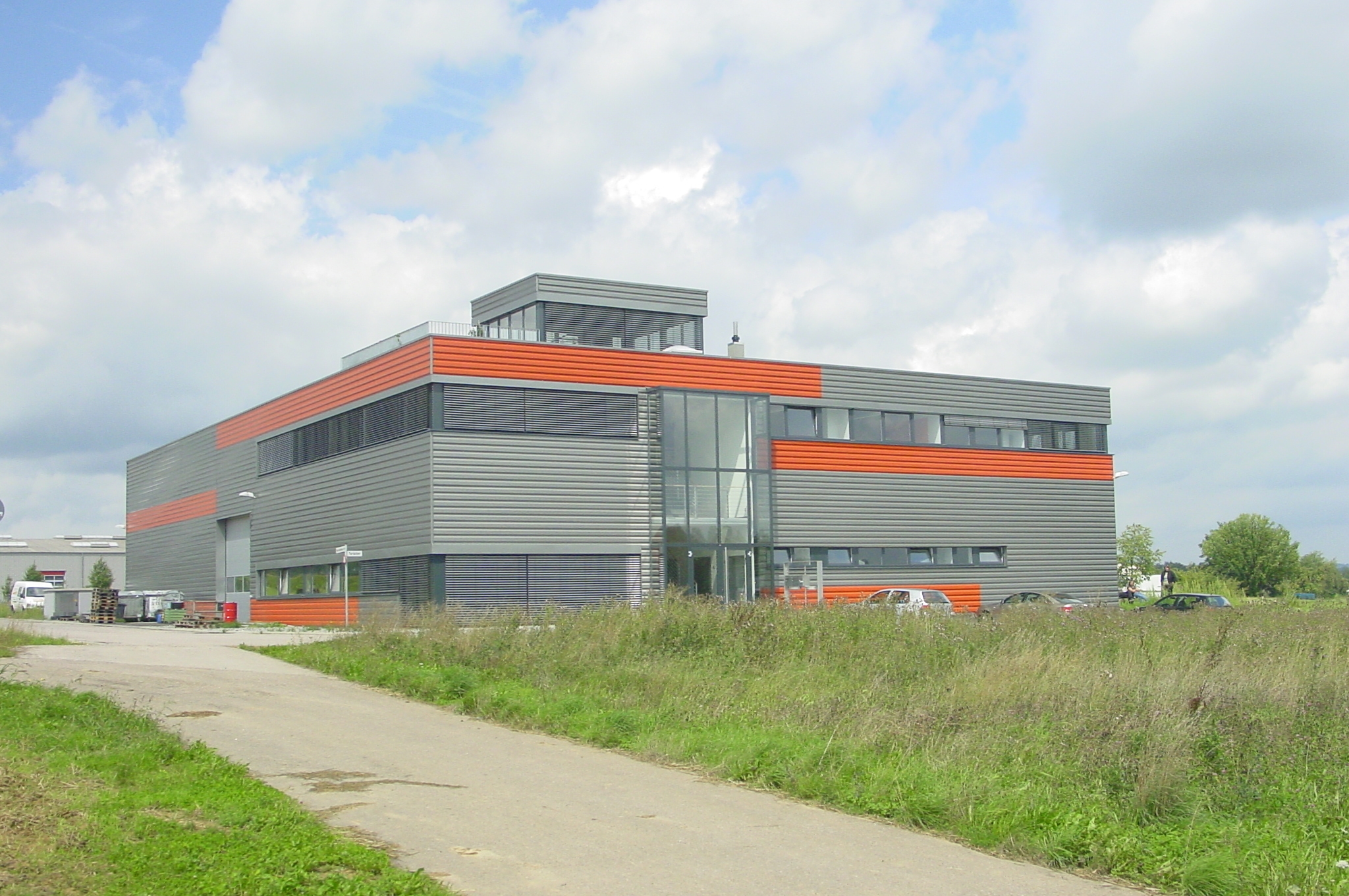

Hyprostatik Schönfeld GmbH in Göppingen-Jebenhausen (Germany).
Hyprostatik Schönfeld GmbH in Göppingen-Jebenhausen (Germany). Since August 2022, the company has been part of the Schunk Group. Hyprostatik's product range includes lead screws with hydrostatic nuts, guide shoes, tailstocks, spindle bearings, and rotary tables in different sizes and designs.

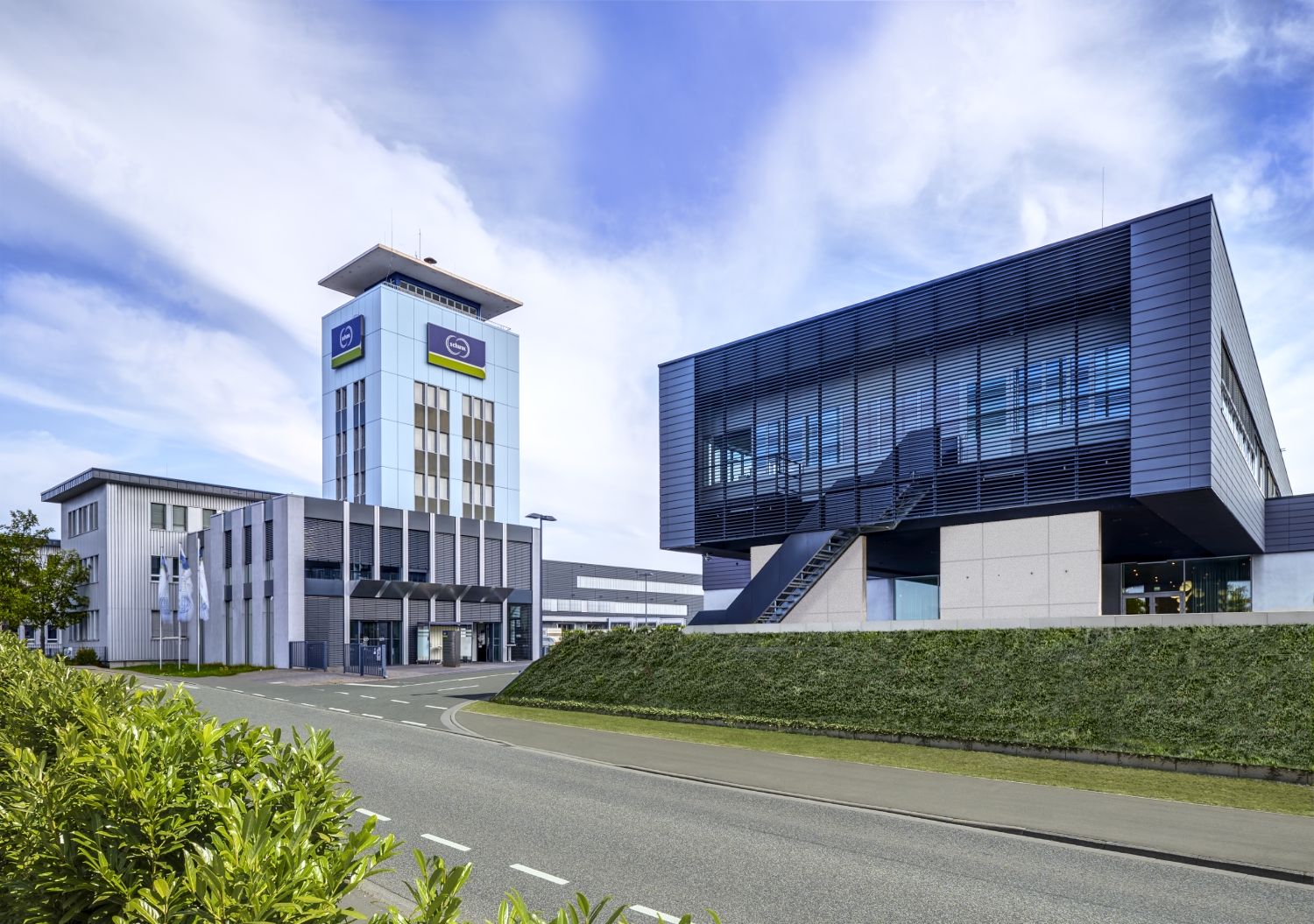

Schunk Group
The Schunk Group is a global technology company. The company is a leading supplier of products made of high-tech materials – such as carbon, technical ceramics and sintered metal – as well as machines and systems.
