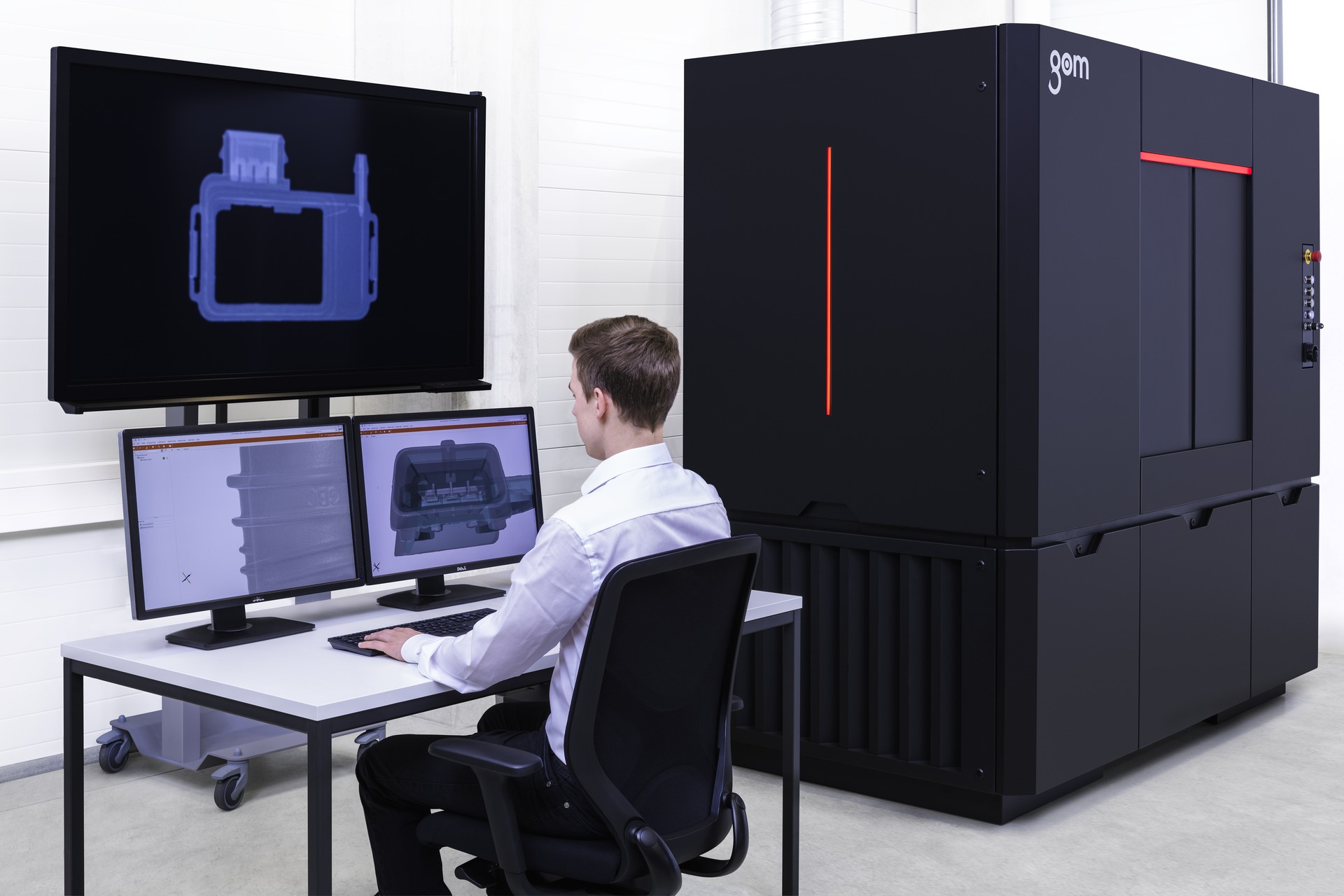

CT scanning machines need significant shielding to protect operators from X-ray exposure. Photo credit: Exact Metrology
CT scanning machines need significant shielding to protect operators from X-ray exposure. Courtesy of Exact Metrology.
