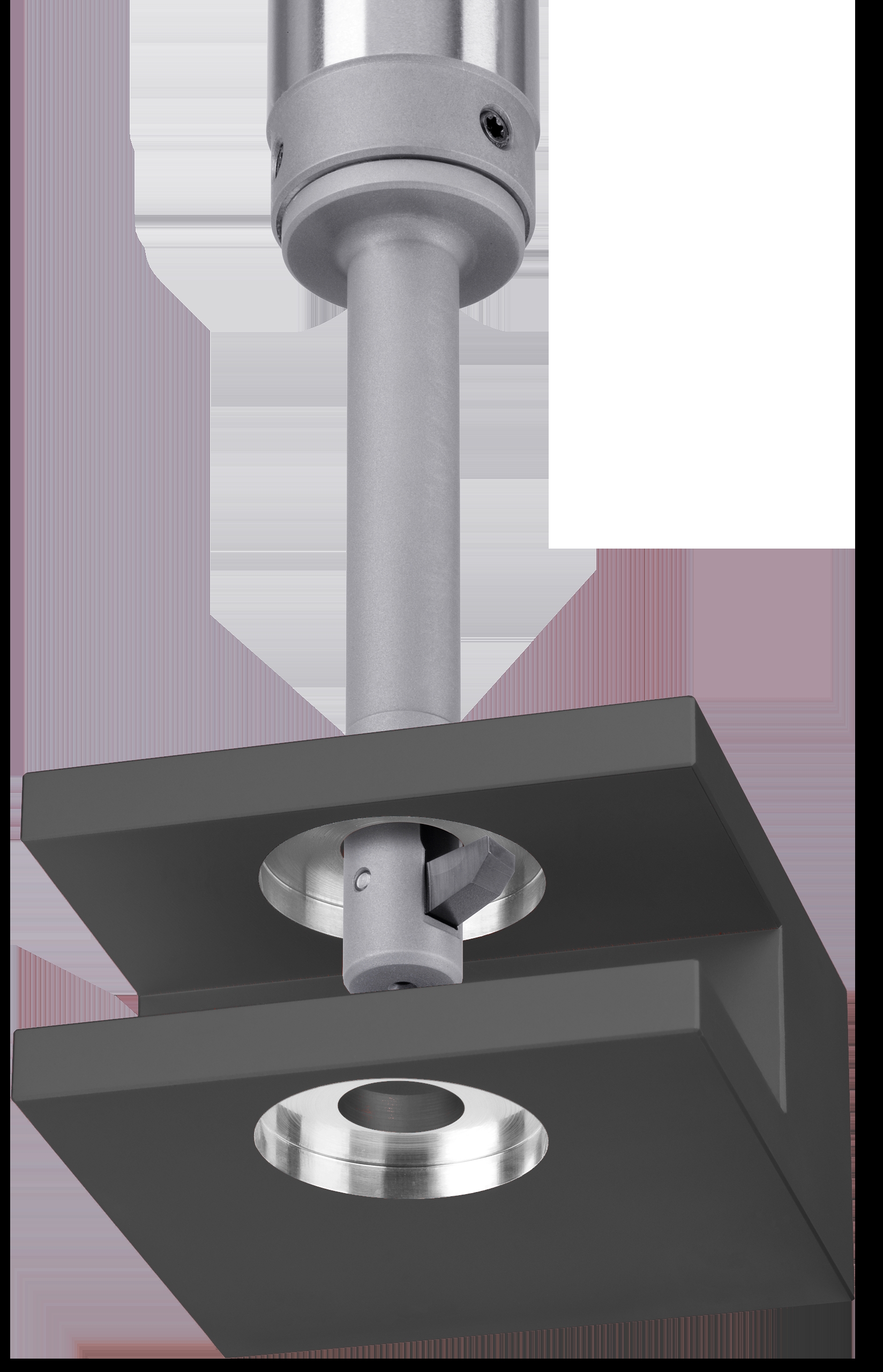

Custom tooling solution solves legacy part challenges imageThe Heule back spot-facing tool reached through a 0.257-inch hole and cut a clean 0.520-inch flat on the far side of the part. The work was done in a very tight spot.“>

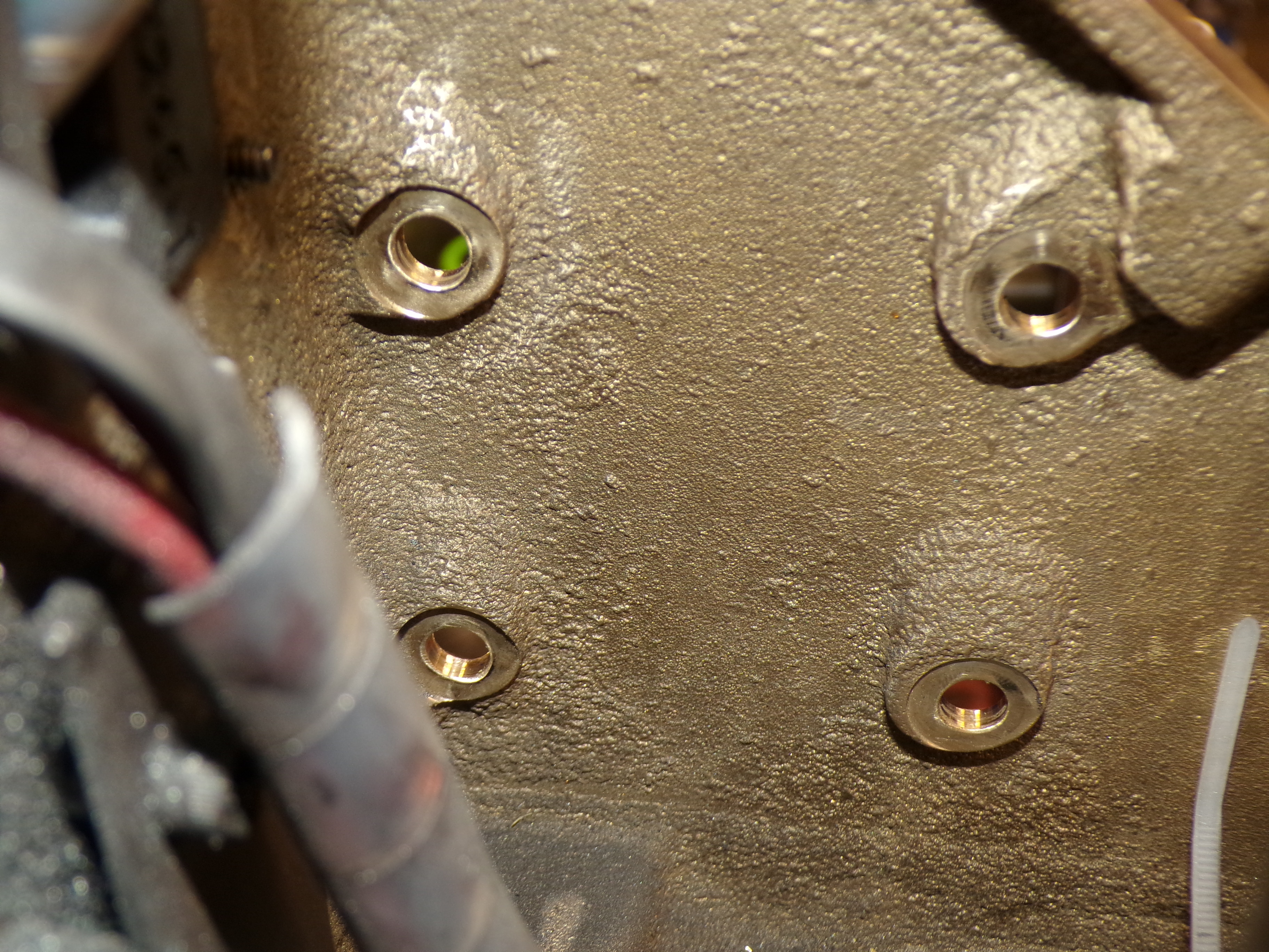

All Tri-Tec’s parts must meet the Navy’s performance and durability standards. The actuator housing being prototyped in this case was made from manganese bronze (C86300). Inside the casting, four raised mounting pads needed to be machined with smooth, flat surfaces to support a transformer. These back spot faces needed to be cut from inside the housing, through a 0.257-inch access hole, to a finished diameter of 0.520 inches. One face was right up against a raised boss, creating an interrupted cut and leaving little room to work.
In the past, Tri-Tec used a similar indexable back spot-facing tool for this type of work. The tool had a small shank that could pass through a hole and expand to cut on the far side. It was a setup that had worked for years, but the insert line was discontinued by the manufacturer. Even if it had still functioned, the tool’s limited diameter range wouldn’t have worked for the larger spot facing they needed.

Smith worked with Matt Clark of Clark Manufacturers, Heule’s local representative, to evaluate the part’s geometry and cutting requirements. Together, they selected the Heule back spot-facing tool (BSF-A-0650/040-7.0) that could reach through the 0.257-inch hole and cut a clean 0.520-inch flat on the far side of the part. No additional fixturing was needed to use the BSF tools.
The only process change, compared to the obsolete tool, was to rough drill the through hole to match the BSF tool, then open it up to final size after the BSF tool cut the part. Heule tools feature retractable cutter mechanisms, so the blade expands inside the part and retracts after the cut is complete.
This eliminates the need for custom fixturing or multi-step setups while preserving accuracy and surface quality. The interrupted cut path caused by the raised boss required some adjustments. Smith said the team tuned their feeds and speeds to stabilize the tool path in order to complete the cuts successfully.
“It proved to be problematic just because of the nature of the casting and the interruption, but once we dialed in on what we were doing there, it worked flawlessly,” he said.
