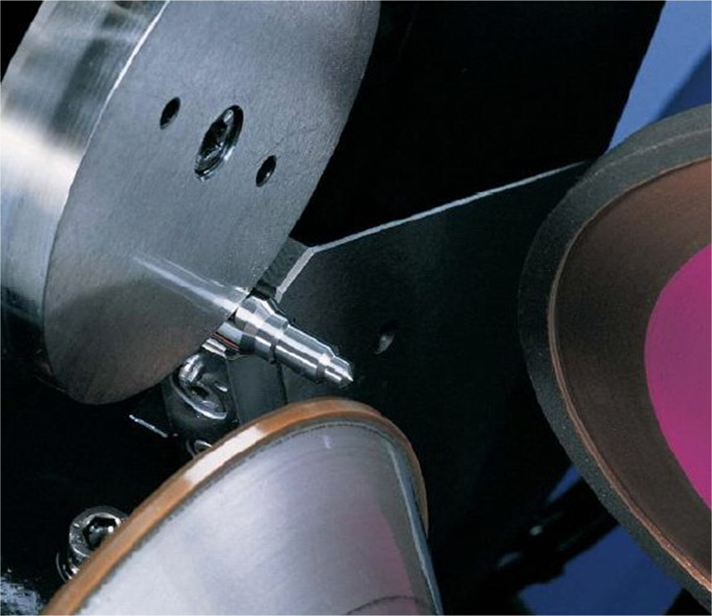

In pinch grinding, the blank simultaneously passes through two opposing wheels: a roughing wheel and a finishing wheel. All images courtesy Norton | Saint-Gobain.

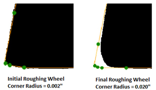

A roughing wheel’s corner before and after pinch grinding.

To excel in a competitive industry and in response to marketplace demands, Rollomatic has patented pinch grinding using its ShapeSmart grinders to reduce the number of operations required in blank preparation and to reduce lead times. Pinch grinding is a variation of peel grinding, which refers to high-speed cylindrical grinding of rotating blanks. In pinch grinding, however, the blank simultaneously passes through two opposing wheels: a roughing wheel and a finishing wheel.
With a setup of opposing grinding wheels, a V-block steady rest placed underneath the piece and a steel roller on top, aggressive material-removal rates can be achieved while maintaining excellent part concentricity or low part runout or both. This technology has become a game changer when preparing cutting tool blanks.
This variation in blank preparation has brought several benefits and new factors to keep an eye out for during grinding, including the demand for improved roughing wheel corner retention and optimal wheel and blank speed ratios.
In pinch grinding, the roughing and finishing wheels grind parts simultaneously, with the finishing wheel trailing the roughing wheel. This means that both operations are performed at the same traverse rate. Because the depth of cut (DOC) for both roughing and finishing are preset, any material that is not removed by the roughing wheel is “picked up” and cleaned by the finishing wheel behind it. This happens as a result of wheel corner breakdown and radius loss experienced by the roughing wheel. For example, Image 3 shows the corner of a roughing wheel before and after grinding a few hundred blanks.
Finishing wheels for pinch grinding generally have grit sizes from 800 to 1,200 grit. This is an average particle diamond size of 5µm (0.0002″). For this particular part, the DOC set for the finishing wheel was approximately 0.002″ radially. The wheel corner breakdown experienced by the roughing wheel caused the actual DOC for the finishing wheel to be much greater than the expected 0.002″—”invisible” work to the operator’s eye. Doubling the amount of work of the finishing wheel will generate a significantly higher force per grit in the finishing wheel. This will result in excessive heat generation, causing the finishing wheel to lose its form due to bond deformation.
