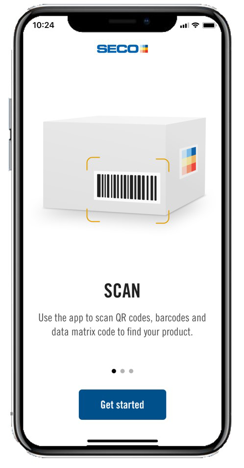

The Seco Assistant app.When Jan Gravningsbråten came up with an idea for how to reduce waste in the tool production process, little did he realize the potential effect it could have on the Seco business. Several years later, his idea has the ability to track ten billion tools that in turn can generate huge amount of insight into how our products are used, the company said.

The codes are also compatible with the Seco Assistant, an app that allows users to make calculations and scan their tools directly to find out more about them. “Ideally, clients would input data about how they use the tool into the system – what machine they use, when it is installed, how long it is used for and for what purpose. Scanning the codes on the tool would then bring up all that data, which basically is the life story of the tool,” said Micael Baudin, specialist in digitalization at Seco Tools.
