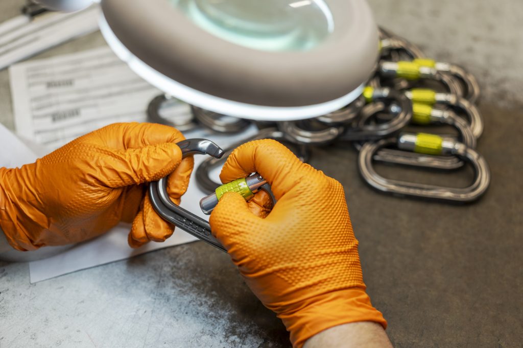

Rösler’s plastic finishing media delivers improved control and repeatability forDMM, a leading Welsh manufacturer of climbing and professional safety equipment.
What began as a consumables evaluation became a broader process-optimisation exercise, with the focus on achieving the right finish more consistently and in a commercially sensible cycle time. The resulting gains have been tangible: a better finish alongside materially lower media consumption and shorter processing times.
For DMM, the significance is therefore not simply that one consumable has replaced another. It is that the finishing process as a whole is now working harder for the business.
“For us, it’s about getting a consistent finish on the parts in a sensible cycle time,” said Stuart Sissins, technical director at DMM. “We need the polishing and deburring process to remove what it needs to, without damaging the component, and give us repeatable results from batch to batch.”
Sissins said that working with the Rösler team to select the right media has helped reduce its media spend by around 50%, while also reducing cycle times by up to 30%. “We’ve also achieved a better finish, with media shape being an important part of that,” he said.

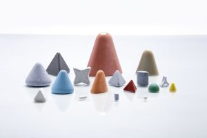

Media geometry and composition, compounds, machine type, process parameters and the characteristics of the component all influence the eventual quality of the finishing process.
These figures underline why media selection cannot be treated as a simple purchasing decision. Shape, size and material all affect how the media reaches the component, how aggressively it acts and how effectively it produces the required result without compromising the part.
The DMM project also illustrates a broader truth about mass finishing: the machine is only one part of the process.
Media geometry and composition, compounds, machine type, process parameters and the characteristics of the component all influence the eventual outcome. Rösler’s strength is its ability to consider those variables together, combining equipment knowledge with extensive in-house consumables expertise and practical application support.
