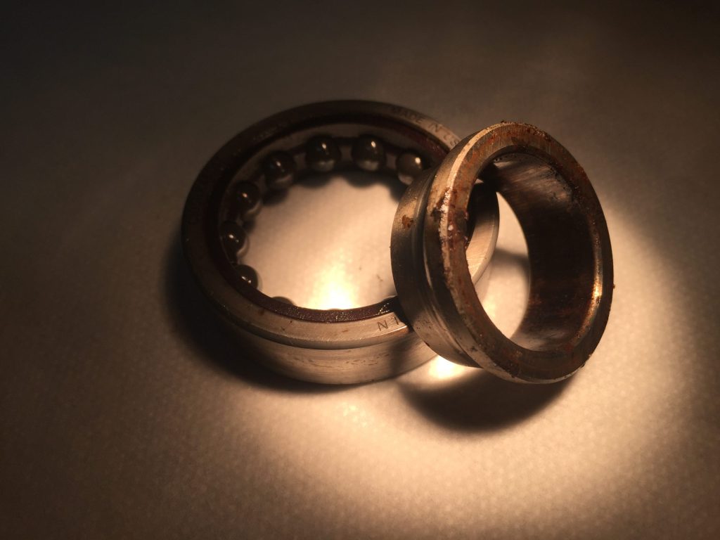

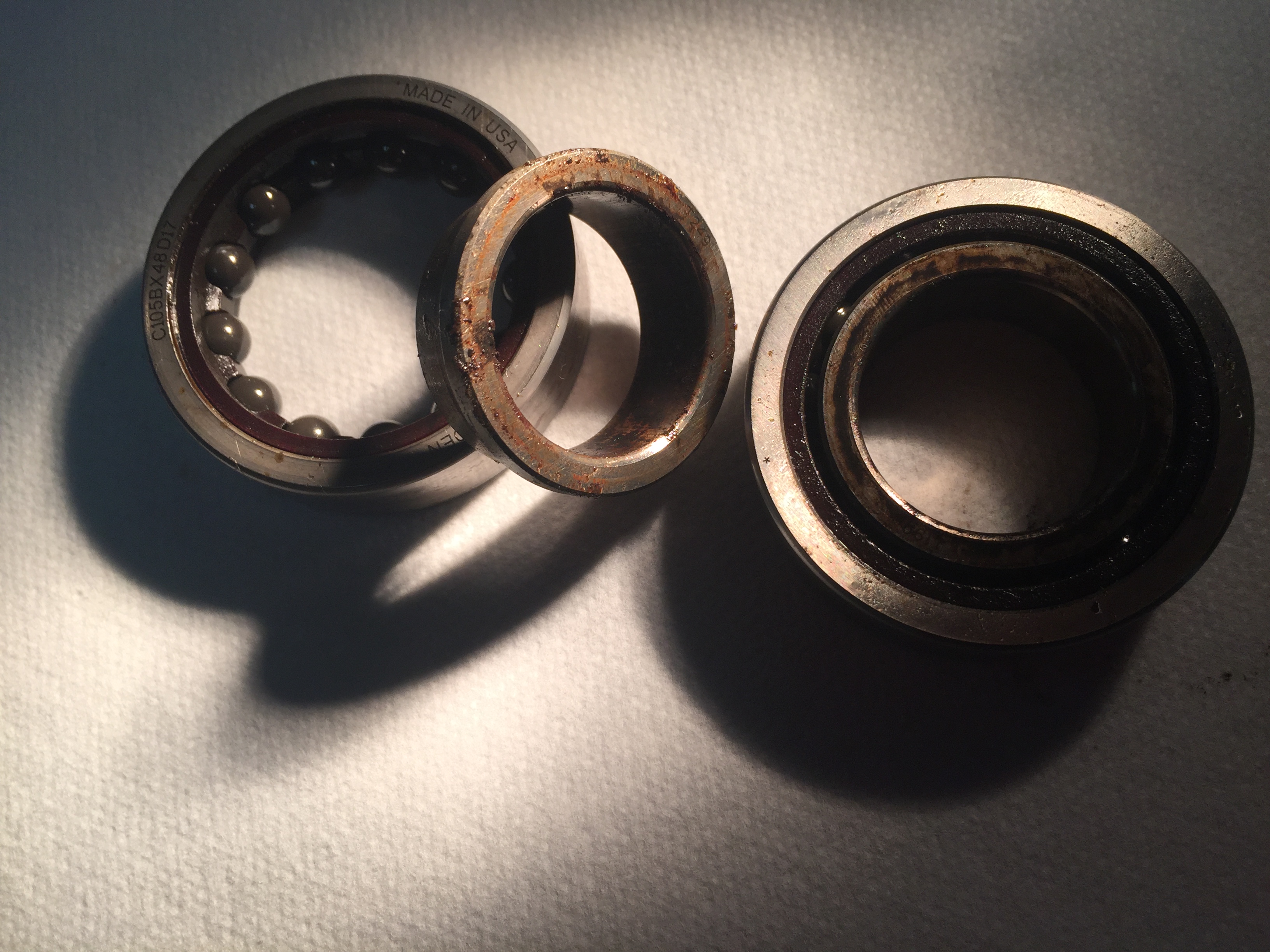

Contaminated/failed bearings as a result on non dry-contaminated air supply. Photo courtesy of GTI Spindle Technology
It is an industry fact that 80 percent of all spindles fail due to contamination. Often times the assumption is made that it is contamination caused by ingress from an external source, i.e. grinding swarf or part coolant. You would be surprised to learn that you (the end user) are in many cases slowly but surely killing your own spindle, which is your production lifeline.
