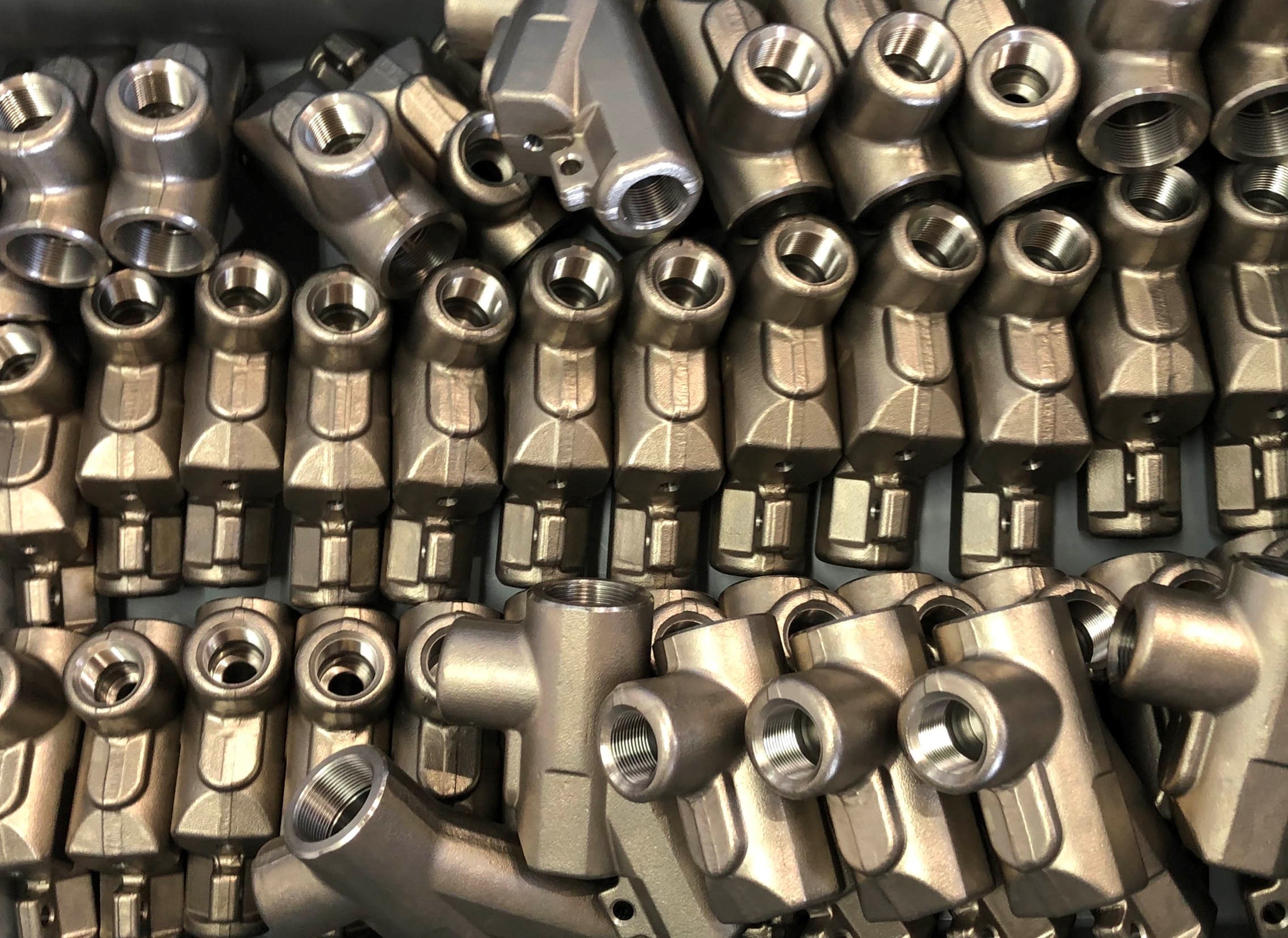

Valve bodies made of forged stainless steel for professional high-pressure cleaners, for example for overnight cleaning work in meat factories.

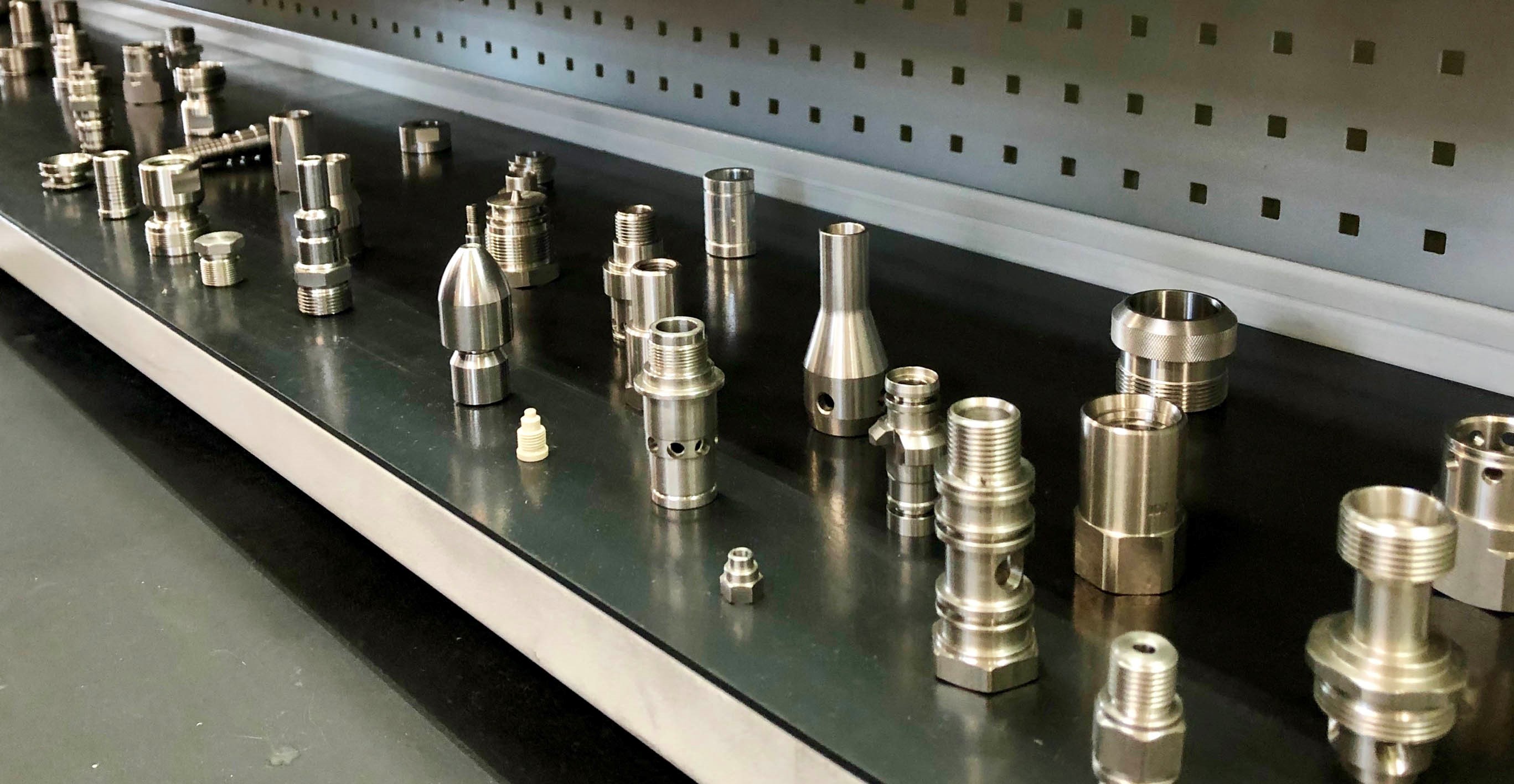

What does this mean in essence? Ultimately, turning and metalcutting are all about productivity, for example in the production of injectors. At Suttner, injectors are the core product – you could almost say a “blockbuster.” Injectors consist of three basic bodies containing a total of about 30 components. For example, they include an internal Venturi nozzle and spindle as well as connections with non-return valves. The base bodies also have connection bores and threads, valve seats, oblong holes and overflows. It is a special challenge for machines and tools to produce them since the internal radii are located at places that are difficult to access. The products are required to be resistant to chemicals and this defines the material – in some cases forged stainless steel which is difficult to machine. Many components are FDA compliant so that the high-pressure cleaners can be used in the food industry, such as in meat factories, although they do not come into direct contact with foodstuffs.

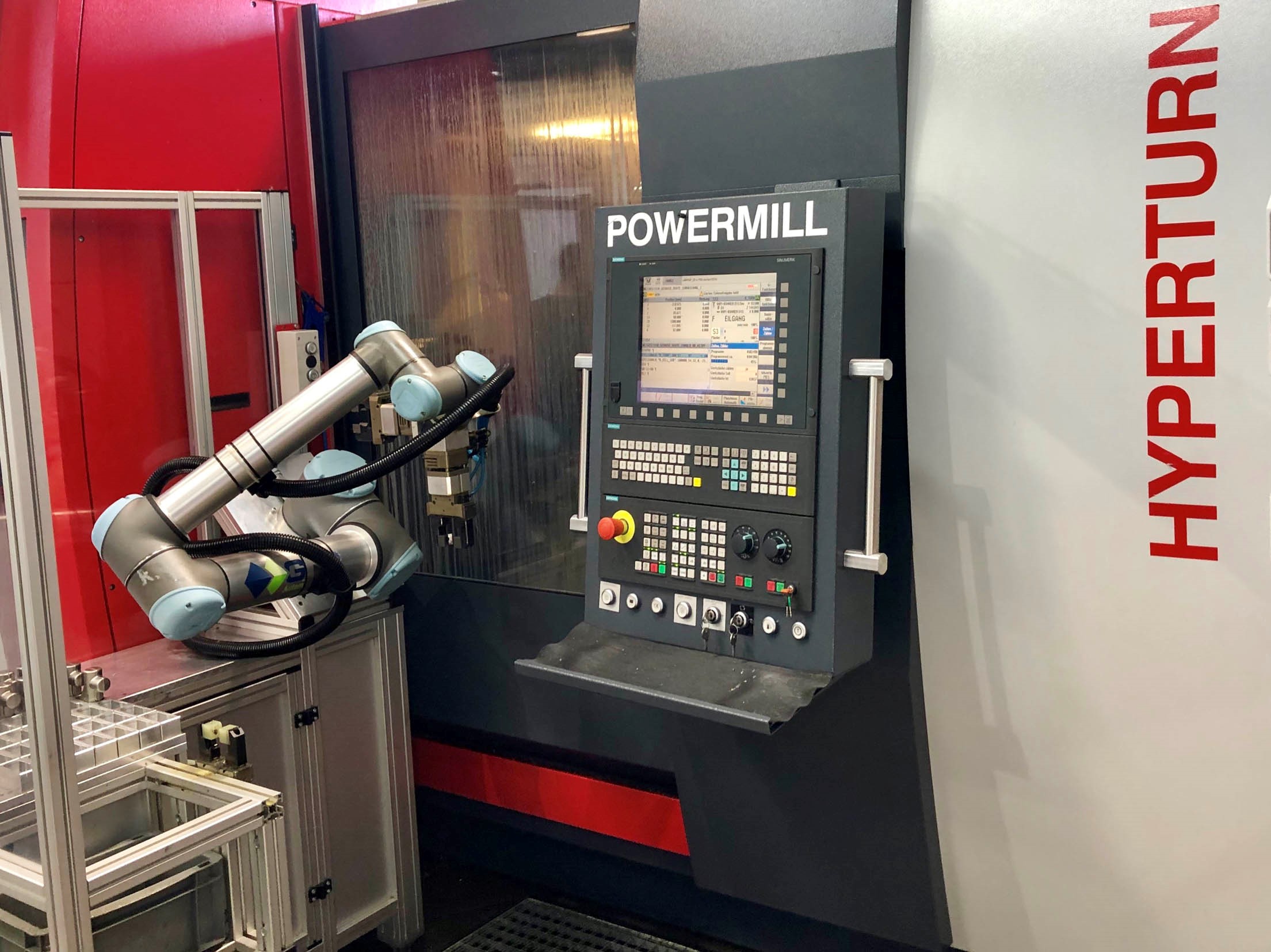

In the past, the valve body was produced on four machines using just as many clamps. Today, a machining center comprising main and counter spindles produces the workpiece in two clamps in a fraction of the time. The entire process is fully automated thanks to the loading robot.
Top priority given to process automation

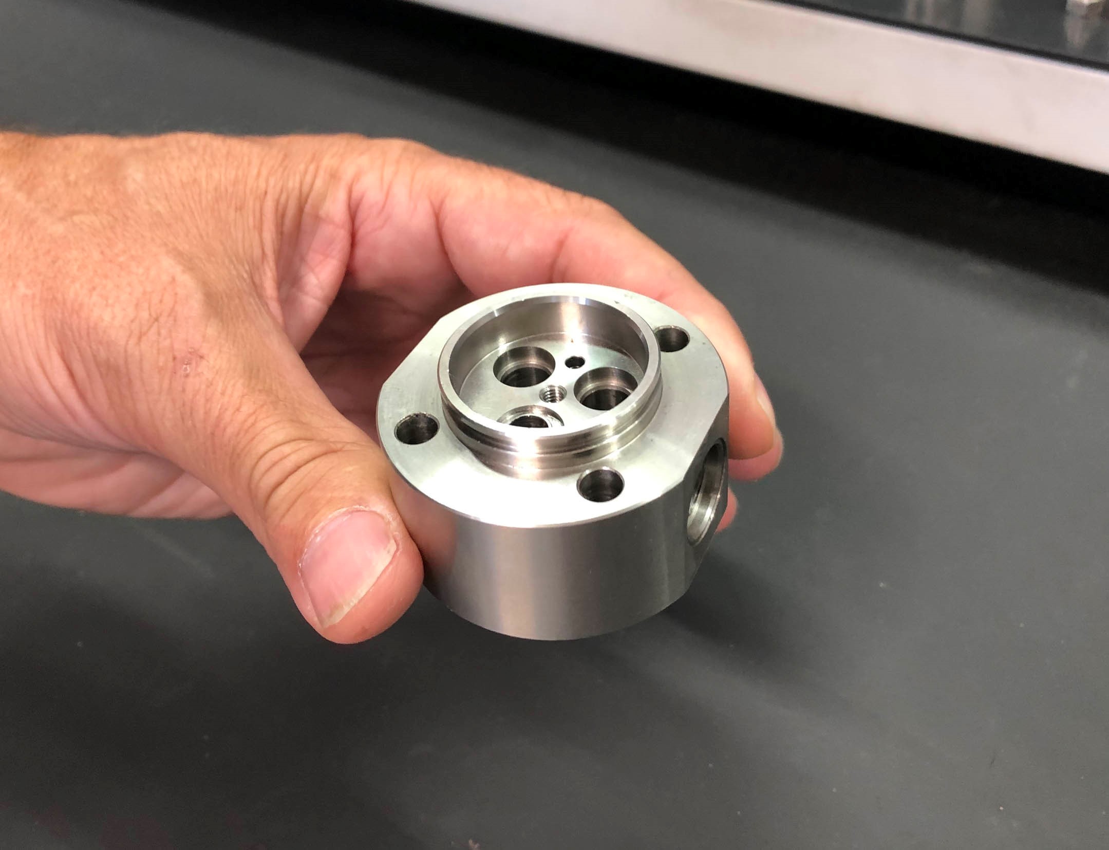

The results are convincing. The machining time for the middle section of an injector now takes under six minutes whereas before it needed 11 minutes. “And with a new holder we even managed to reduce this time to four and a half minutes,” mentions Bach, not without a certain pride. The result was even more drastic for the valve body made of forged stainless steel. The part is located in the handles of high-pressure guns. In the past, they were produced on four machines using just as many clamps. Today, multitask machines produce the workpieces in two clamps in a fraction of the time. The machines comprise a main spindle, counter spindle, milling spindle and tool turret. The entire process is now fully automated since a loading robot assumes the task of fitting, re-clamping from the first to the second clamp and removal.
