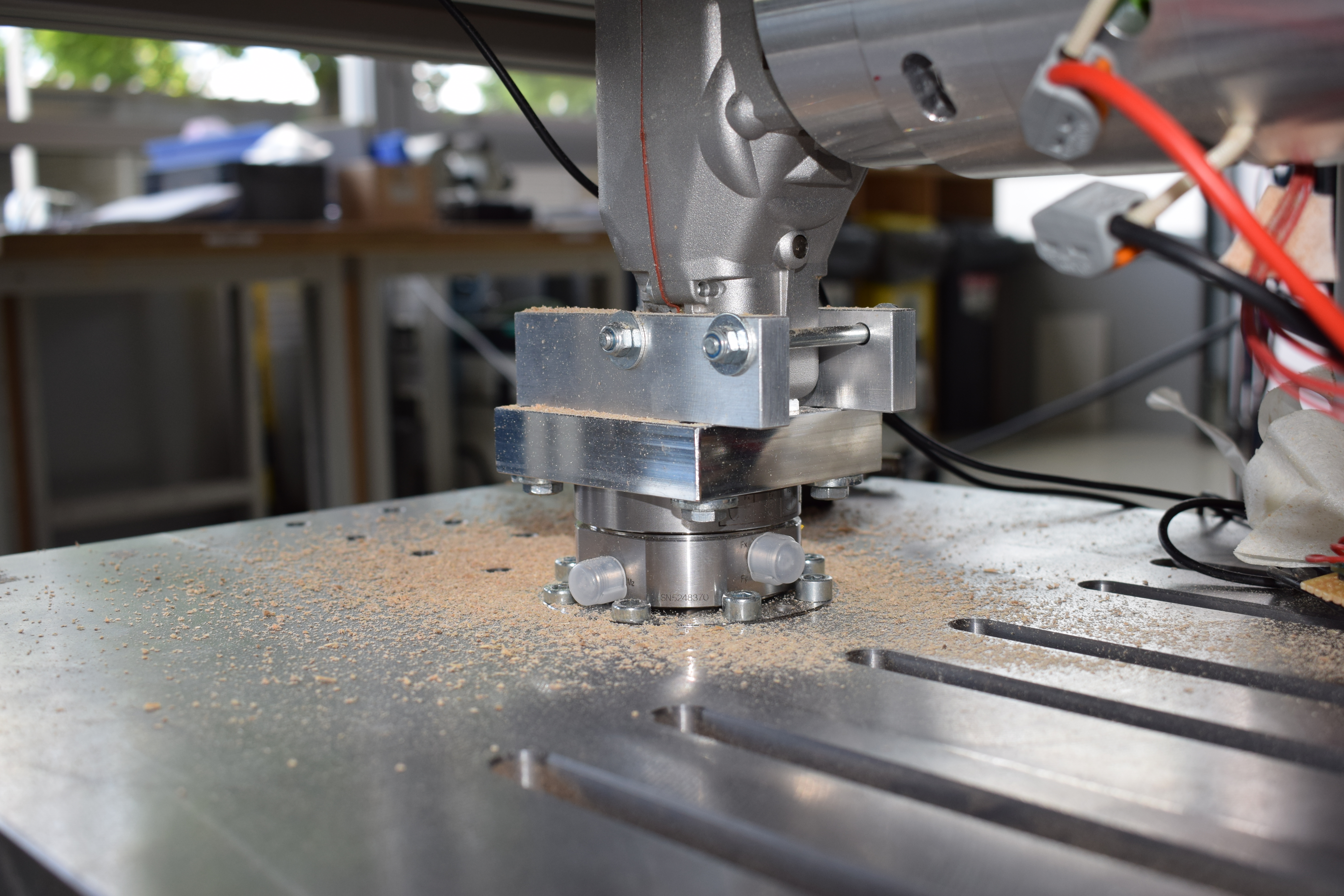

Precise measurements of dynamic forces and moments acting on jigsaws – with the six-component force/moment sensor from Kistler. The saw is mounted upside-down.

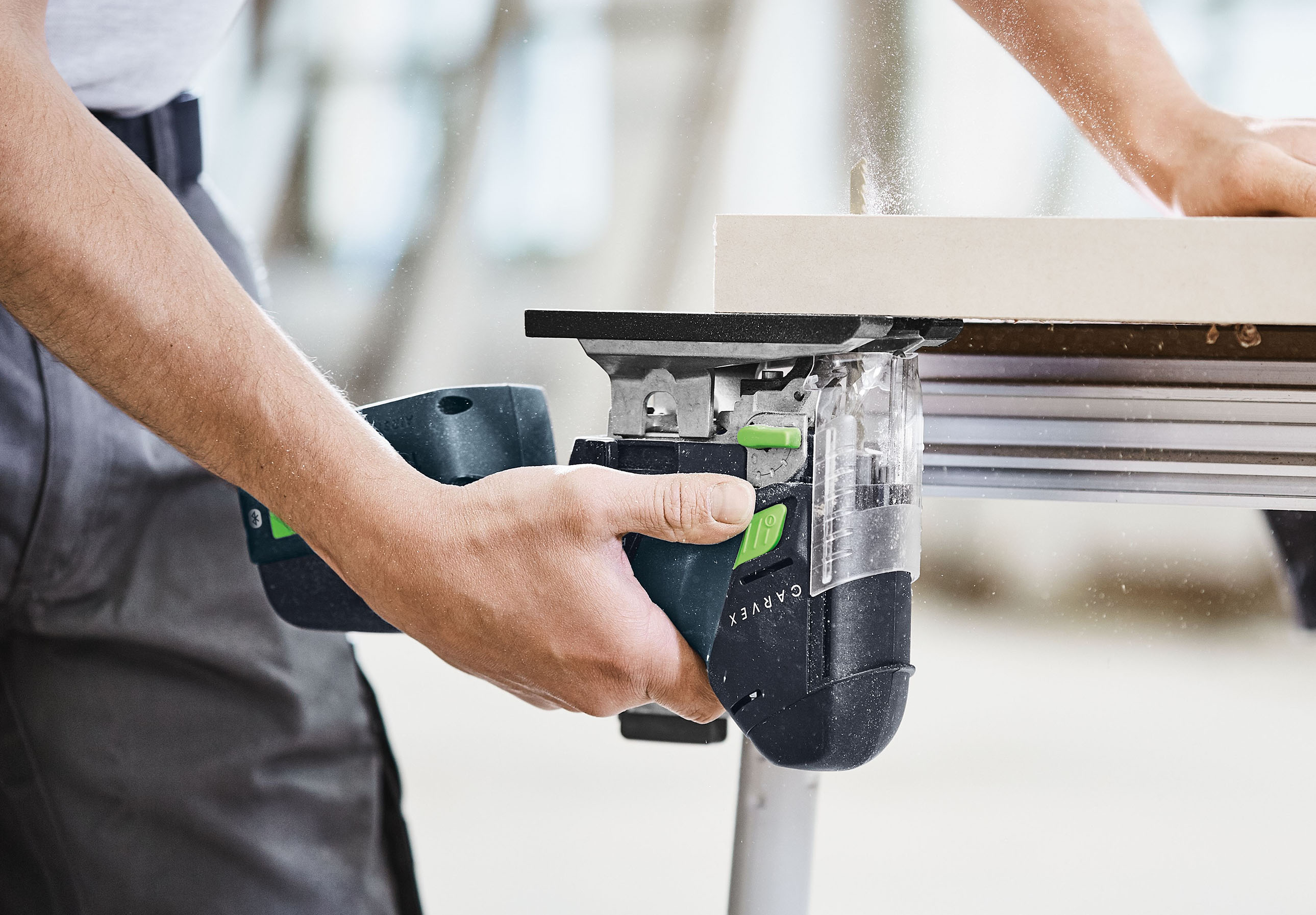

Professionals prefer to saw from below: that gives them optimal visibility of the saw blade and the scribe line.
Trend: smaller, lighter, better ergonomics and more mobility
The saw blade, the pendulum stroke and the automatic speed control of a Festool jigsaw can be set precisely to match the workpiece material – so every cut is a perfect success, even when tight curves or extreme angles are involved. Fritsch continues: “Professionals prefer to saw from below, because that gives them optimal visibility of the saw blade and the scribe line. And to cope with confined spaces, the tool should be as small and lightweight as possible, with a powerful accumulator battery for maximum staying power and mobility.”

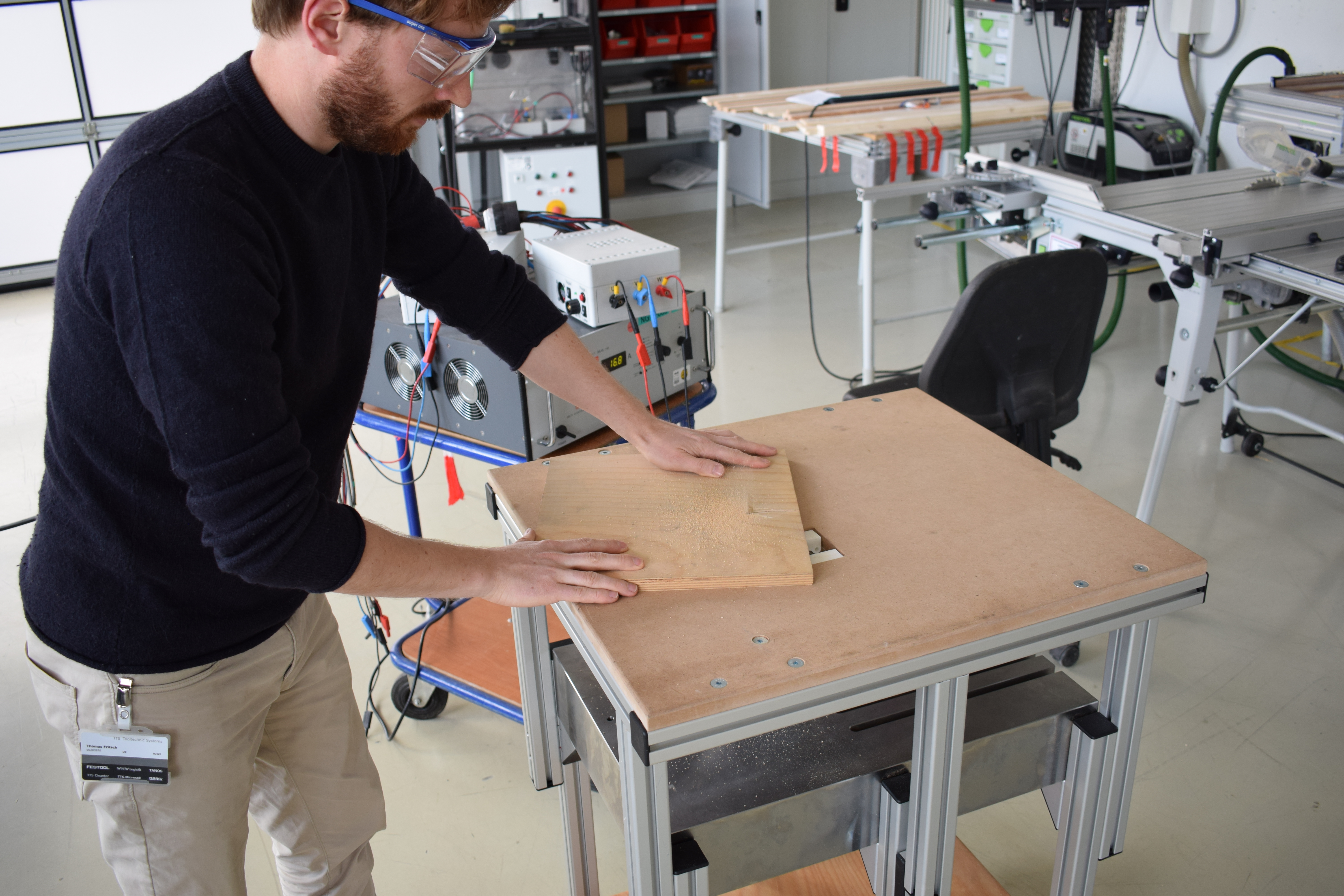

Festool’s research and development facility is located at the company’s headquarters in Wendlingen near Stuttgart, Germany. This is where Festool develops and tests the latest generation of its pendulum jigsaws. A test rig for new saws has been set up in the company’s jig construction department. The six-component force/moment sensor from Kistler (9306A31) is deployed here to measure the forces and all the moments acting on the saw blade – along all three spatial axes. Fritsch is delighted with the results: “Kistler is in a class of its own in the world of measurement technology. Back in my student days, I was already working with piezoelectric sensors from Kistler. Thanks to the know-how and advice provided by the Kistler service team, it only took us two months to set up our test rig.”
Festool tests and validates its own jigsaws and saw blades, as well as competitors’ products. This involves mounting each jigsaw upside-down on the sensor, which is fastened onto a heavy steel plate to ensure that it remains fixed on one side. Thanks to its compact design, it is easy to install the piezoelectric six-component force/moment sensor in the test rig, where it measures the three dynamic forces that are perpendicular to each other in the directions of compression and tension, as well as the torsional and bending moments.
Data acquisition is handled by the LabAmp 5167A multiple-channel charge amplifier from Kistler. Integrated data acquisition and fully digital signal conditioning are features that simplify the measuring chain, enabling direct integration into customers’ own system environments.
Festool hones competitive edge with measurement technology from Kistler image
The test rig serves Festool to evaluate the performance capability of new jigsaws and saw blades.
