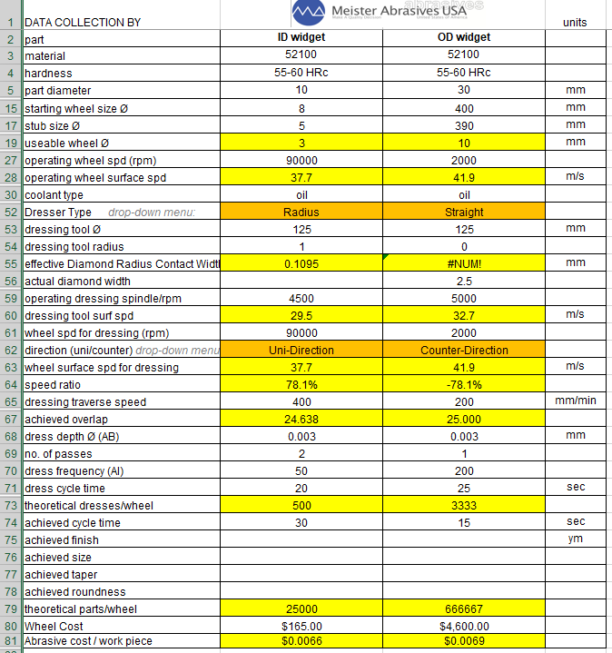

However, after the low-hanging fruit is picked, a granular approach to troubleshooting is required to fix a specific problem. To find the proverbial needle in a haystack, Tom Cappadona, Midwest sales/applications engineer for Meister Abrasives, developed a spreadsheet with more than 80 variables that can be altered in numerous ways to fine-tune a grinding process.
Tom Cappadona developed a spreadsheet with more than 80 variables that can be altered in numerous ways to fine-tune a grinding process.
An abbreviated snapshot of the process documentation/improvement spreadsheet Tom Cappadona, Midwest sales/applications engineer for Meister Abrasives, developed.
“The monster was born,” Cappadona said, after he visited large factories in which multiple grinders were running the same processes but the grinding parameters varied significantly. That realization led to making calculations for multiple parameters, such as the surface speed of the grinding wheel, surface speed of the dresser and traverse speed when dressing, as well as the speed ratio of the dresser and the grinding wheel.
“Then there is the overlap ratio,” he said. As the grinding wheel rotates and the dresser moves across the grinding wheel, that ratio is the number of wheel revolutions from the time the leading edge of the dresser enters a point on the wheel to the time the trailing edge of the dresser exits the same point on the wheel.

To cut rather than push material, he recommends more aggressive dressing parameters that crush some of the bond from the grit edges. An effective starting point is unidirectional dressing at a speed ratio of 80 percent. Another option is to increase the dress traverse speed.
Dressing also can impact taper formation. Dressing a bore wheel with a counterdirectional dresser, for instance, often shears the grains and creates a dull wheel, he said. A unidirectional dresser, however, breaks the bond from sharp edges of the microfracturing grits and “allows cutting to happen right off the bat. That gives a much freer-cutting wheel and will usually get rid of any taper. There are all kinds of little tricks that you can use to modify the results and get what you’re looking for.”
