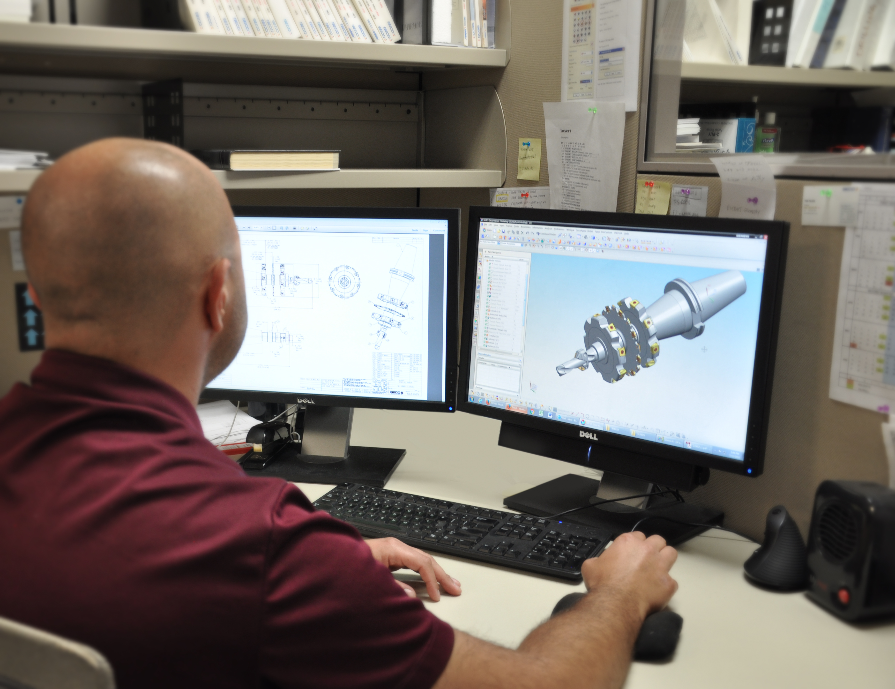

The initial evaluation phase identifies the combination of tooling, fixturing, machines and cycle times that will result in the most cost-effective and efficient process. After optimization experts collect the information, they produce a proposal that covers everything from the necessary equipment to the cutting data, as well as any required custom tools.
By applying their own know-how to the customer-supplied data, the Engineered Solutions team can evaluate cost per unit, projected cycle times, machine capacity and other factors to create a documented process with recommended cutting data. The Custom Products department fabricates and assembles any products required by the process at Seco’s Troy, Michigan-based production facility. The team then assembles, balances and certifies the quality with a final inspection document prior to shipping so that everything arrives ready to run off on a customer’s machine.
